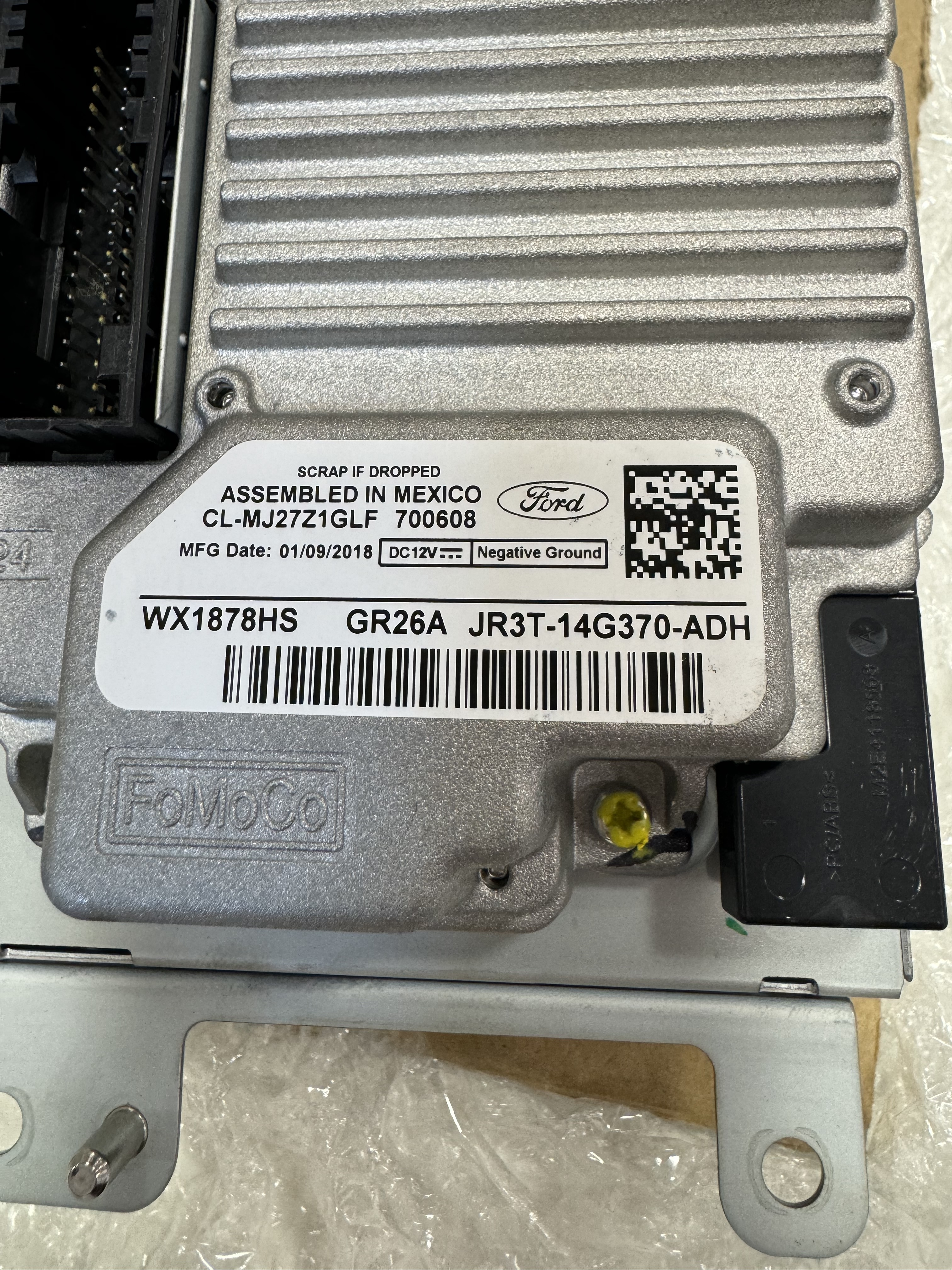

No, that one was APIM only, no screen.
Had to find another one with screen.
It’s also a J though.
Thanks.
That’s the model but the APIM will show a different model.
What are you going to do?, that looks a genuine part based on the sticker looks alone, and it’s from 2018 like the screen. Since it’s a J series one, it’s newer than the you are you are currently using (which is H, right?).
Yeah that was a full genuine part. Came from a 2018 Mustang.
I returned it though. Just borrowed it for a couple of hours to fix mine. I’m keeping the fake module. There’s not much I can do with it. It’s working fine now at least.
It’s a H series yes.
Smart move.
From now on, I would refrain from reformatting it again… not because of the APIM itself, but the MY20 screen you have… You can however look into FMODS’ universal reformat package, which can handle MY20 hardware… That way, you could reformat the unit should you need to…
