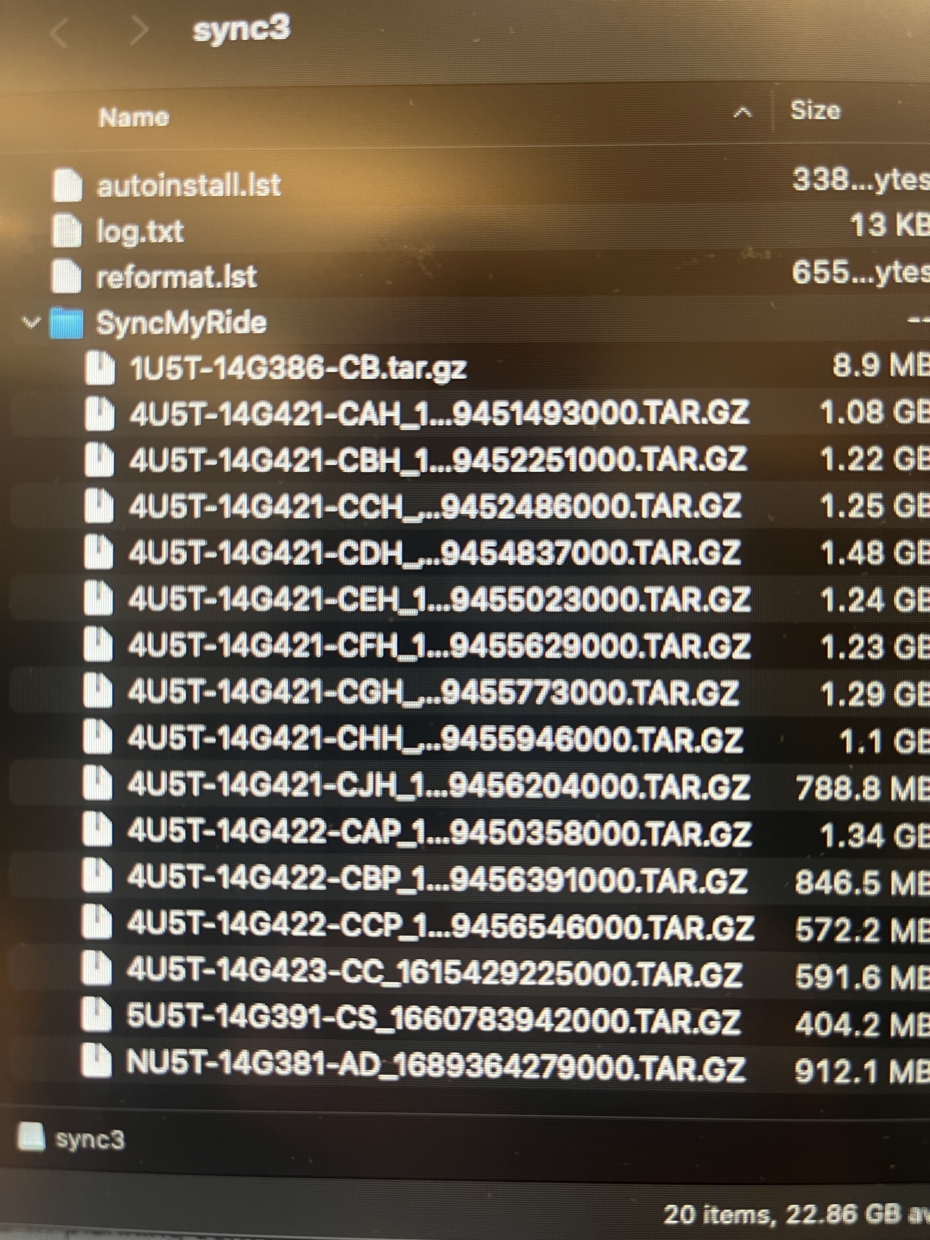

Black screen while trying to update
LST_ERR05 – Error is LST_PKG_FILE_NOT_FOUND
Can’t find the files on the USB…
What did I do wrong to get this error
The files are in the wrong location or not there. Likely the PU5T file…
Can you spot was is wrong in the photo below
The PU5T- file is missing. Look in the autoinstall file…You could leave it out but it cleans out the cache.
So I’m a little confused… you say look inside the autoinstall file? What does that mean look inside?
Can you explain what I did wrong because I’ve never seen that PU5 file anywhere nor where to download it from.
Item2 = REFORMAT TOOL - 1u5t-14g386-cb.tar.gz
I was finally able to get to this and it only took a minute. I downloaded the missing file, thank you, and tried the process again. I’m now on 3.4. Thank you so much I could not have done that without your support. Amazing.
