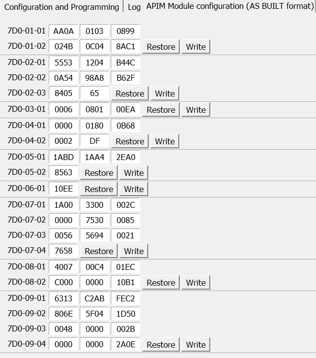

Here’s the AS BUILT from Forscan:

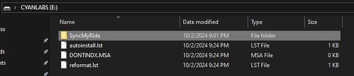

Assuming you didn’t re-format the USB you used for upgrading, please:
connect the USB to your computer
share a screenshot of the root’s content for the USB
share a screenshot of the SyncMyRide folder’s content
Carch
(Carch)
4 October 2024 01:11
10

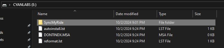

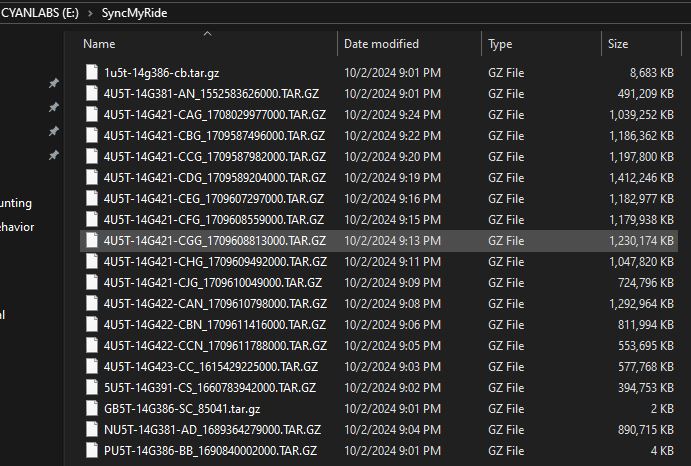

Here’s the screenshots. Weirdly, the filenames in the SyncMyRide don’t match what I have in the Syn3 Update log and I don’t have a log from this particular time yesterday. I’ve included a screenshot of the Syn3 Updater logs. The top 4 entries from 7:10pm to 7:38pm are RW Cleaner creation logs where I was battling the issue with not enough room in the APIM memory to run the cleaner but I was thinking it might have been an issue with the Cleaner file itself. I finally got it to run on the 4th attempt and then created the interrogator file an hour later at 8:31 pm.
SaNdMaN
(SaNdMaN)
4 October 2024 01:16
11
Thank you.
Now, THAT makes sense.
That’s a reformat USB, which would cause exactly what you saw while upgrading and the aftermath. Now we can say that:
Yep, it’s dead.
You can try this → GitHub - bigunclemax/sync3flash: Ford Sync 3 reformat flash tool , but it requires knowledge and equipment.
There’s not much to do, really…

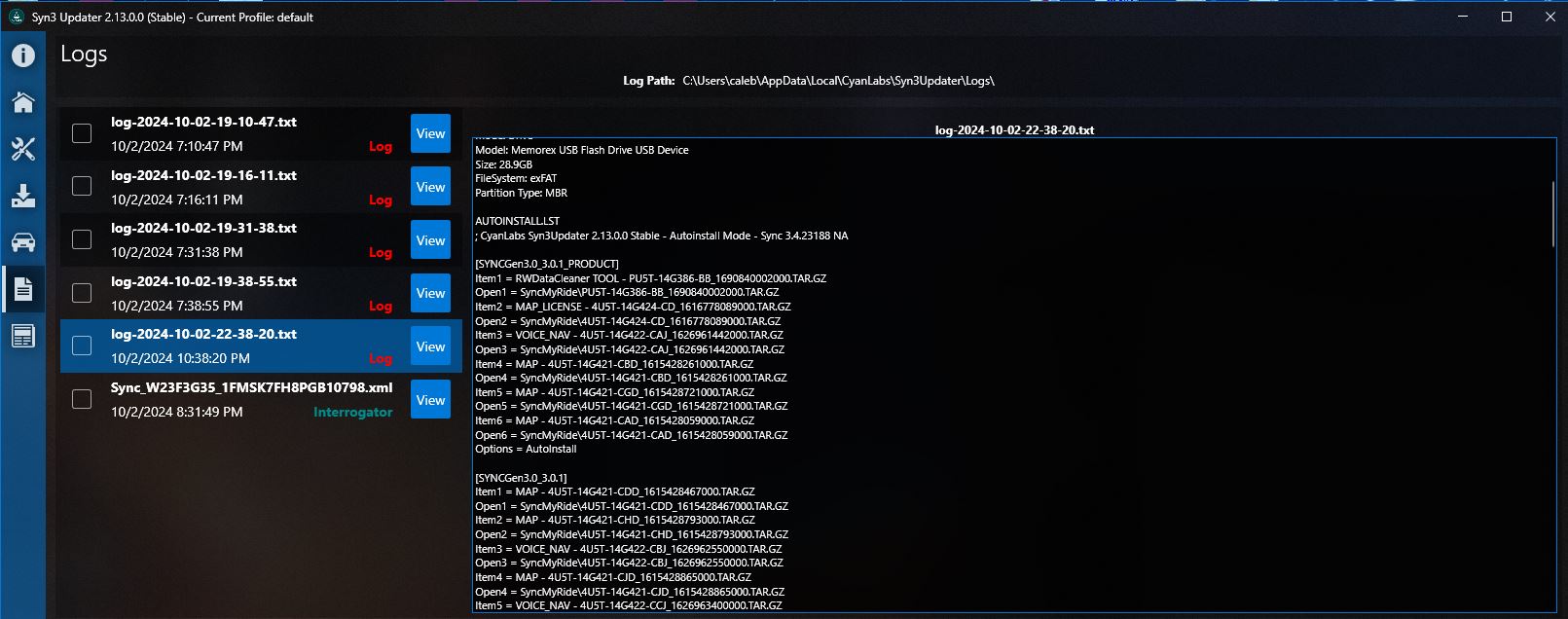

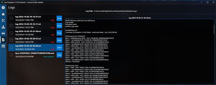

One quick thing, before I answer to that… can you please open a terminal (CMD) on the computer you used for creating the USB and executing “hostname”?, that will give your computer’s “name” back… What is it?.
SaNdMaN
(SaNdMaN)
4 October 2024 01:37
15
Great, thanks, that clarifies things.
I will now answer your questions:
The USB you sent the screenshots for, the one that you actually ran against the unit, could not have been made if MY20 protection was active. It was created with MY20 disabled, and it was a different USB device from the log that you showed.
What’s really odd about all of this is that there was a log submission, but only one and the one you are missing from that list.
Did you work on this little project alone?, maybe multiple people tried stuff and one generated the wrong USB… It’s really hard to know…
But what’s clear is that from what I’ve seen, someone generated a reformat USB with MY20 protection disabled. And again, I’m talking about a different USB device from another brand, not the one that shows in the log you sent before…
Do you share your computer with someone else?.
