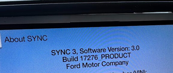

Current radio is sync 3 v3 build 17276

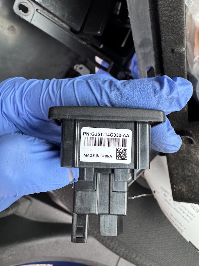

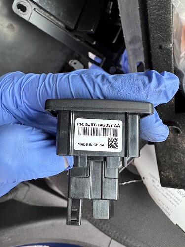

I’ve posted a photo of a cable and hub that are supposed to be the “right” part numbers?
(I just tested and android auto works)
CP hub part number…cable is fine.
HC3Z-19A387- *
HC3Z-19A387-B (BLUE BACKLIGHTING) Ford (Wide 2 USB-A Port)
HC3Z-19A387-D (BLUE BACKLIGHTING) Ford (Wide 2 USB-A Port)
HC3Z-19A387-E (BLUE BACKLIGHTING) Ford (Wide 2 USB-A Port)
HC3Z-19A387-F (BLUE BACKLIGHTING) Ford (Wide 2 USB-A Port)
HC3Z-19A387-G (BLUE BACKLIGHTING) Ford (Wide 2 USB-A Port)
Interchange Part Number:
HC3T-14F014-BC, HC3T-14F014-BD
2016-2019 Ford Police Interceptor Sedan (Taurus)
2016-2018 Ford Special Service Police Sedan
2016-2019 Ford Taurus Limited, SE, SEL, SHO
2019-2020 Ford Ranger Lariat, XLT
2017-2018 Ford C-Max Hybrid SE, Hybrid Titanium
2017-2018 Ford C-Max Energi SE, Energi Titanium, Hybrid SE, Hybrid Titanium
2015-2019 Ford Escape
2016-2022 Ford Edge
2016-2019 Ford Fiesta
2016-2019 Ford Flex
Media Hub, CarPlay Compatible - 2015-2020 Ford/Lincoln - SYNC 3 - Ford / Information - CyanLabs Official Community

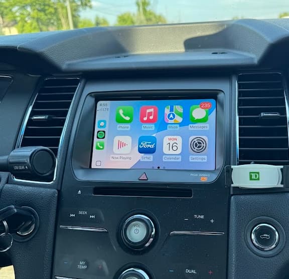

Hi just some updates, ordered a hub off amazon and amazingly they managed to lose it. I was lucky enough to find one in the junkyard and carplay is working now!
I appreciate your help! F150Chief

I was thinking of updating the firmware but it’s on sync build 17276 which is apparently buggy and I’m understandably nervous about bricking a 2nd apim.

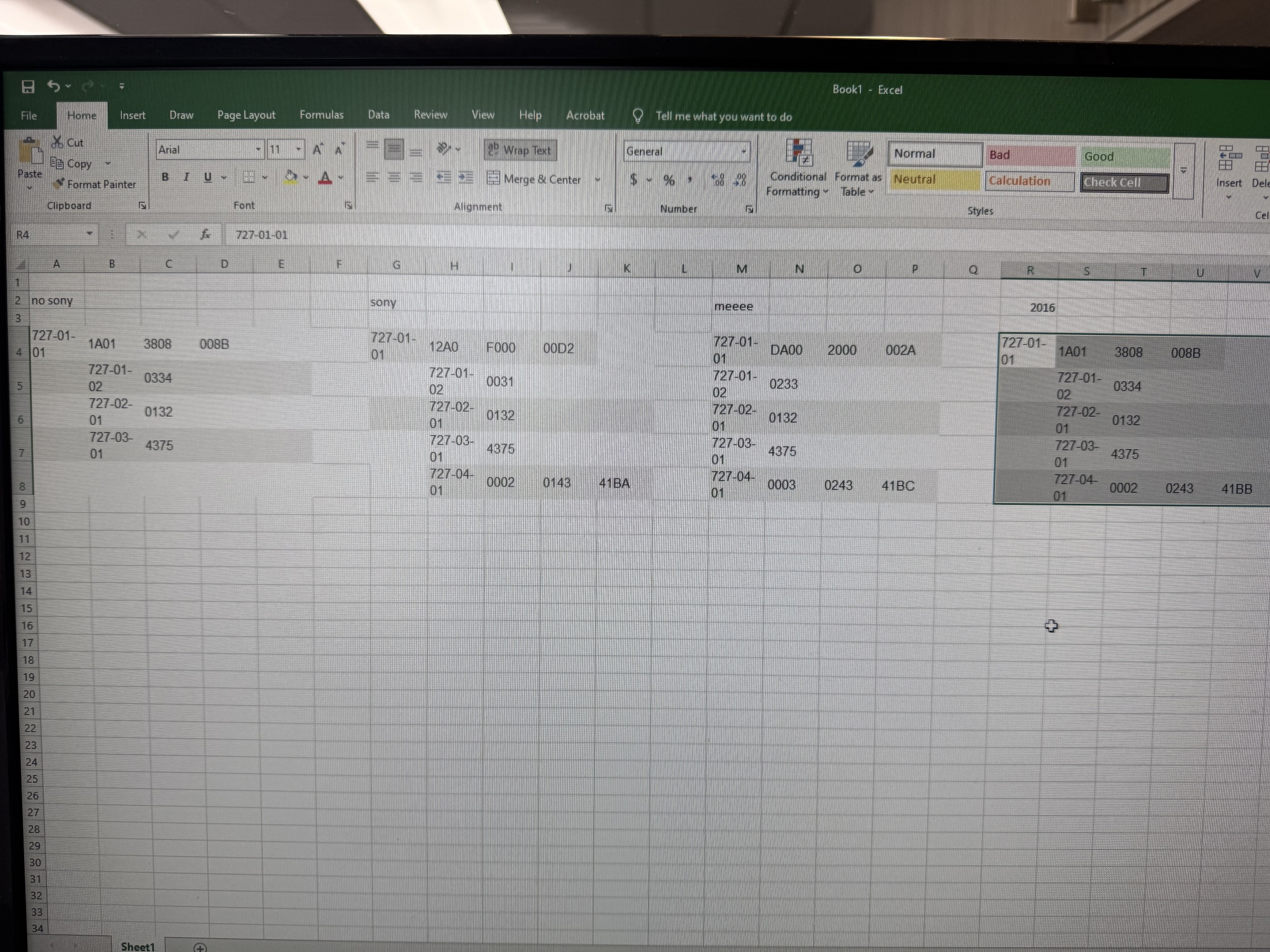

APIM AsBuilt
DE00: A221010306020300040A
DE01: 434101014002000000000005
DE02: 0000000200
DE03: 01000500050001
DE04: 1B581B8F2C1A
DE05: 80
DE06: 08003300000000157C00005656800072
You can update directly to 3.0.20204 or 23219.

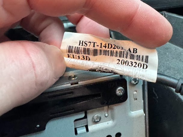

I saw for the fusions it was an ACM issue but the asbuilts are so different between my 15 ACM and the 18 the apim came from.
Wondering will I need to swap the acm too?
EDIT ignore the above, for anybody doing a sync 1 to 3 upgrade for the older cars like a 15 explorer or Taurus, it seems like the first digit of the ACM has to be changed from D to a 1. I’m surprised nobody else has had this issue as I scoured the Internet, but didn’t really find it for at least those platform cars!
Yes, it changes the communication format for the later generation Sync platforms. LIN vs CAN.
