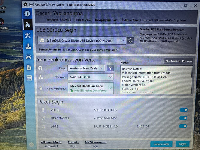

Can I update it?
Been doing some reading throughout the community and would like your advice on the best way to perform this update.
(The part failed, resulting in a black screen. I ordered your new part from the EU (Poland). I did the region coding myself. It works very well now. FORScan DTC Error Code Not Found(It doesn’t come out).I used Translate, sorry about that.As the founder of the forum, I would like to thank you for sharing your knowledge.
SYNC Region: ROW
Old SYNC Version: 3.4.20136
I didn’t want to try it without getting information from you first.

You have a very early model MY20+ APIM, which COULD be reformatted, but I advise not to.
APIM Model: LU5T-14G371-GMF
APIM ECU Core Assembly Number: GU5T-14G380-FE
If you are running Sync 3.4.20136 now, you should just use the autoinstall method to upgrade to the latest Sync version. You can use the Syn3 Updater to do this.
Upgrade all of the files, not just the Sync app.
Thank you Chef.
