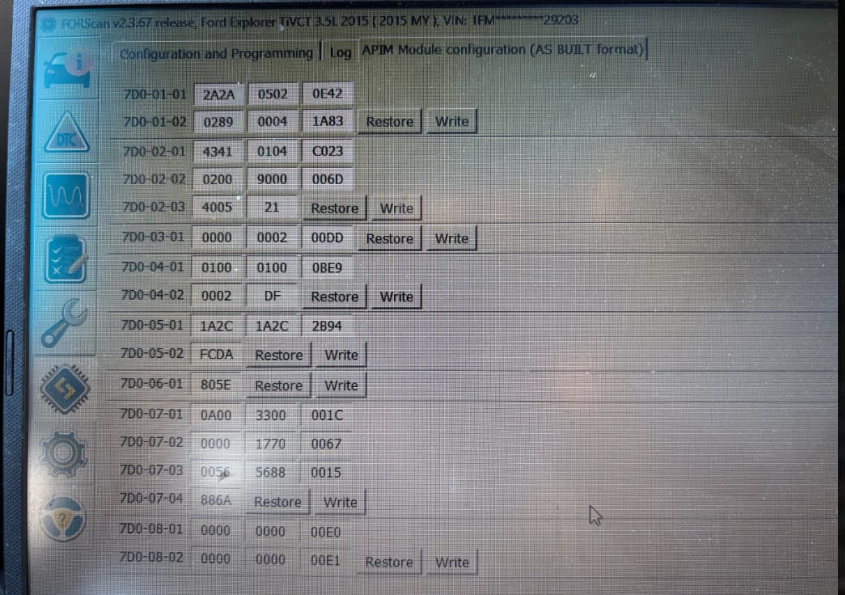

CGEA 1.3 APIM is not compatible with a CGEA 1.2 vehicle for the climate controls.
So what can I do here? Change to a different APIM? And how will I know it’s the right one before buying one from a wreck yard.
There is no such a thing as a CGEA 1.2 or 1.3 APIM. They will all work and it just comes down to AB settings.
The setting I have given you is correct and your APIM will work fine in a 2015. What F150 ment to say was that the CGEA 1.3 SETTING will not work in a CGEA 1.2 Vehicle.
I see. Thanks for the clarification. So in order to fix the problems that I am having at the moment do I need to change more codes? How do I go from here please suggest.
If it is just the seats and Heated steeringwheel than yes it’s just AB changes.
Okay, what other codes do I need changed?
Is it just these 2 things? If so thats an easy fix. Do you have AC seats also? Have you tried to troubleshoot these two already?
Yes, I have AC seats and heated seats. Unfortunately I do not know how to proceed from here in terms of troubleshoot. Any help is greatly appreciated here.
Edit: yes just those two things.
Ok, i have some work to do and than I will get you the settings you need for both.
Greatly appreciate it. Thank you!
Change this value from an β€œ8” to an β€œE”
7D0-01-01: xxxx-xxxx-x*xx
I belive that should be the last thing to solve all your issues.
That did the trick for the seats and steering wheel.

Your climate AB all look fine to me. I would suspect maybe a bad Actuator.
so nothing related to codes or programming, correct?
Not that I can see. Your settings all look good for Climate Control based on the pic you posted.
