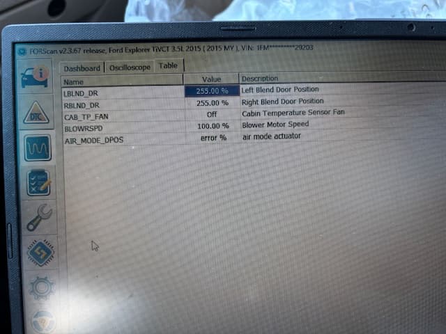

The mechanic said there’s nothing wrong with the HVAC. any idea if this might be something related to any code?
Hard to say what it is than. If the mechanic said there is nothing wrong so thats no help. Heck it could be a thermostat stuck to a blend door actuator stuck.
You have a bad acuator or fault there…
