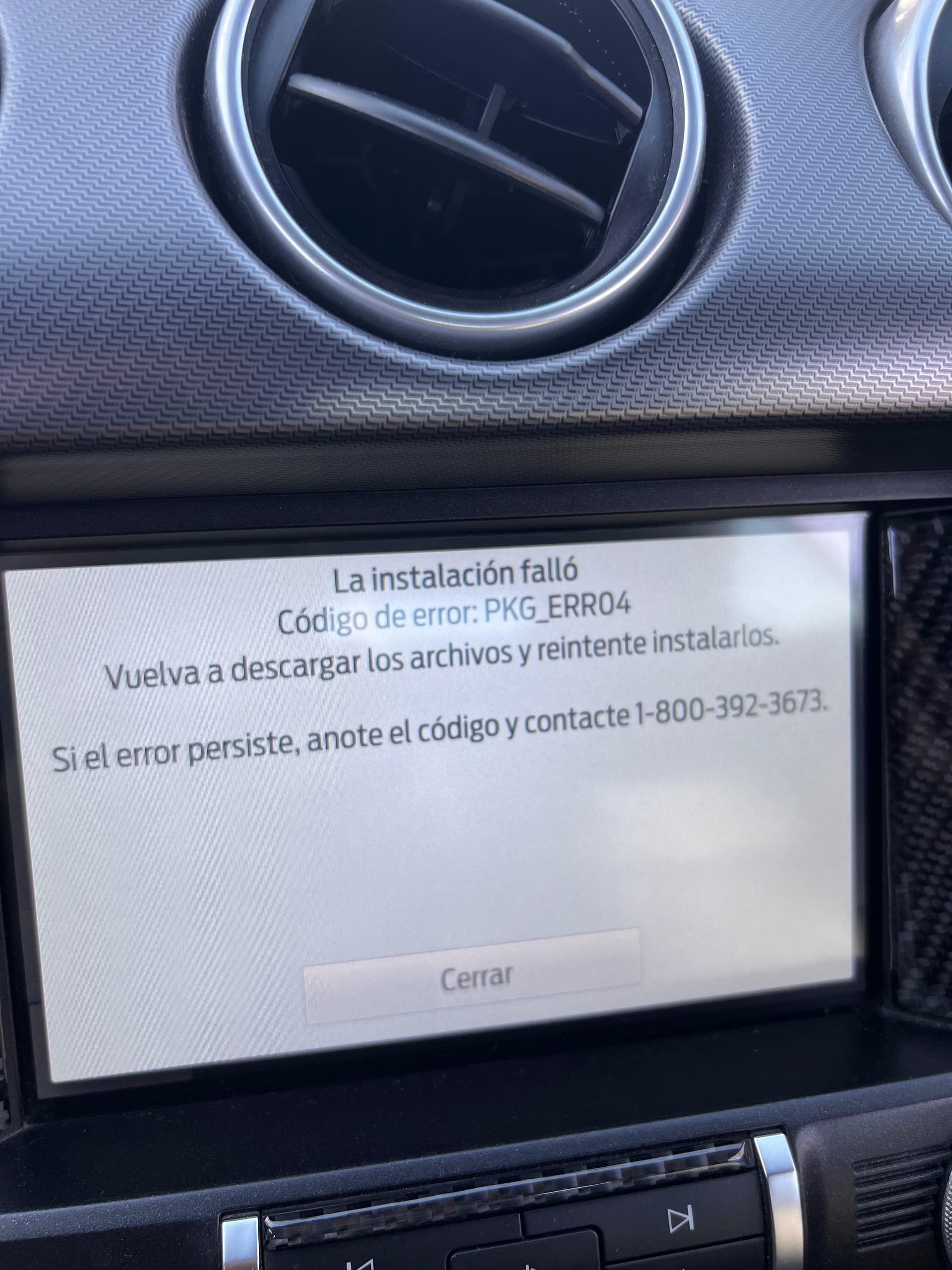

I tried updating my 2018 Mustang with Sync 3 originally from the US to Europe, using both the manual and automatic methods. Both gave me the same error. Now I don’t know how to fix it 4U5T-14G42Z-BAM_1748464396000. TAR.GZ

A NA NAV APIM is a 32Gb unit, one for the EU is a 64Gb unit due to the extra map data and languages.
You’ll have to do this as a non-NAV APIM and then use the cut down map generator to load in the maps that you need.
It worked perfectly for me, I was able to update to 3.4 without maps, now when installing the reduced maps I get this error, has this happened to anyone?
