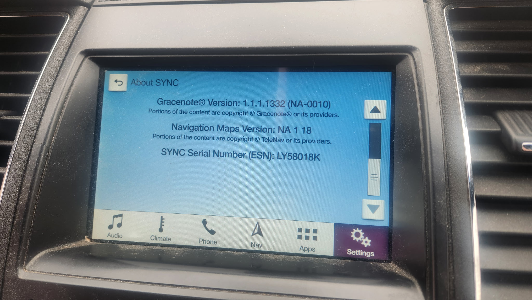

Factory nav on non nav apim nav worked updated nav dosent work
I have a 2018 Ford Taurus Limited with Sync 3 8 inch. My clock would reset to 12:00 everytime i started my car then my bluetooth would reset. Tried doing update through wifi never worked downloaded from Ford said incompatable with my vehicle. Downladed the updater read everything followed installed update then navigation didnt work. Ive had the car 4 years always had factory nav but when i called Sync today they say my car wasnt manufactured with factory nav. I want my nav back becasue it affects my clock also. I dont know what information you need i have the old version it ran and the new one. I can get the interrogator if needed. I dont know if i need Forscan to change it after update apperently my car isnt supposed to be past Build 3.0 23219. I dont know if previous owner changhed apim or anything the vin number matches the apim it tells me from interrogator matches the one on the sticker(yes i pulled the radio to check).

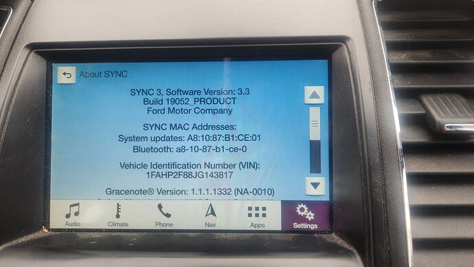

Install Type: Unknown
Old SYNC Version: 3.3.19052
No error messages appear
Version: 3.4.23188

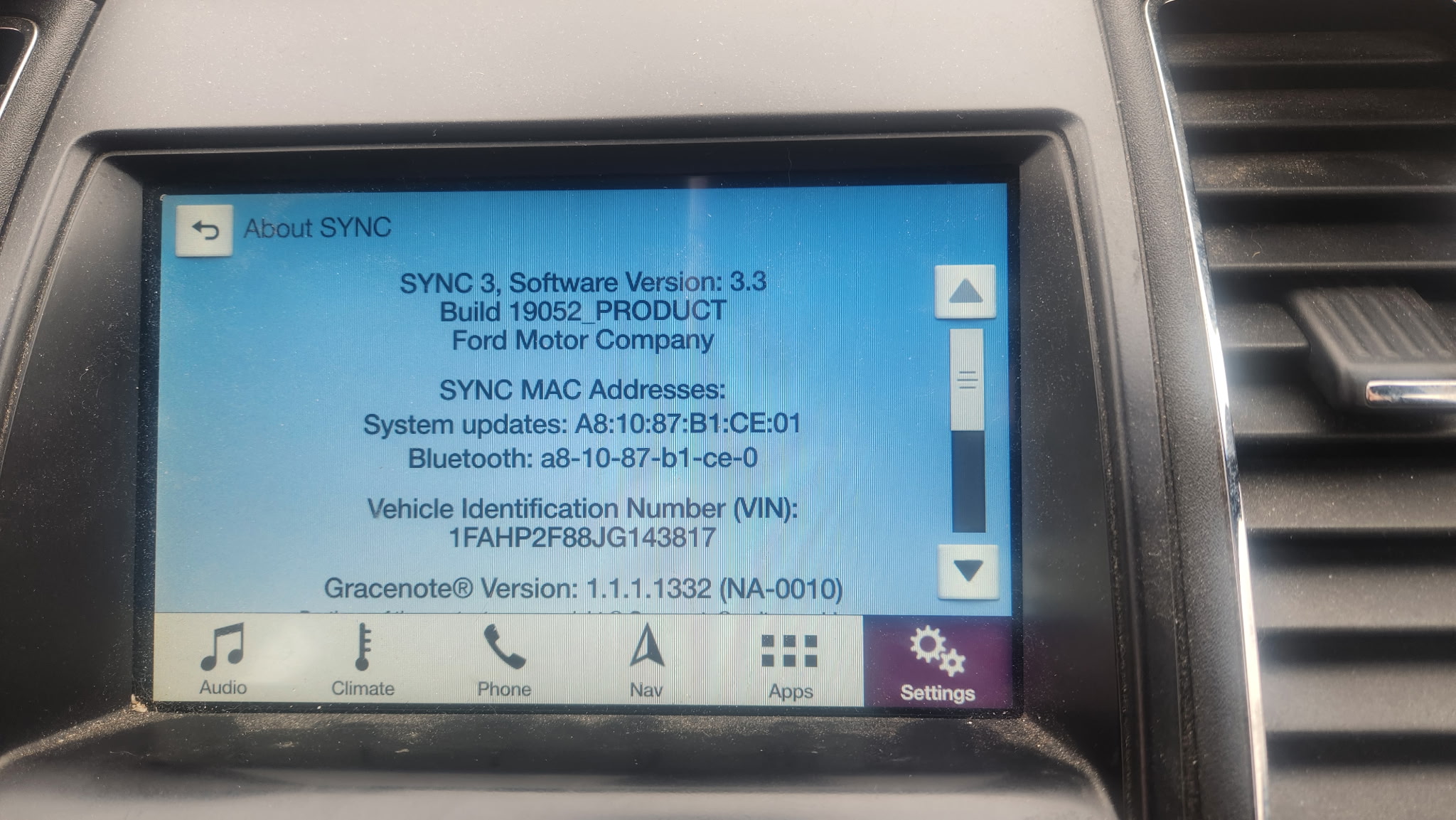

You can’t revert to 3.0.
There are known issues with .23188 on non NAV older APIMs, use the updater to drop you down to 3.4.21265, this doesn’t require a reformat.
Even though according to sync my apim isn’t factory nav and ive had navigation that worked until now. Will that bring my navigation back also cuz tbh I dont like the layout of the 2388 anyway.
As stated in the documentation, once you go to 3.4 from 3.0 you can’t go back without replacing the APIM with a 3.0 APIM.
The closest you can get to the 3.0 look and feel without replacing the APIM is to use the updater to downgrade you to 3.3.19052
That’s fine according to sync my radio shouldn’t go past 3.0.23219 anyway but before I updated it was running 3.3.19062 and worked. According to sync i dont have factory nav but somehow it was working before I updated it didnt know it was a non nav apim before so I used a map update as well. I can deal with the 3.4 look I just need to find out how to fix my gps and clock. I can attach images of my information before and after I updated.
That’s not good, I assume this was before upgrading.
This points towards an unhealthy APIM.
This is the definition of an oxymoron. Ford is telling you the vehicle is no-nav, but you still call it “factory nav”. Consider this a retrofit.
Do that.
Then why are you still calling it factory nav if you are not the first owner of the car? Plus Ford is telling you it’s no-nav from the factory. So please, stop calling it “factory nav”.
VIN information does not come from the APIM, so it’s irrelevant.
Share the interrogator log and the picture of the sticker.
