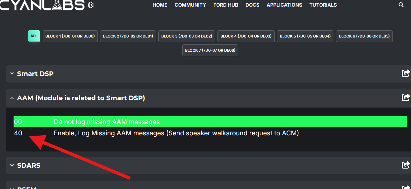

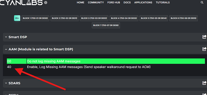

PS. To post this, I had to go down to the car and generate a log. I only just looked at it carefully. This information in the log caught my attention.
Could this affect the sounds? Please bear with me, as I don’t speak English, so I have to explain everything, and not all the options are clear to me. Should I try to change it again?

Module=7D0 (APIM)
01-01 0968 6592 90D1
01-02 02FC 1500 02EF
02-01 474D 0106 40B5
02-02 0308 0000 00E6
02-03 0005 E1
03-01 0000 0100 00DC
04-01 0100 1601 04F8
04-02 0007 E4
05-01 17A2 1798 286D
05-02 BE9C
06-01 805E
07-01 1503 3300 002A
07-02 0000 0682 0068
07-03 0004 3065 007A
07-04 6446
08-01 0000 0000 00E0
08-02 0000 0000 00E1

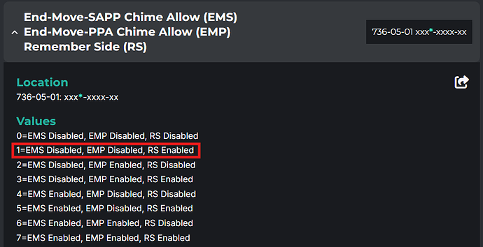

Module=736 (PAM)
01-01 8C45 1549 6E
02-01 4001 0E00 8F
03-01 0000 4318 9C
04-01 0740 2000 A9
05-01 3001 3000 A4

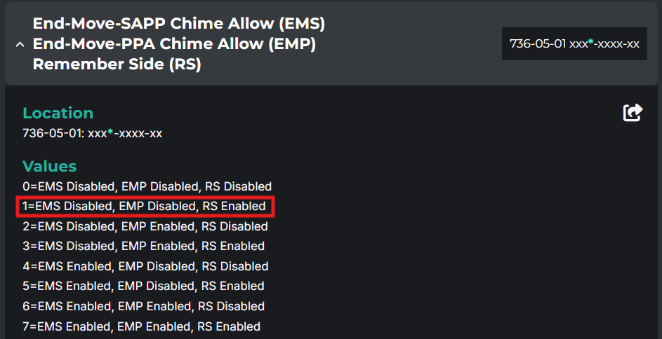

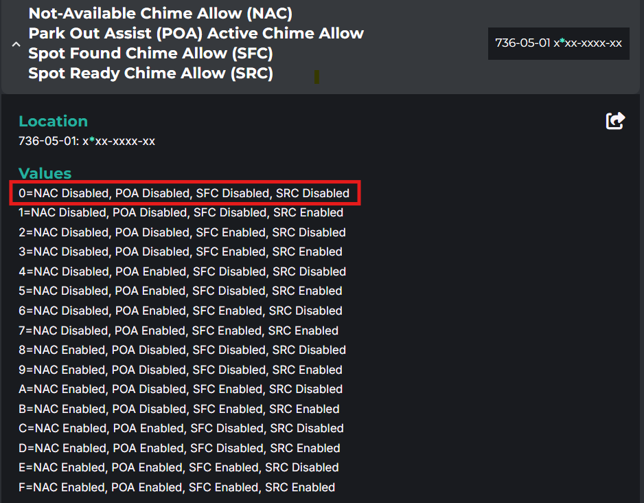

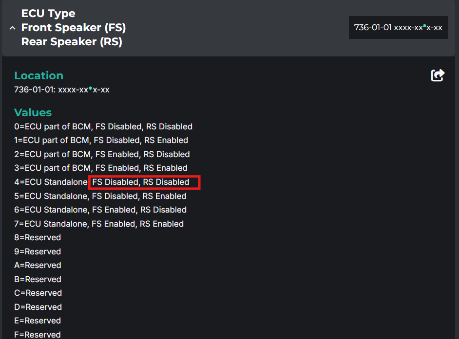

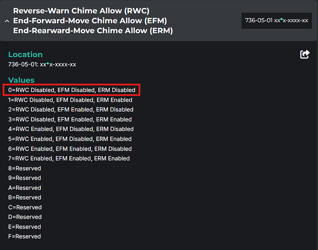

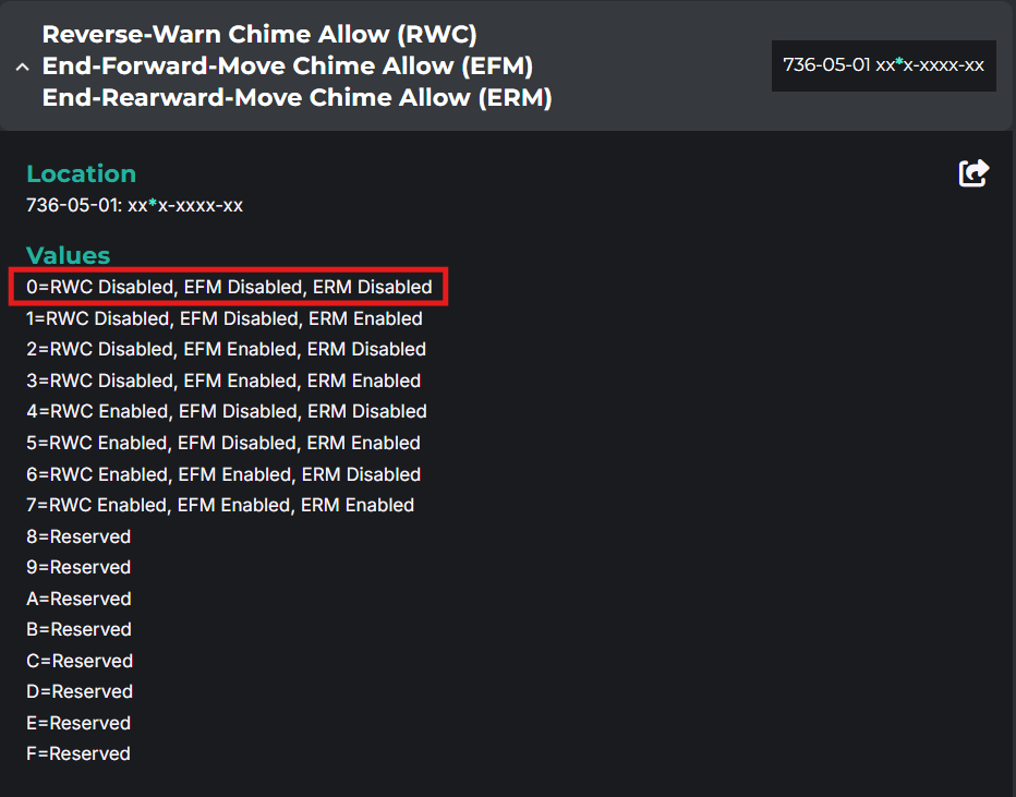

Question
What does this function do?
Should I change it to - enabled?
I changed this option to “F” - nothing improved.
Is it correct that I originally have “0”
Is this set up correctly? This is how it is in the original
