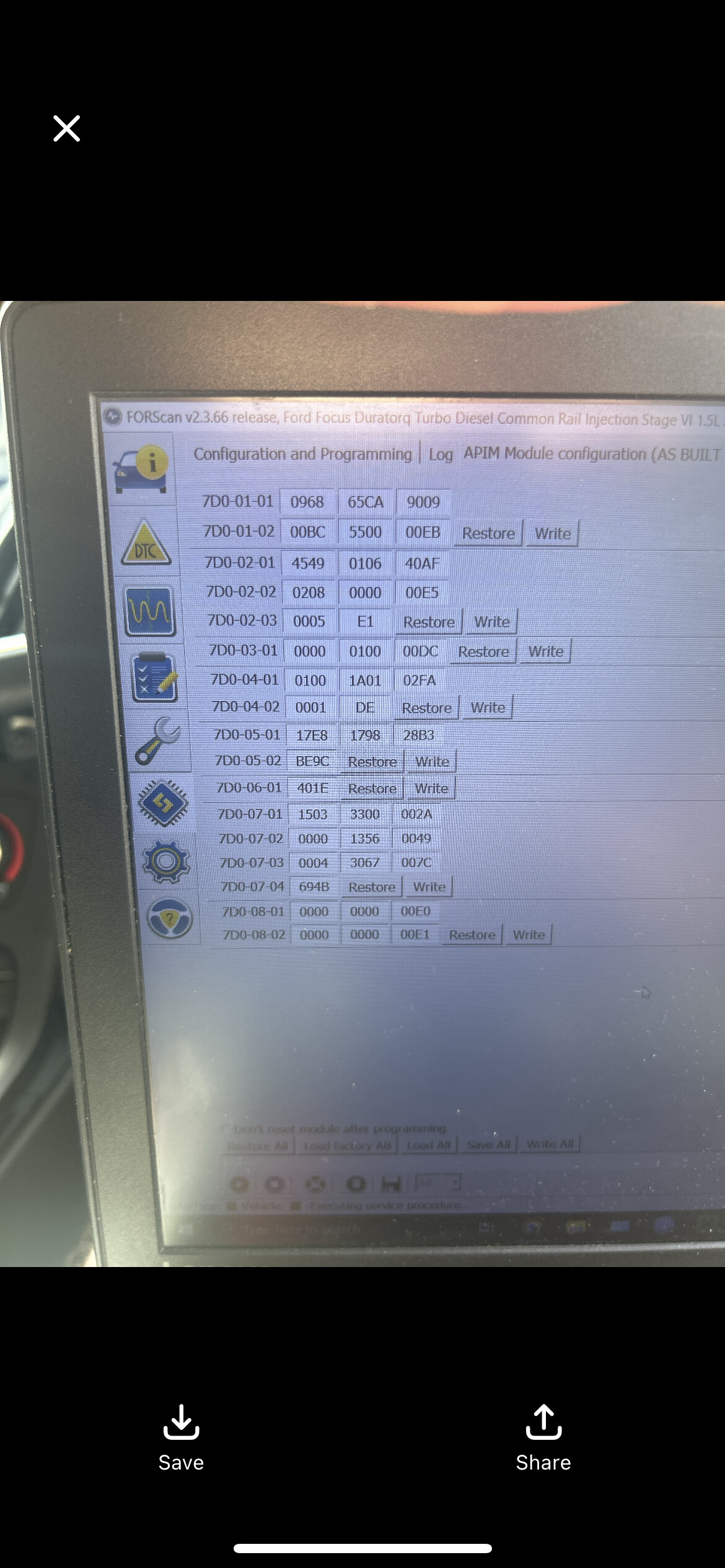

OK, post the asbuilt for the ACM you are using. Most likely you need to adjust the APIM Gen to Gen 2 on the first line.
This is my current APIM AB data as I got it from the donor car. ACM data all I can see on Forscan is 727-01-01 but there’s only 0030 after, which I think maybe isn’t right?
