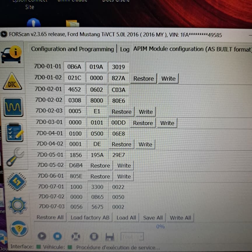

I photographed the complete APIM in 2 photos
OK, just use the first one…

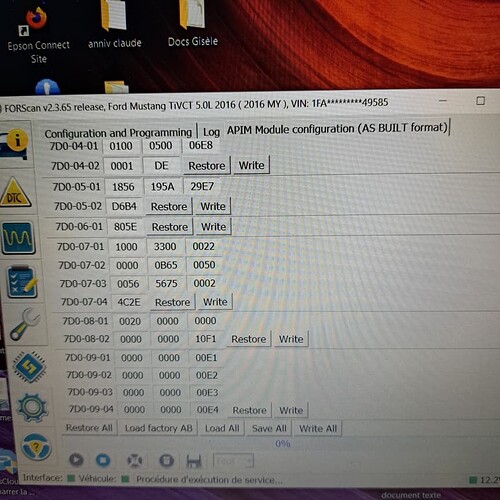

Hello,
So, to be sure, I just need to change:
7D0 07 03 XXXX 566F XXFC
Is that correct ?
Yes, but you’ll need to add the 7D0-09-xx lines also…or enter it all in manually. Keep you 7D0-08 and -09 lines as they are.
This will work…
1FA6P8CF4G5249585_APIM_202500508.abt (495 Bytes)
Great, I downloaded the entire ABT file and everything works perfectly. The day/night mode activates when the headlights are turned on.
Thank you very much for your help and efficiency, especially since I’m not very familiar with Forscan.
I’d like to contribute at the end of the month to thank you. Should I go through the website?
Just PM me…
