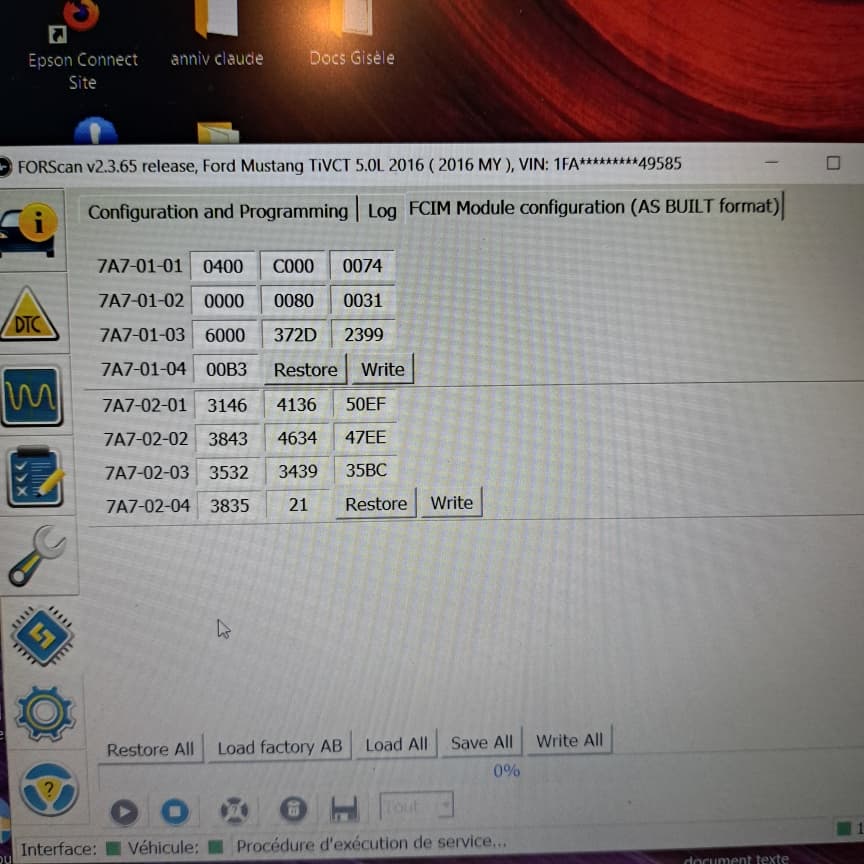

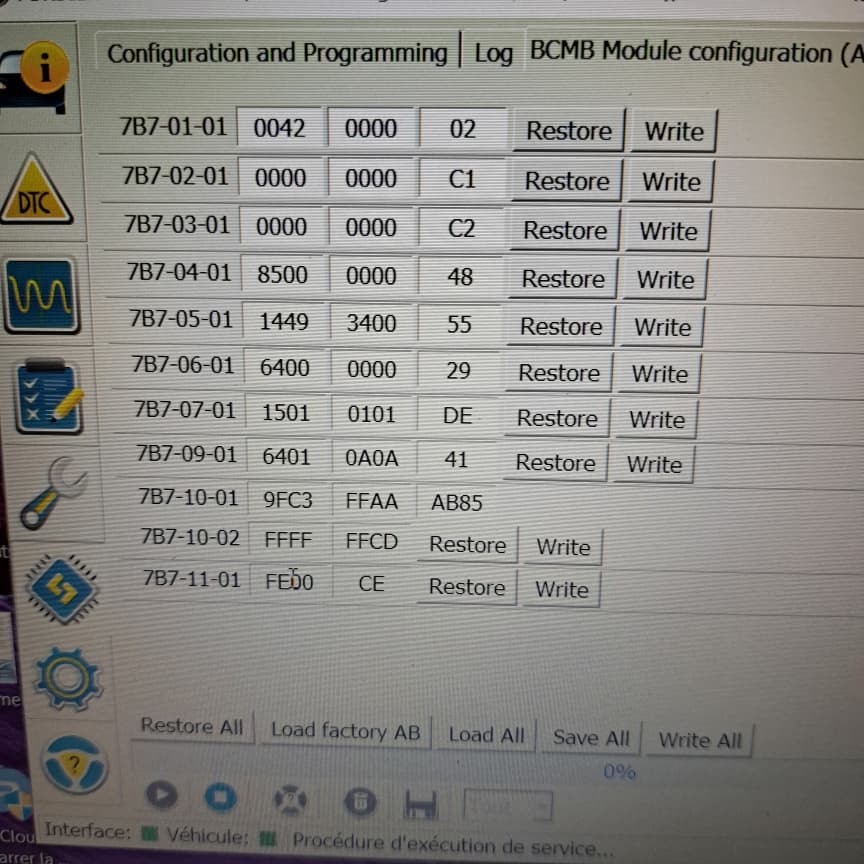

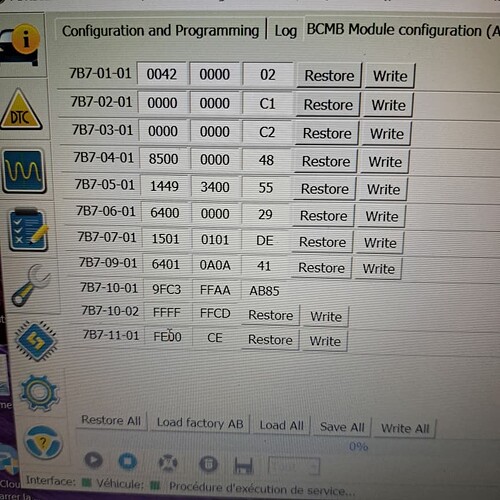

I took a picture of BCMB with forscan
I didn’t find HVAC
Try FCIM.
Do you have a BCM module, not BCMB?
No BCM mode, only BCMB

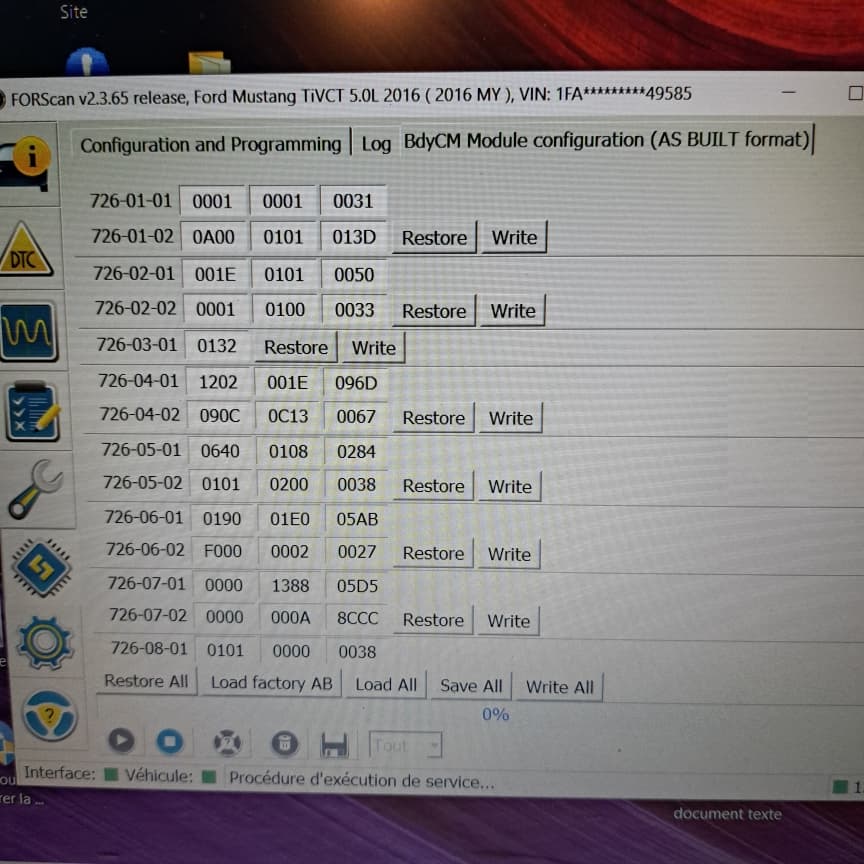

However, I have BdyCM in Forscan.
That is a BCM…and there are a lot of pages to it. It would be better to save the file and post the ABT file here.
