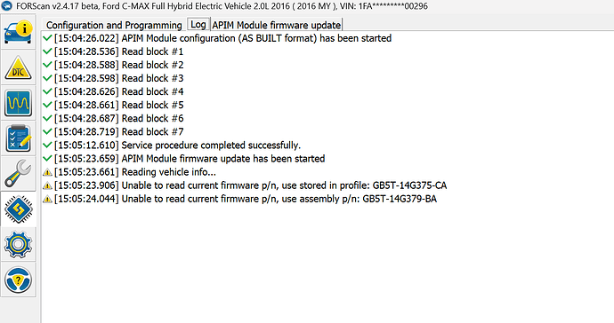

OK that didnt make a difference, I rewrote the unchanged, still rebooted every 30 seconds.
What did work is that I tried again I tried GB5T-14G374-CB and that worked! I could then update to 2.2.17011 via a cyanlabs USB update.
So will think about what do do from here as then Display is working much better now.

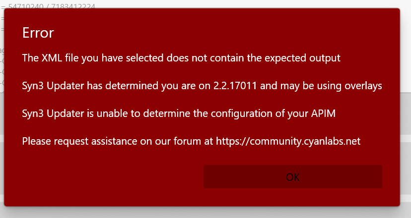

Still get this:
Sync_VU9C2DNJ_1FADP5BU7GL100296.xml (10.1 KB)
looks like I need to reload these files:
So in this case I’d to program custom, select calibration file, and the ECU files and write those?

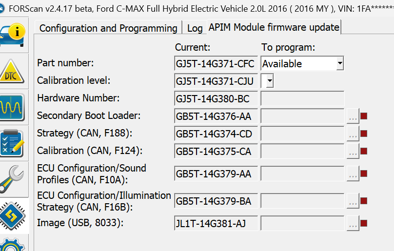

You have this installed…
HN1T-14G381-SA (460Mb Sync3 v2.2.17011 11.01.2017)
GB5T-14G391-CK (voice file 349Mb Sync3 v1.0.15049)
GB5T-14G422-CJ Map voce file
GB5T-14G423-CJ (GN)
GB5T-14G421-CJ Maps 8.0Gb Sync3 v1.0.15048 NA.1.14
HB5T-14G386-AHF (863Kb overlay (ifs с /apps/APP_SUM) → HN1T-14G381-SA )
This combination has issues.

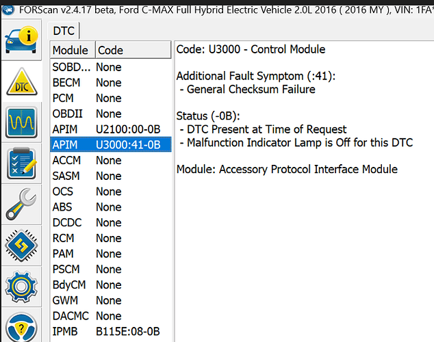

Find out what these DTC’s are…in the APIM. Clear them.
<d2p1:DTC DTCValue=“f000410b”/>
<d2p1:DTC DTCValue=“5001010b”/>
<d2p1:DTC DTCValue=“e100000b”/>
Storage…

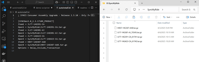

You need to reinstall Sync 3.0.17011 or 17109 with the overlay delete script (HB5T-14G387-AAB) in the autoinstall file. The state of your APIM now will never work right.
HB5T-14G387-AAB.tar.gz (5.3 KB)
autoinstall.lst (425 Bytes)

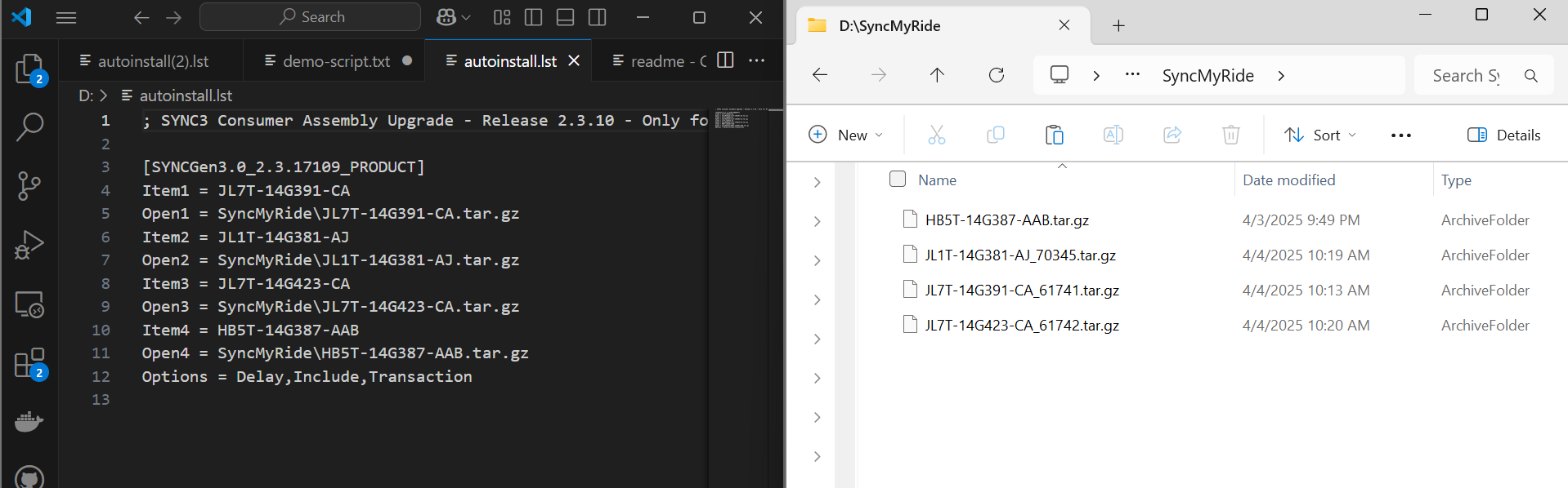

Autoinstall contents…
[SYNCGen3.0_2.3.17109_PRODUCT]
Item1 = JL7T-14G391-CA
Open1 = SyncMyRide\JL7T-14G391-CA.tar.gz
Item2 = JL1T-14G381-AJ
Open2 = SyncMyRide\JL1T-14G381-AJ.tar.gz
Item3 = JL7T-14G423-CA
Open3 = SyncMyRide\JL7T-14G423-CA.tar.gz
Item4 = HB5T-14G387-AAB
Open4 = SyncMyRide\HB5T-14G387-AAB.tar.gz
Options = Delay,Include,Transaction
You will need to download the JL7T files and make a usb with a SyncMyRide folder, place all the files in there. Place the autoinstall file in the USB root.
Remove the USB when finished.
Let the update finish and the unit will reboot.
Once the unit is rebooted, master reset.
OK will try this later today, I assume i have to update the names to match the actual tgz’s I downloaded from the APIM software archive.
Let you know how it goes later:
The names must match exactly…modify one or the other.
JL1T-14G381-AJ
JL7T-14G391-CA
GB5T-14G422-CJ
JL7T-14G423-CA
GB5T-14G421-CJ

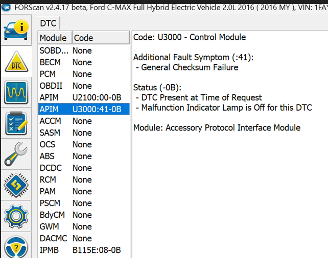

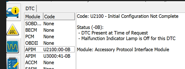

seems to work but I cannot clear the errors, checksum and init errors, you can disreguard the camera error this is where I’m at:
Drop your factory AB back in, that will let you clear the initial config DTC.
Nothing out of the ordinary here… like Warlock said, load your factory asbuilt, should clear all that up. Master reset after.
thanks that seemed to do it. Now to fix the backup camera and decide to upgrade further.
