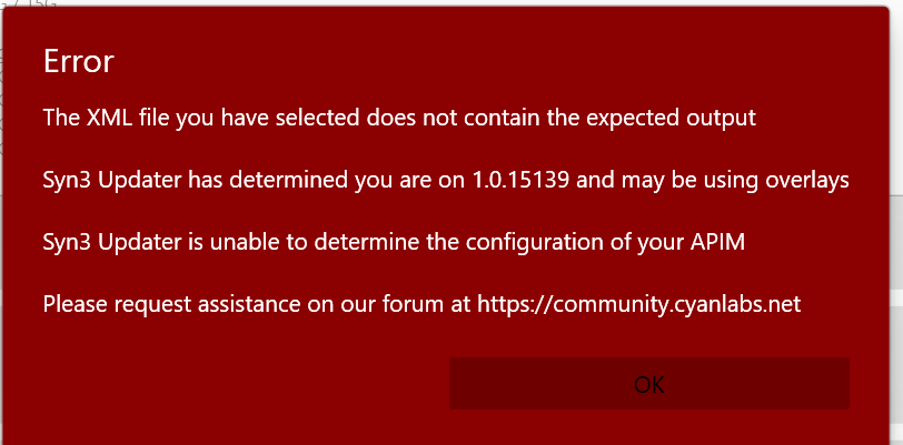

I get this error on the Syn3updater:

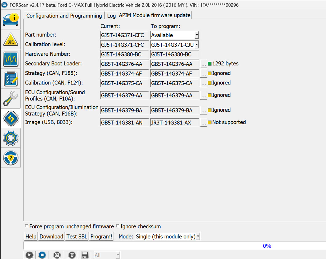

Notice that the interrogator file could not read the strategy file in the APIM. This is due to a corrupted file, and the reason you cannot upgrade the APIM. The file in question is GB5T-14G374-AF.VBF. The GB5T-14G374-AF.VBF from Ford is broken and has bad addresses. Uploading strategy file GB5T-14G374-CD instead of GB5T-14G374-AF will repair the APIM. This must be done with FORScan paid version to support firmware uploads.
I have FORScan paid version on iPhone, let me know if this is not what i need, thank you very much for the help
You need to run ForScan 2.4 running on Windows or a Windows VM in order to do this, it cannot be done from a phone.
You will also need a USB OBD adapter. The suggested model from FORScan is the ScanTool OBDLink EX.
Please read thru this doc for the specific files affected.
Also, make sure you read the FORScan programming guide on their forum as firmware programming can be risky.
Updating Sync 3 APIM Firmware Using FORScan 2.4.x Release - Ford / Guides - CyanLabs Official Community
hate to ask dumb questions, but you said Uploading strategy file GB5T-14G374-CD,
but the docs says that is non nav, does this matter? I got the OBDLinkEX so I’d like to take a crack at it tomorrow. Thanks!
If you have the -AF file in the APIM you need to change it, regardless of nav.

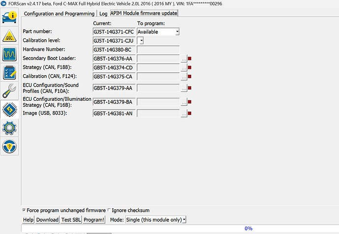

I’m bumping this because I am going to try tomorrow, got a subscription to forscan and the adapter, Still cannot figure out how to update the GB5T-14G374-CD as it does not show up as an option, but need to take a closer look at it.
This is what comes on the screen to program:

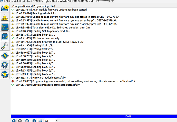

OK I seemed to have messed it up, will look into how to “unbrick”, here is my log:

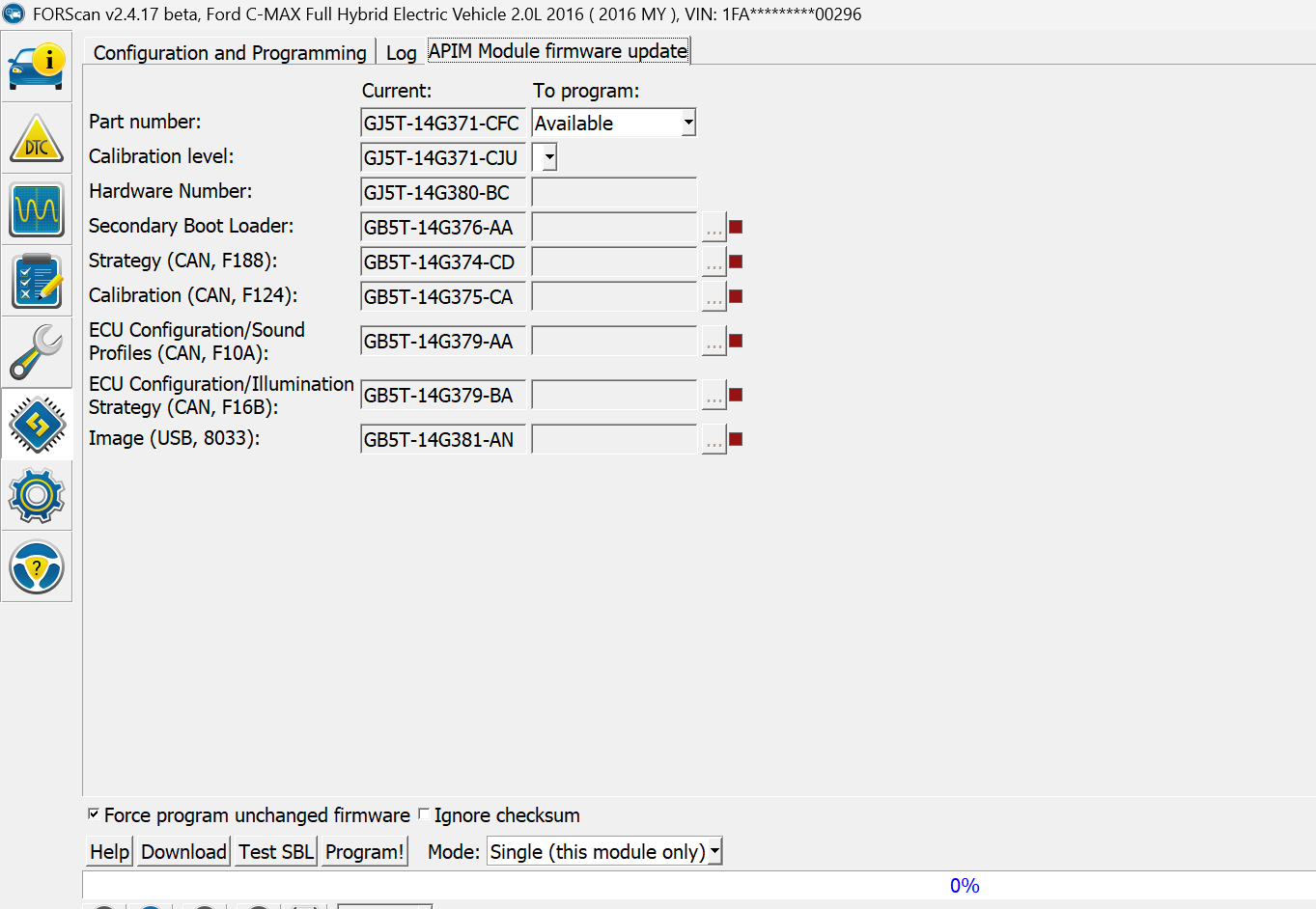

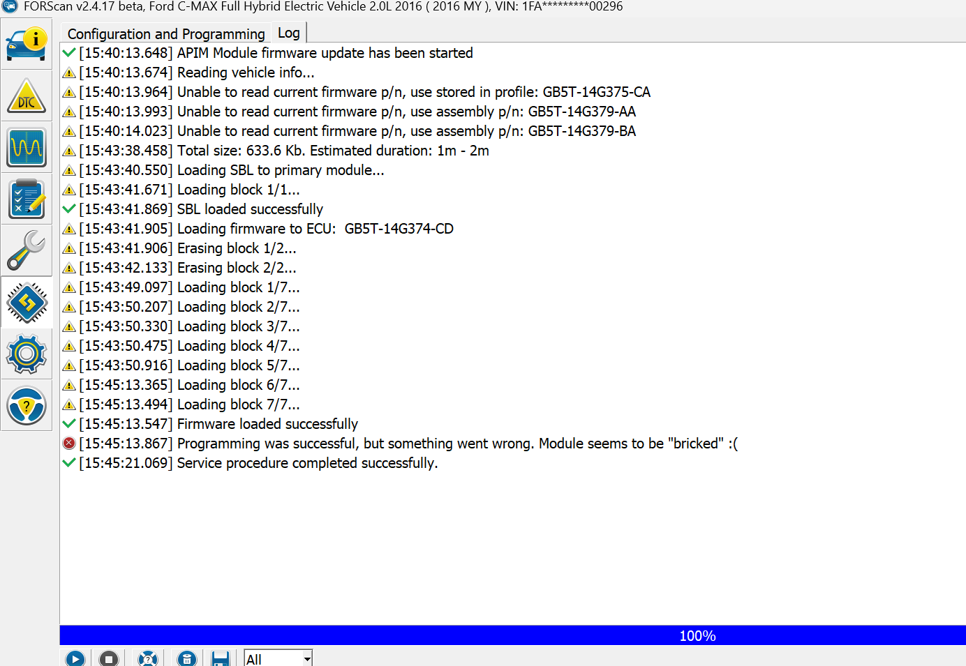

OK I tried again with GB5T-14G374-CD using the recovery procedures, and the module is now booting, but now reboots after about 35 seconds in this state now:
Just realized I was in mode single, probably not what I want?
Reload your asbuilt all at once from OEM.
what mode? Single? thanks
