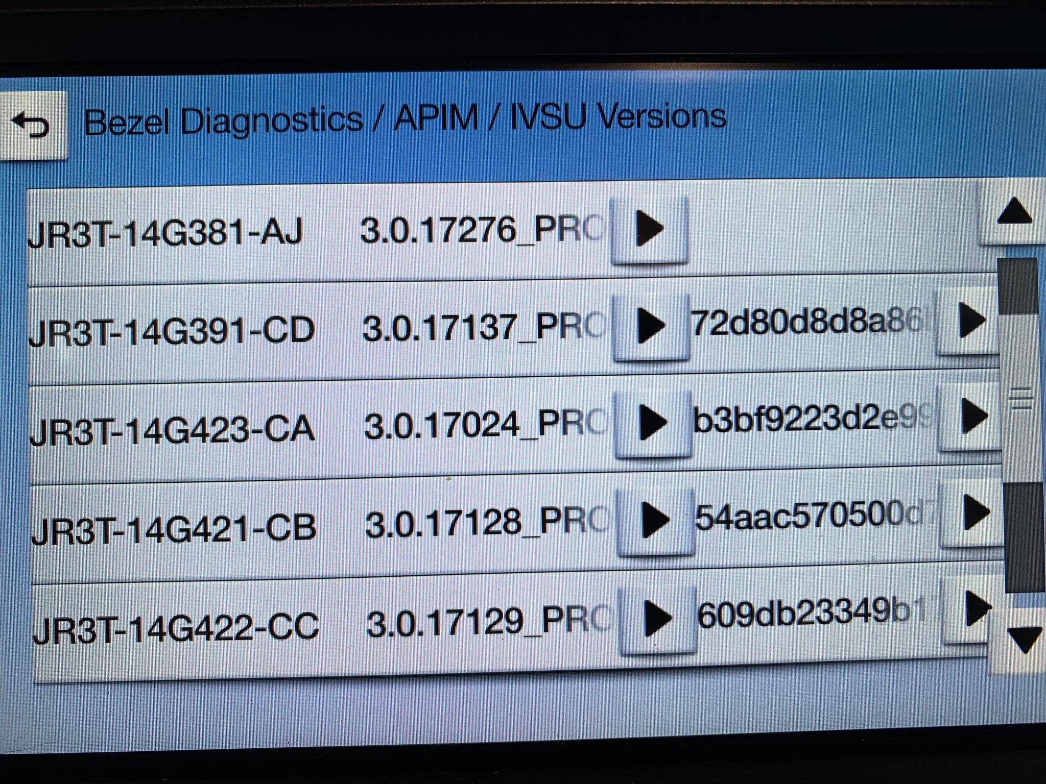

I tried to update my Sync 3 from version 3.0
and I get the INSTL_ERR12
I tried to used to different pendrives - both made with your downloader
What I do wrong? How can I fix it?
