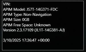

I have a recently purchased 2017 Ford Focus hatchback, and I would like to update its navigation system. However, several questions have arisen before I start the process.
My head unit’s current version is 2.3.17109, and I’d like to update it to the latest 3.4.23188 version.
I used the Interrogator Log to read the head unit’s data, but I ran into a few issues.
For some reason, the Syn3 updater reading throws an error when i open the interrogator log.
The APIM Type shows up as Non-Nav. What exactly is the difference between NAV and Non-Nav? (I know its a stupid question.) I can search for streets and start navigation without any problems, so I don’t fully understand the distinction between the two. Furthermore, the official Ford website doesn’t show a map update available as well for my vehicle, only the 3.0.23219 software version.
The previous owner did not mention that the head unit had ever been replaced.
Finally, if I decide to proceed with the update, can I go directly to the latest 3.4.23188 version, or are there any intermediate steps I need to perform first?
Thank you in advance for your help and answers!
Old SYNC Version: 2.3.17109
