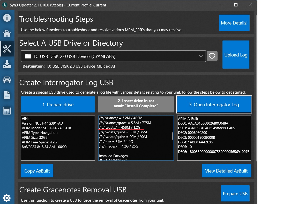

This image showing the RWDATA partition status. I’m thinking this is why the settings in SYNC keep reverting on key off to key on. No more room to write into the APIM?
Yes most likely, but the only way to clear this is with a jailbreak or a reformat if you are not MY20

I flashed again from 33088 to 33188 and the RWDATA partition now shows 461MB free of 1.2GB. @CyanLabs are you aware of exactly which release fixed the RWDATA issue? Anyhow, things seem to be speedy again, holding settings and working as expected.
@CyanLabs FYI, no jailbreak was required so far. Somehow, it ended up cleaning itself up. Wish I knew more, but that’s what happened between 33088 and 33188. Check out interrogator!
