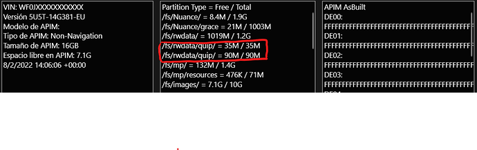

the screenshot I’ve added to the post was made when I uploaded xml from Syn3 Updater.
However it is so weird, why it doesn’t generate xml correctly, just returned from the car and still incorrect content. :sob:
OK Thanks, then it should have worked however as we have already established the file is corrupt so that’s why it didn’t :slight_smile:

can’t this be a problem why the APIM cannot perform certain operations correctly, like log writing (partition is 100% full)?
No.
