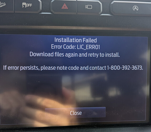

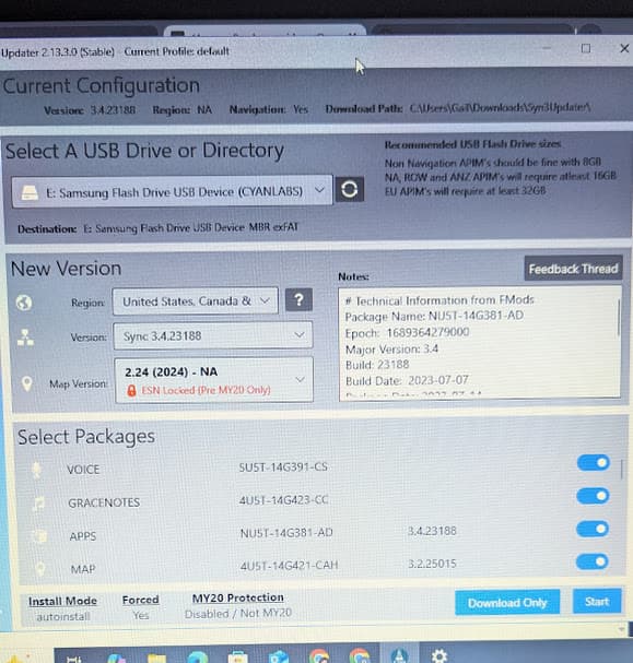

configured sync3 like this:
USB was created without error.
when installing though, received this error:
thanks for any additional suggestions
Dave
You created a forced autoinstall. Look at the bottom of the first pic…instead of autoinstall you need a downgrade.
Do not force the installation, place the Syn3 Updater in Automatic mode.
Your trying to install maps with a reformat on a 2020 vehicle that 99.9% has a 2020+ APIM. Your gonna brick your APIM.

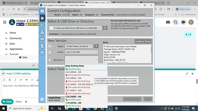

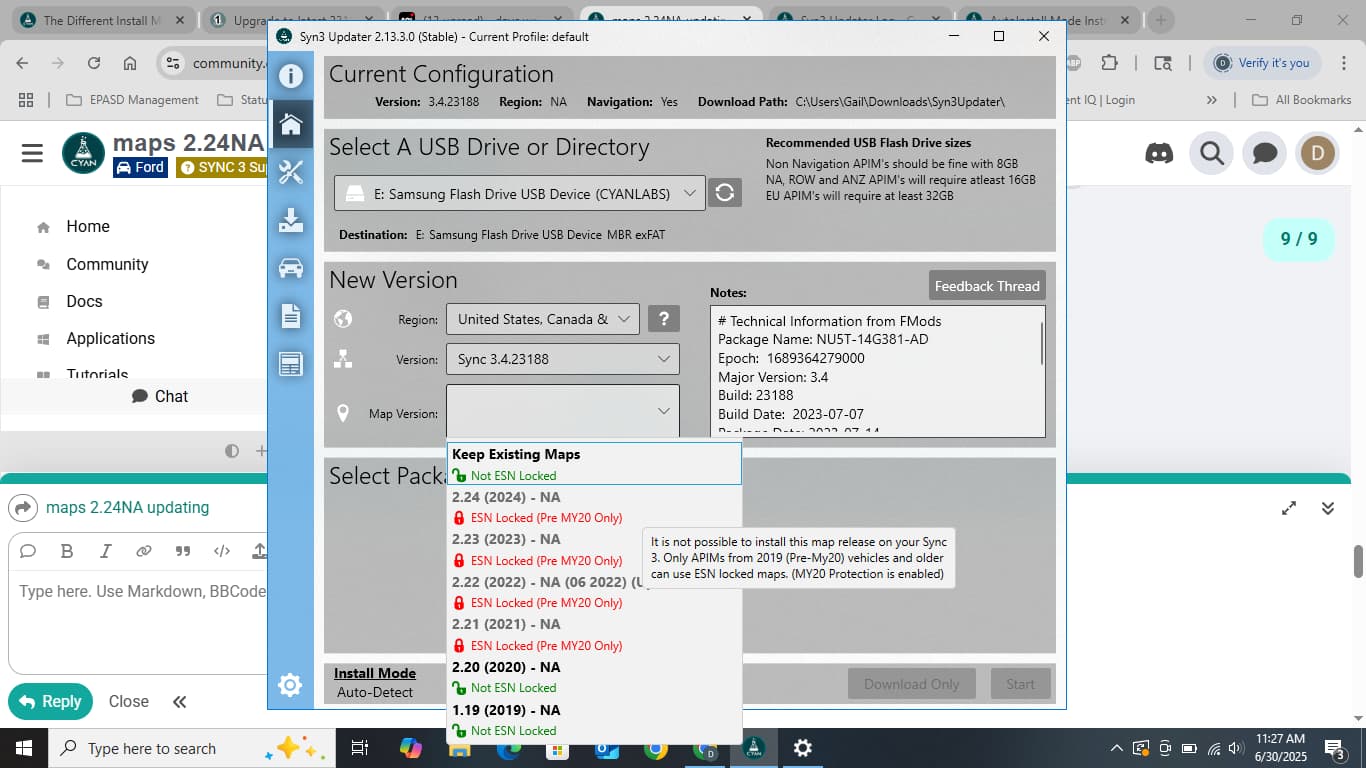

F150Chief… when you say select automatic mode, do you mean auto-detect?
When I select autodetect, the maps 2.24 is greyed out.
If selecting downgrade, I still have to disable MY20 protection. Is that correct?
confused about the term “automatic”.
I would never disable the MY20 protection as that is a good way to brick your APIM and make it a door stop.
Chances are your APIM is a MY20+ and as such, you cannot update your maps with Syncupdater.
