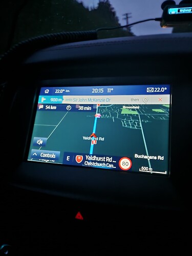

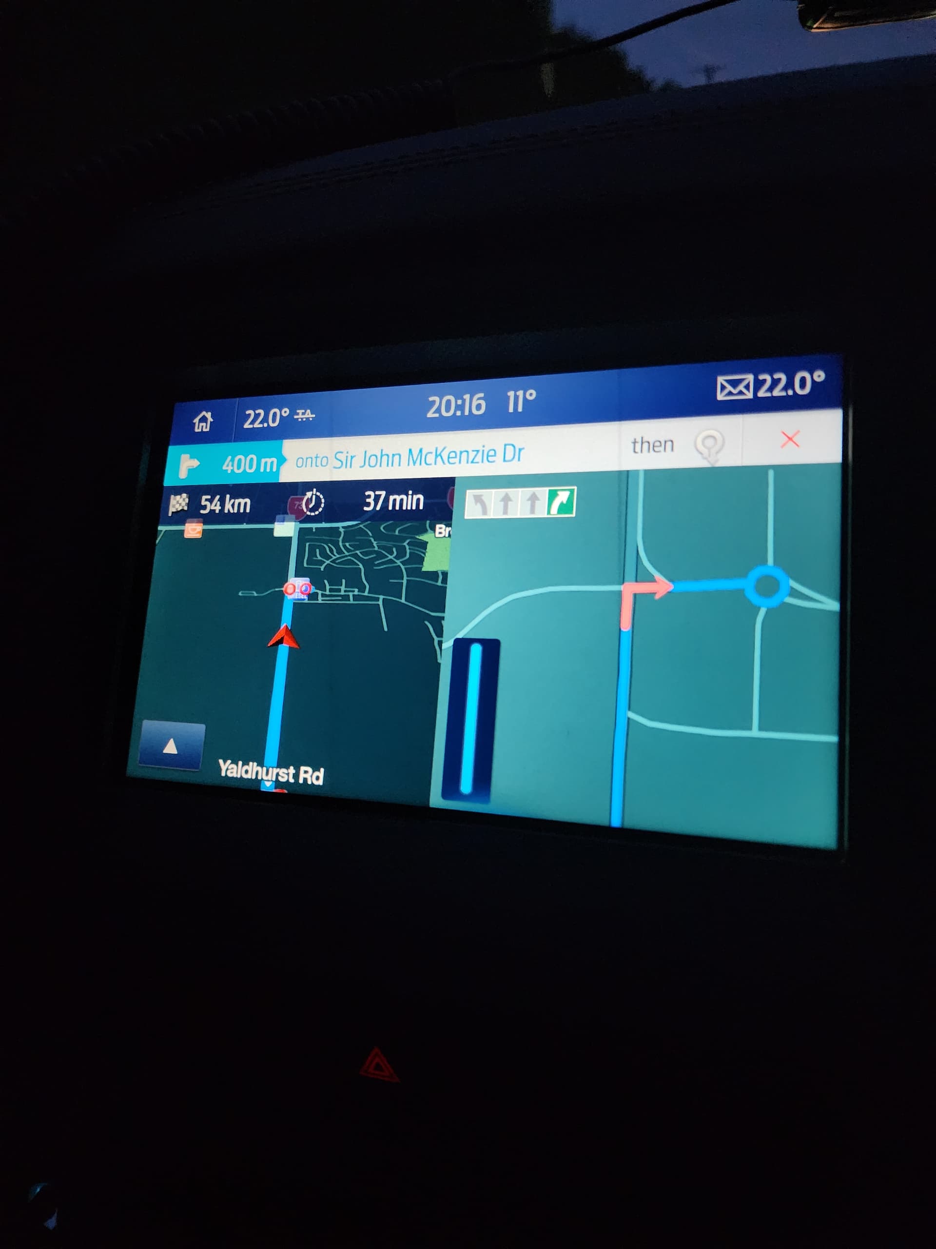

Can you post a pic of the split screen view, please…
split screen here
Full screen here

I understand that but as I’ve clearly explained the big above mine is stuck on the split view. I may choose full screen but upon the next turn in navigation the split view is magically back.
I can’t seem to have full screen as the split with the intersection view is coming back as default.
