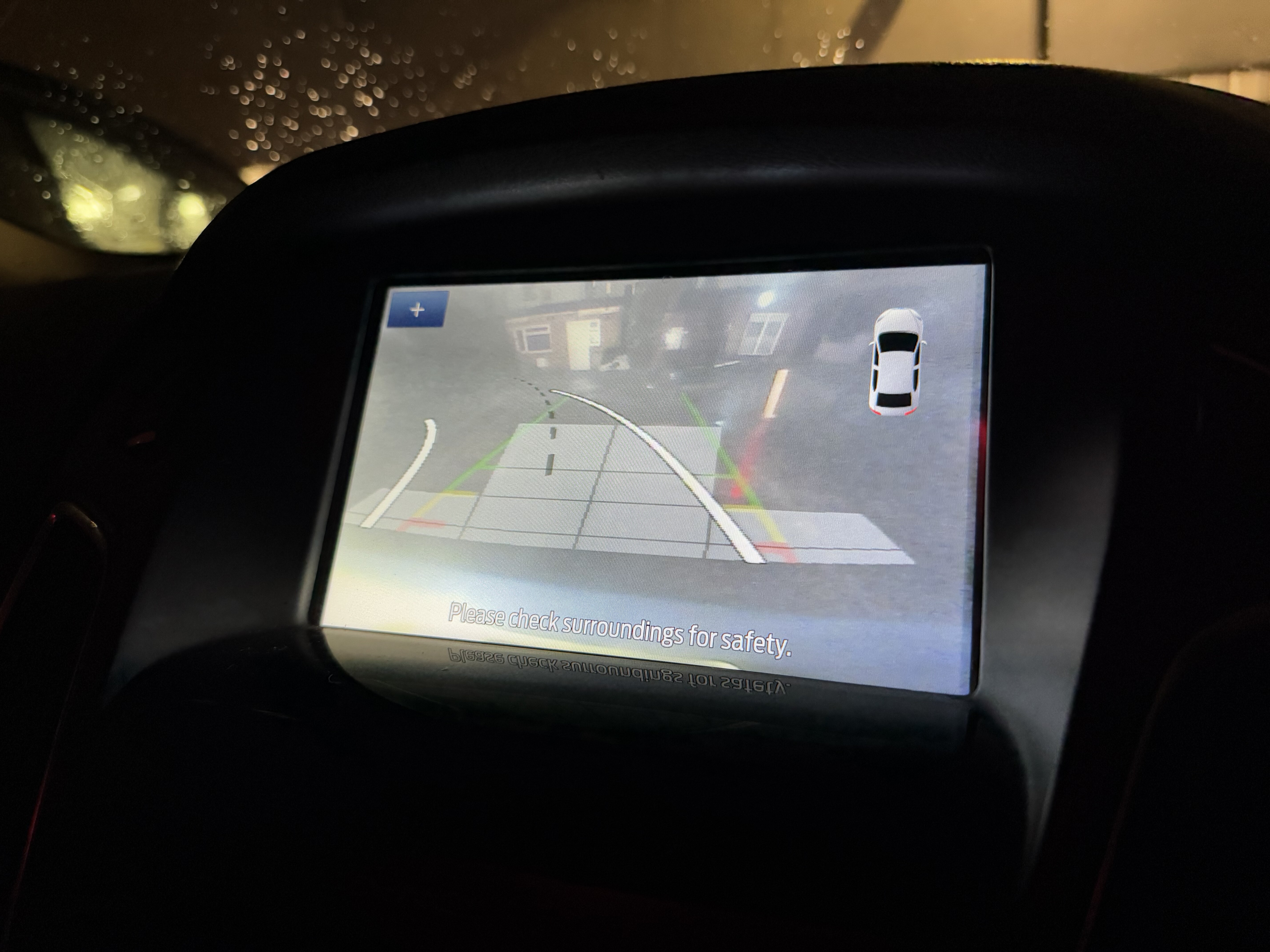

I put my original back in. Would rather accurate blocks than inaccurate lines.

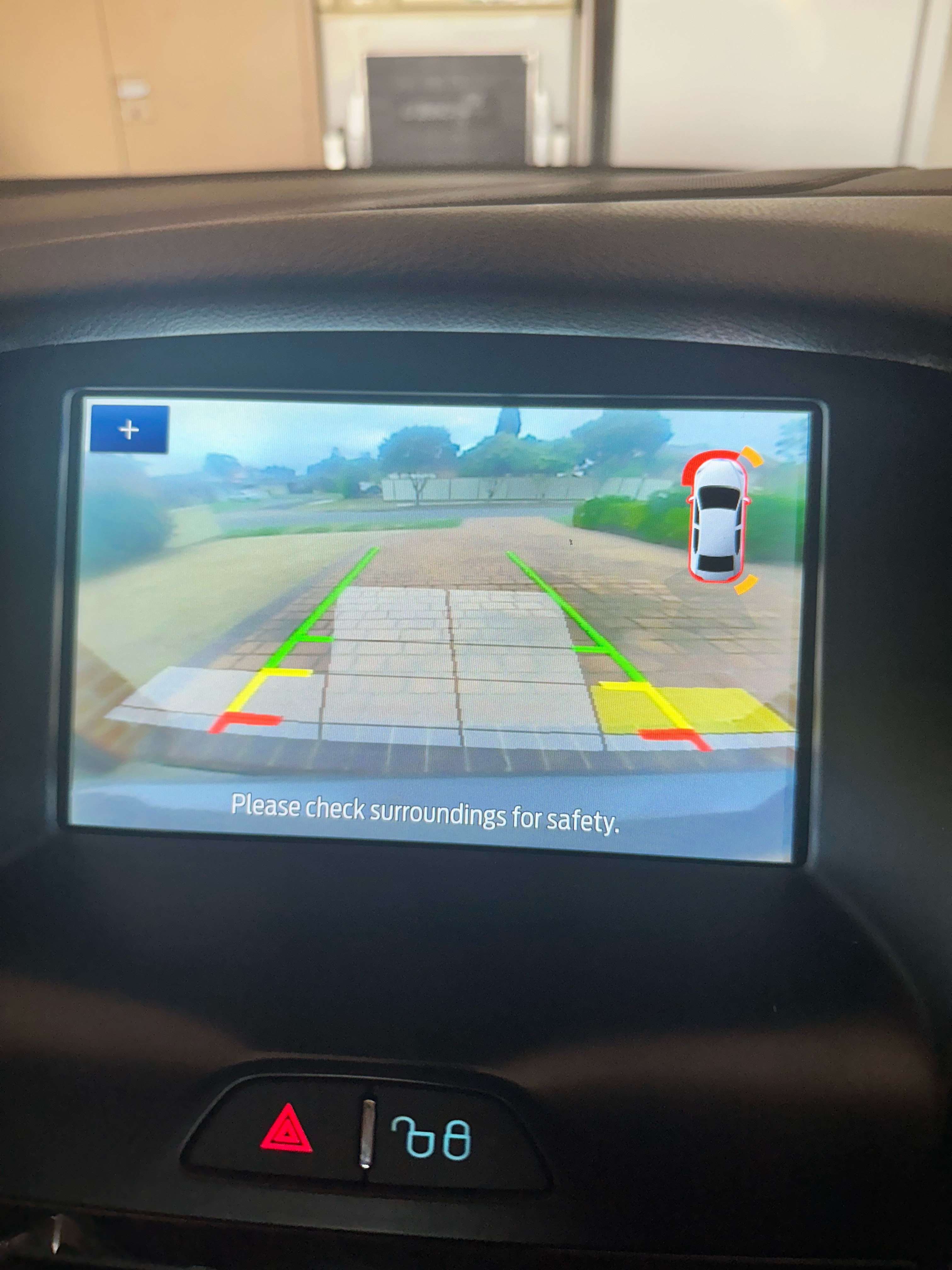

That fixed it. I even have the dashed centre line now.

Mine was 51CB D5 - changed it and it instantly worked and even got the dashed centre line which I never had.

You guys rock - changed the IPMB coding to match yours and I have the dynamic lines back
Iâve been struggling with this for a year!!

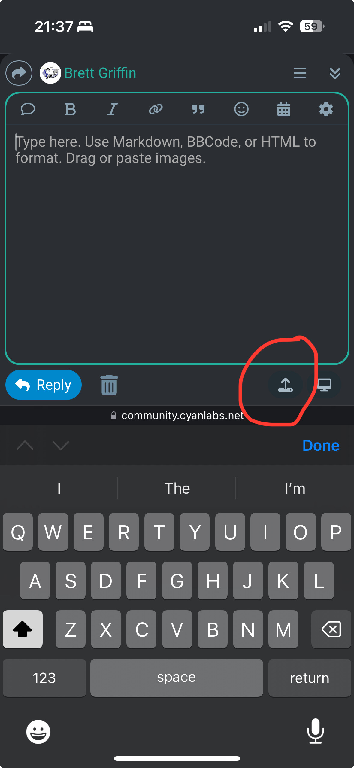

Fantastic news. Now teach me how to embed / link an image. ![]()

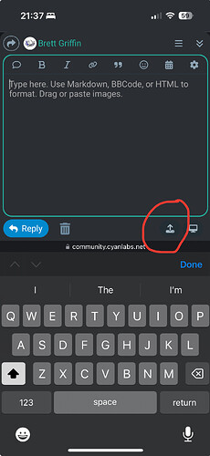

Iâm on mobile and I speculatively pressed this button:
It must have worked if you saw the photos, I wasnât convinced ![]()
as this isnât in a support category it canât be marked as resolved
