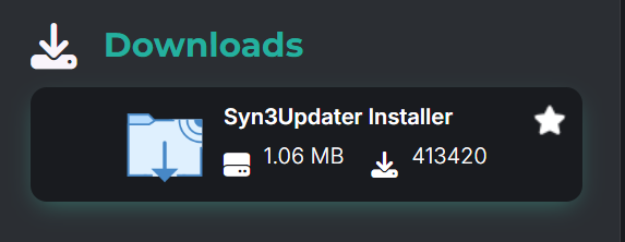

I’m not sure where you are trying to download “something” from, since in Syn3 Updater - CyanLabs there’s no “Get Syn3 Updater” button or text… So, maybe you are just clicking on some ad?.
Click this on the right:

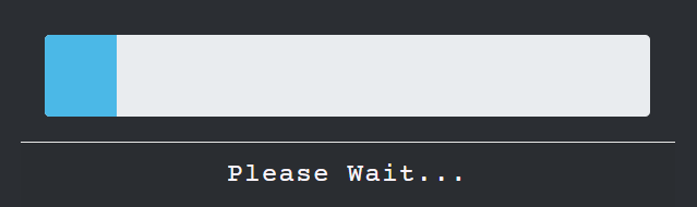

That’s odd… Once you click on that, the following page should display a “loading bar” like this:
Once it gets full, the EXE should be automatically downloaded without further interaction.
Where does it exactly fails?. Also, if the file you download is like the one I’ve sent just above, you can ignore the warning.

Regarding your first question, I did see the “loading bar” and I get the error messages once that finishes.
