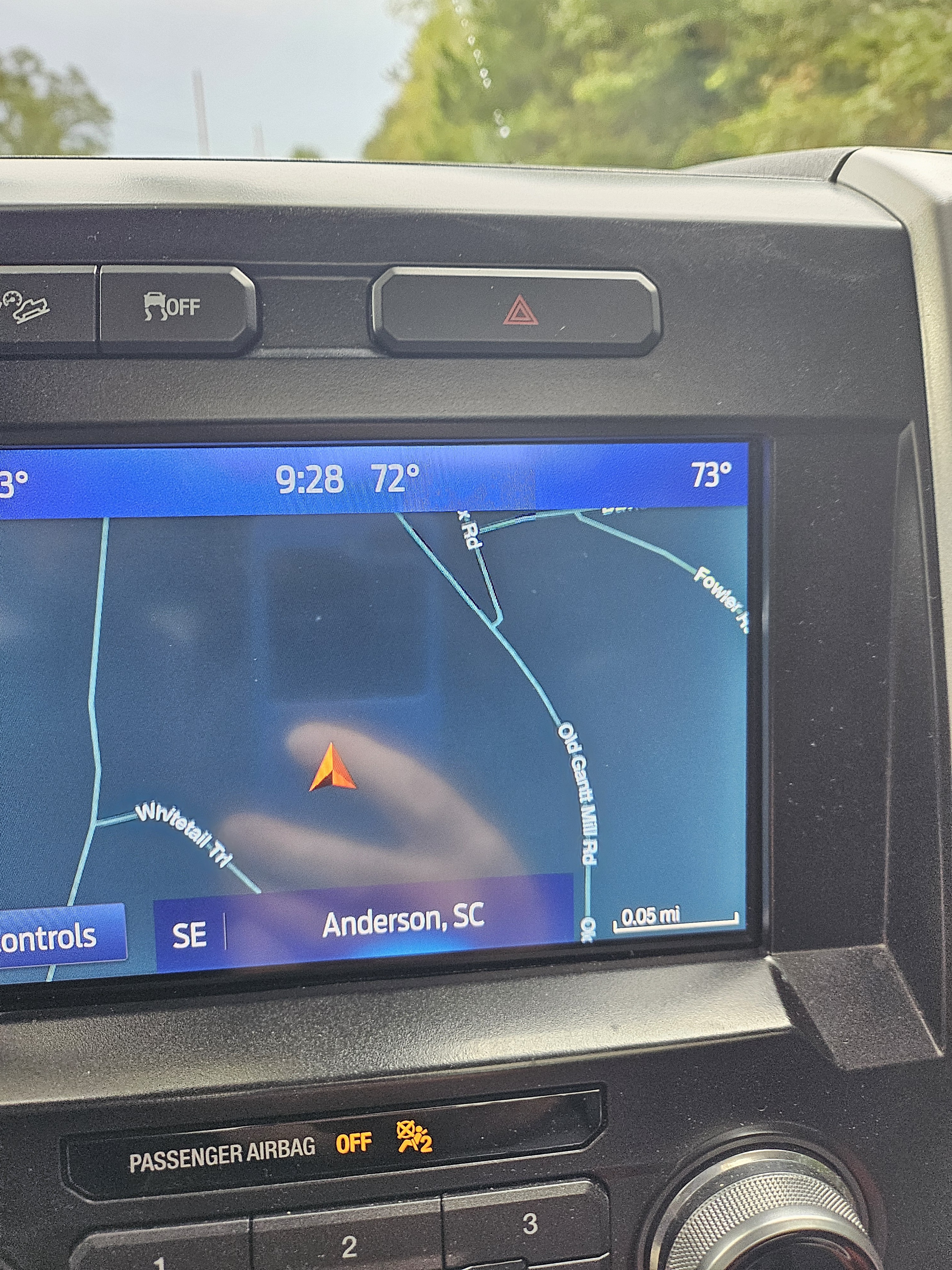

I am having issues with my navigation not staying on track. My maps are showing me in a different area then vehicle is. This is something that just started after an update. Does anyone have the proper code for navigation tracking.

I did try master reset and no fix. Not sure what code I need but attaching pic of issue. My cursor is off track.

Since you have a retrofit this is more than likely a bad GPS antenna. Go into the test screens on your APIM and look for the GPS signal strength option. I would bet they are all low.

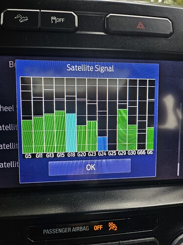

Here are my signals.

Those GPS levels are terrible.

Your GPS signals should look like this…
