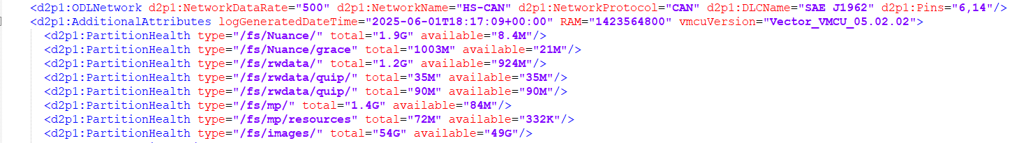

Hi,
Here it is:
And the full log:
Sync_LVC400SF_WF0FXXWPCFGT5.xml (9.9 KB)

There is plenty of storage available:
<d2p1:PartitionHealth type=“/fs/images/” total=“54G” available=“49G”/>
No issues with RWData.
It’s interesting that the Interrogator Utility is not reading the asbuilt data or the firmware versions of the APIM. The only data showing is the serial number.
