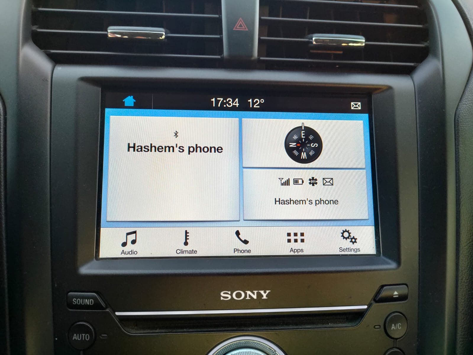

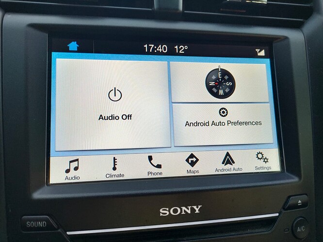

I own a 2018 Ford Fusion Titanium. The navigation option does not appear on the screen by default. However, when I connect my phone, the navigation option becomes available.
I would like to know how I can update my screen to show the navigation option permanently. Additionally, I want to ensure the system is updated to the latest version, preferably with features like Google Maps, if possible.

Without connecting my phone
With connect my phone
You have a non nav APIM you don’t have enough storage to install NAV, thats why it only works when using Android Auto or Car Play.
