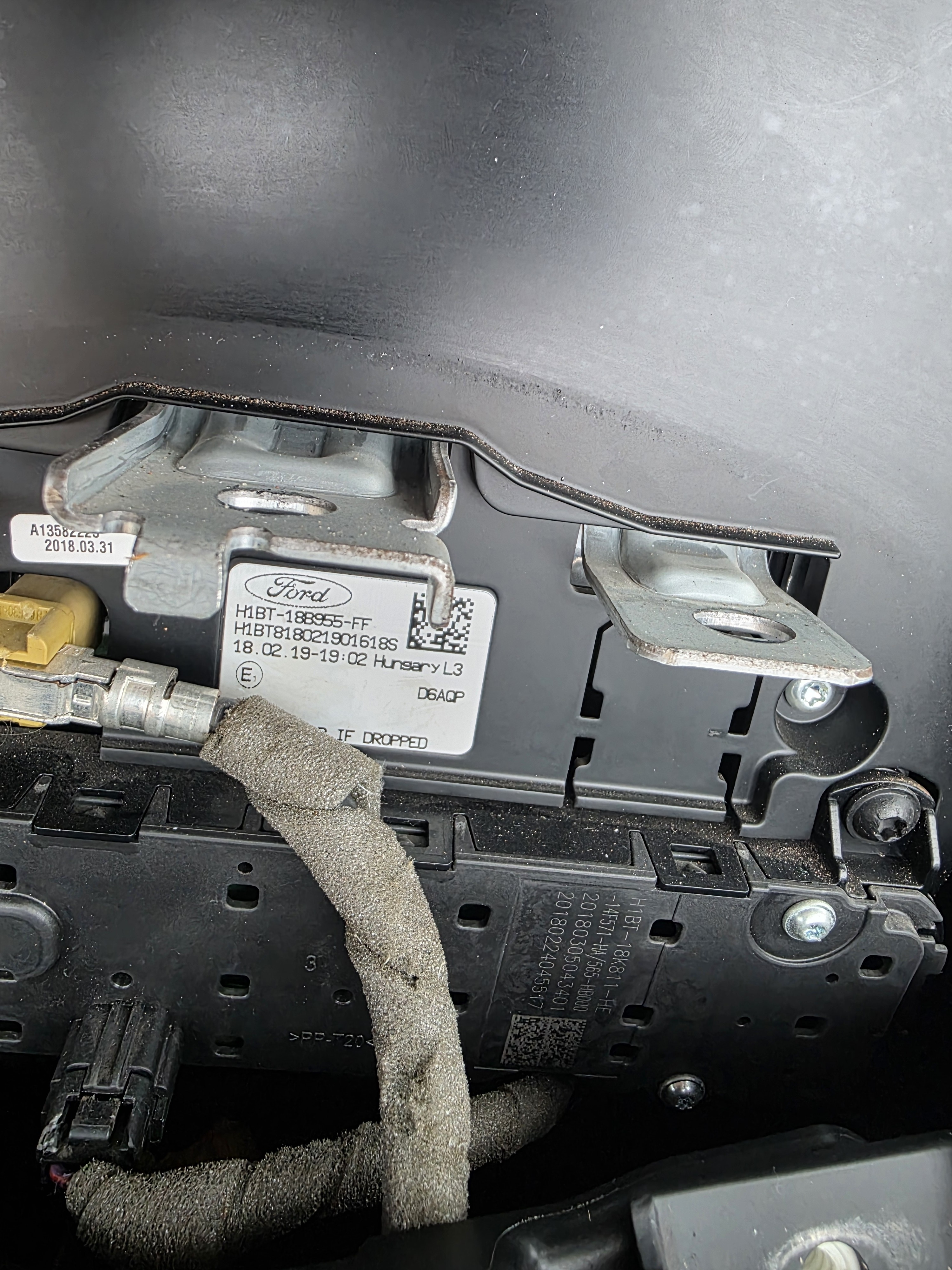

Thanks for the info. Is this the right sticker.

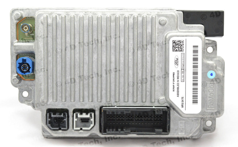

That’s not the APIM. This is what you are looking for:
Do you have to take all the trim off around the unit, if so how do I do that am not very good with motors as you can tell by the mess I have done with trying to updating thr unit
Likely. That part number is the for the screen. Your APIM is located elsewhere. Start by looking behind the glove box which is where it is found sometimes in a Ford Transit depending on the model. The other part of that yellow connector should be connected to the APIM.
If you do not want to mess with that, an alternative is for you to get an adapter and forscan, then read the part number without removing anything.
