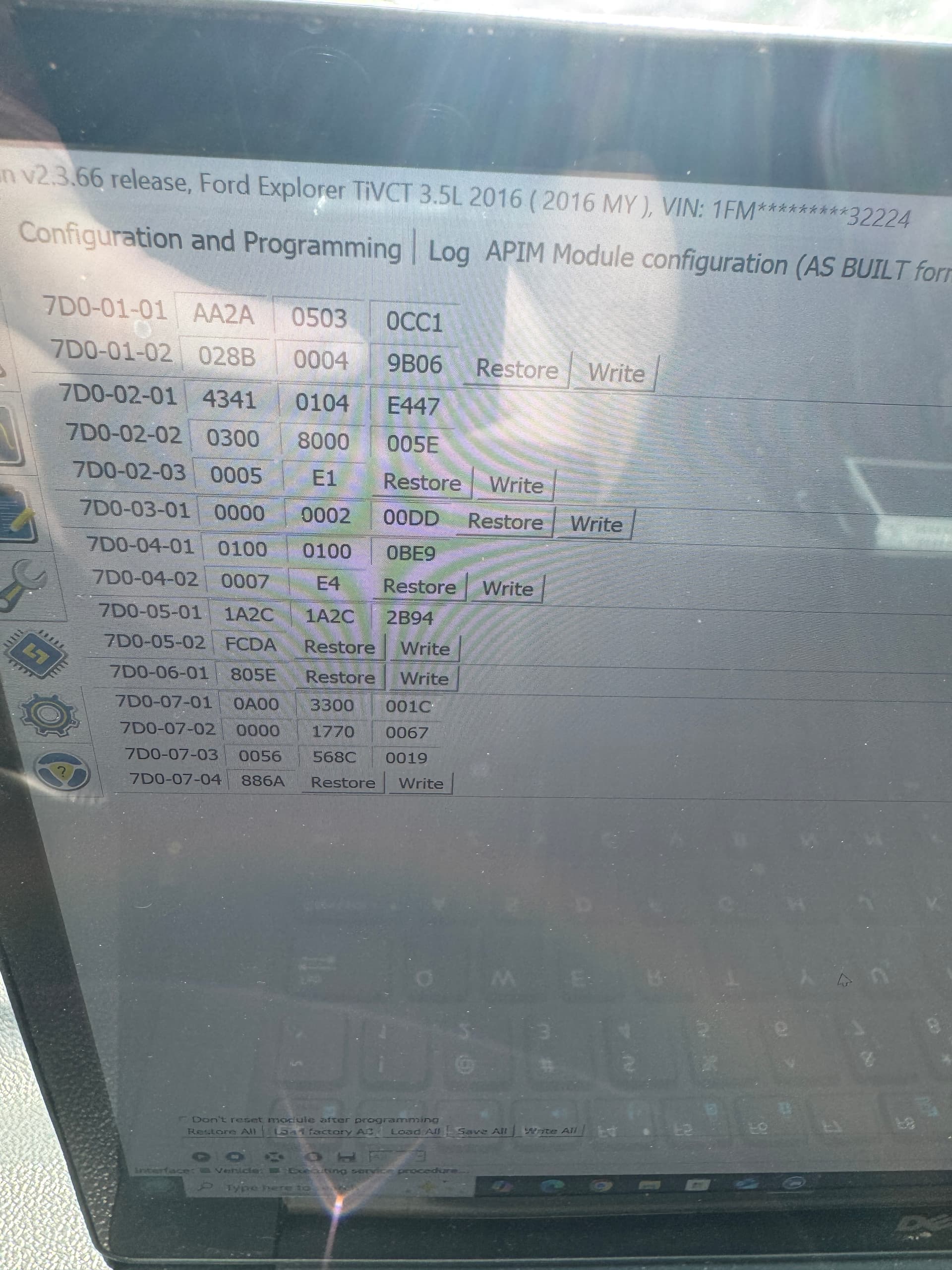

Here is my current APIM as built.

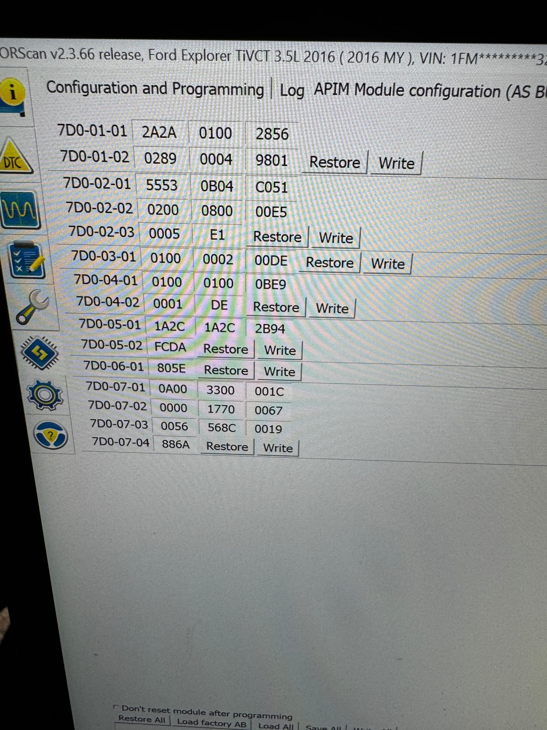

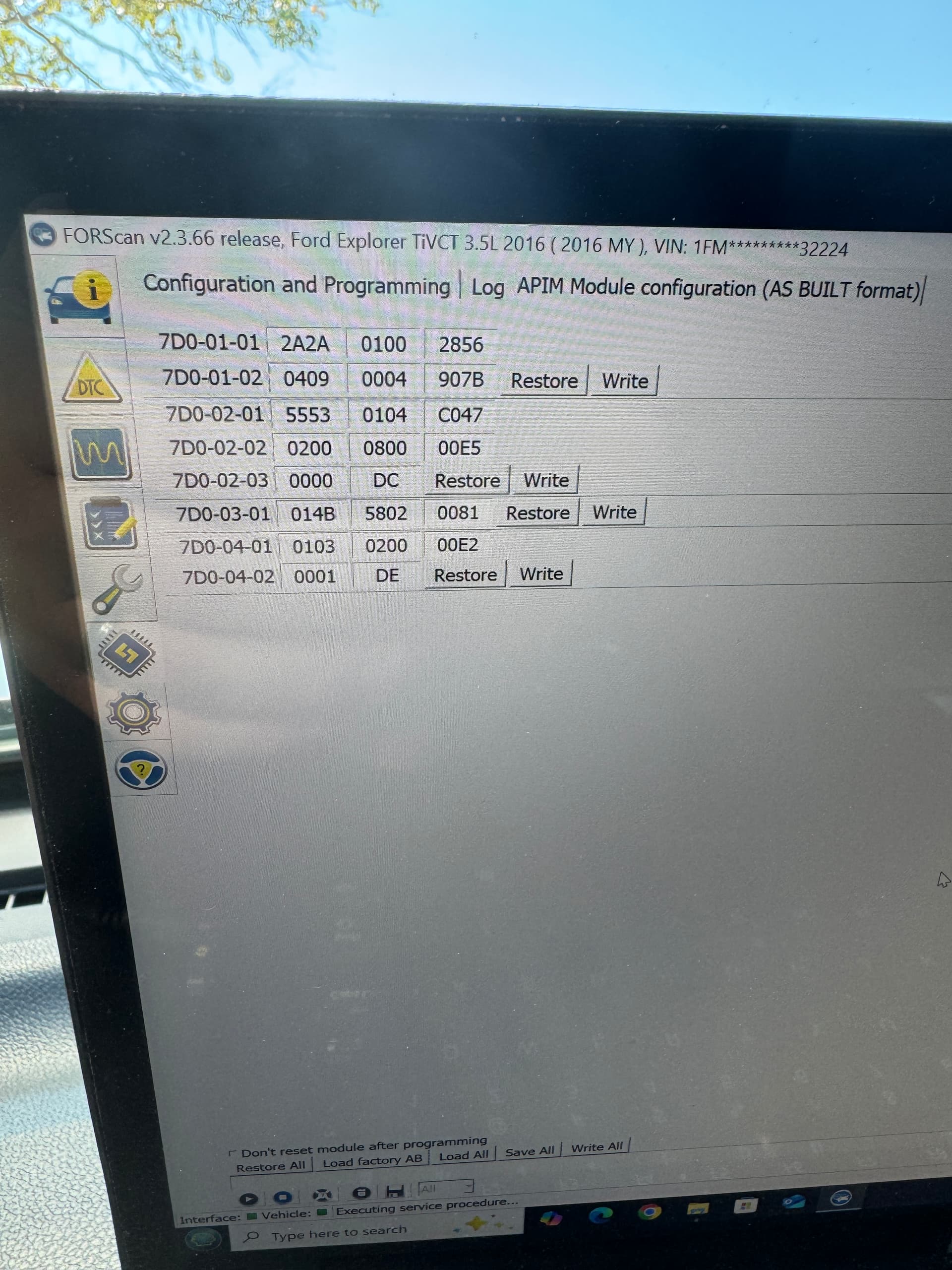

My original sync 2 As built
Sorry. This is the original APIM as built

The screen and APIM I’m using are actually out of a 2017 explorer platinum. The second as built photo I posted by accident is actually the as built from the 2017 explorer. What should I change that line to? I don’t have front parking sensors. That’s why I changed it to what it is now.
I changed 04-02-0001-DE to 0007-E4. Thats what the APIM was originally programmed as when it was in the 2017 Explorer platinum. No change.
Ok. I got it figured out. My mistake was in7D0-02-02. I changed from 0200-0800-00E5 to 0300-8000-005E. Now the enhanced park aid shows up on the backup camera.
