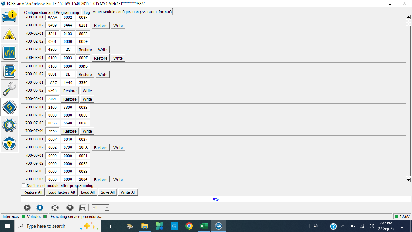

No Navigation voice commands
Upgraded Sync 2 to sync 3 on My 2015 F150 XLT. replacement unit came with Sync 3.4 build 23188 (APIM Module #LU5T-14G371-CKC). All worked fine except there are no navigation voice command, other command working fine. Reinstalled the same build with sync3updater . Did master reset couple of times with no help
SYNC Region: ROW
Old SYNC Version: 2.0
New SYNC Version: 3.4 23188
Operating System: Microsoft Windows 10 Home Single Language (2009)
Version: 3.4.23188
Region: ROW

here is the interrogator report:
?xml version=“1.0” encoding=“UTF-8”?>
<p:OTAModuleSnapShot xmlns:d2p1=“urn:ford/Vehicle/Module/Information/v3.0” xmlns:xsi=“http://www.w3.org/2001/XMLSchema-instance” xmlns:p=“urn:ford/com/productdesign/ipp/ModuleSnapshot/v2.0” version=“2025-09-21” xsi:schemaLocation=“urn:ford/Vehicle/Module/Information/v3.0 ModuleSnapshot.xsd”>
<p:VIN></p:VIN>
<p:RequestRole>
d2p1:RoleCONSUMER</d2p1:Role>
d2p1:RoleSourceOTA</d2p1:RoleSource>
d2p1:RoleDescSYNCGEN3</d2p1:RoleDesc>
d2p1:RoleIDOTA</d2p1:RoleID>
</p:RequestRole>
<p:BroadcastDTCType>
<d2p1:DTC DTCValue=“c1840008”/>
<d2p1:DTC DTCValue=“c20c000b”/>
<d2p1:DTC DTCValue=“c452000b”/>
</p:BroadcastDTCType>
<p:Node isFlashed=“false” specificationCategory=“GGDS”>
d2p1:Address7D0</d2p1:Address>
<d2p1:ECUAcronym name=“APIM”>
d2p1:State
<d2p1:Gateway gatewayType=“NONE”>
<d2p1:DID didFormat=“ASCII” didType=“Embedded Consumer Operating System Part Number” didValue=“8033” responseLength=“24”>
d2p1:ResponseNU5T-14G381-AD</d2p1:Response>
d2p1:IsConfigfalse</d2p1:IsConfig>
</d2p1:DID>
<d2p1:DID didFormat=“Packeted” didType=“Embedded Consumer Applications Part Numbers 1” didValue=“8060” responseLength=“384”>
d2p1:Response345535542d3134473432312d46424c000000000000000000355535542d3134473339312d465400000000000000000000345535542d3134473432332d464300000000000000000000315535542d3134473635382d414800000000000000000000000000000000000000000000000000000000000000000000000000000000000000000000000000000000000000000000000000000000000000000000000000000000000000000000000000000000000000000000000000000000000000000000000000000000000000000000000000000000000000000000000000000000000000000000000000000000000000000000000000000000000000000000000000000000000000000000000000000000000000000000000000000000000000000000000000000000000000000000000000000000000000000000000000000000000000000000000000000000000000000000000000000000000000000000000000000000000000000000000000000000000000000000000000000000000000000000</d2p1:Response>
</d2p1:DID>
<d2p1:DID didFormat=“Packeted” didType=“Embedded Consumer Applications Part Numbers 1” didValue=“8061” responseLength=“384”>
d2p1:Response000000000000000000000000000000000000000000000000000000000000000000000000000000000000000000000000000000000000000000000000000000000000000000000000000000000000000000000000000000000000000000000000000000000000000000000000000000000000000000000000000000000000000000000000000000000000000000000000000000000000000000000000000000000000000000000000000000000000000000000000000000000000000000000000000000000000000000000000000000000000000000000000000000000000000000000000000000000000000000000000000000000000000000000000000000000000000000000000000000000000000000000000000000000000000000000000000000000000000000000000000000000000000000000000000000000000000000000000000000000000000000000000000000000000000000000000000000000000000000000000000000000000000000000000000000000000000000000000</d2p1:Response>
</d2p1:DID>
<d2p1:DID didFormat=“HEX” didType=“ECU Checksum 1” didValue=“D704” responseLength=“4”>
d2p1:Response4b23195f</d2p1:Response>
</d2p1:DID>
<d2p1:DID didFormat=“HEX” didType=“ECU Checksum 2” didValue=“D705” responseLength=“4”>
d2p1:Response6709c808</d2p1:Response>
</d2p1:DID>
<d2p1:DID didType=“Direct Configuraation DID DE00” didValue=“DE00”>
d2p1:Response2aaa000243042b0004aa</d2p1:Response>
d2p1:IsConfigtrue</d2p1:IsConfig>
</d2p1:DID>
<d2p1:DID didType=“Direct Configuraation DID DE01” didValue=“DE01”>
d2p1:Response54430103c00209800000c405</d2p1:Response>
</d2p1:DID>
<d2p1:DID didType=“Direct Configuraation DID DE02” didValue=“DE02”>
d2p1:Response0000000100</d2p1:Response>
</d2p1:DID>
<d2p1:DID didType=“Direct Configuraation DID DE03” didValue=“DE03”>
d2p1:Response00000800000001</d2p1:Response>
</d2p1:DID>
<d2p1:DID didType=“Direct Configuraation DID DE04” didValue=“DE04”>
d2p1:Response1a2c1a403368</d2p1:Response>
</d2p1:DID>
<d2p1:DID didType=“Direct Configuraation DID DE05” didValue=“DE05”>
d2p1:Responseb0</d2p1:Response>
</d2p1:DID>
<d2p1:DID didType=“Direct Configuraation DID DE06” didValue=“DE06”>
d2p1:Response210033000000000000000056569b0076</d2p1:Response>
</d2p1:DID>
d2p1:ResponseDS-1U5T-14G371-EH</d2p1:Response>
</d2p1:DID>
d2p1:ResponseGU5T-14G380-EE</d2p1:Response>
</d2p1:DID>
d2p1:ResponseLU5T-14G371-CKC</d2p1:Response>
</d2p1:DID>
d2p1:Response1U5T-14G375-DA</d2p1:Response>
</d2p1:DID>
d2p1:ResponseVYC21495</d2p1:Response>
</d2p1:DID>
d2p1:ResponseBlank</d2p1:Response>
</d2p1:DID>
d2p1:Response03</d2p1:Response>
</d2p1:DID>
d2p1:Response1U5T-14G374-EH</d2p1:Response>
</d2p1:DID>
<d2p1:DID didFormat=“ASCII” didType=“ECU Serial Number” didValue=“F18C” responseLength=“16”>
d2p1:Response</d2p1:Response>

There is still one dtc code stored in the APIM that I wasn’t able to clear thru forscan which is U0452:00-0B
Invalid data received from RCM.
Tried resetting RCM and APIM modules thru forscan with no help.
What is the relation between RCM and APIM?
Please see attached Apim Current setting.
Thank You.
The is caused by a setting in the RCM that tells the APIM when there has been a crash and to dial emergency services. Once this is fixed on the RCM side it will go away or it needs to be turned off on the APIM side.
Thanks for your reply.
Would disabling Ecall in APIM as built probably fix the issue?
Yes it would, or enabling the signal in the RCM would also. Basiclly the APIM wants that data becuse it’s turned on and becuse the RCM is not set to send it your getting the DTC. Like you mentioned turning it off that would fix it.
