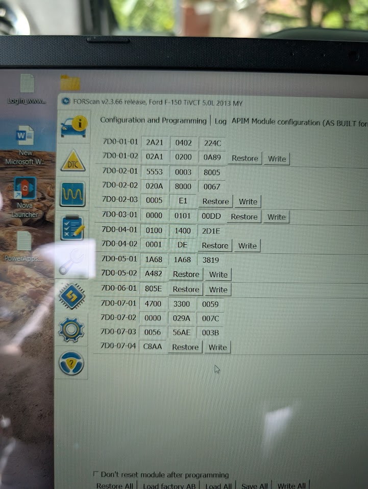

Based on the pic you posted above…
You say you have a Sony Premium audio system? Your Sync 3 APIM asbuilt indicates otherwise. The Sync 2 APIM asbuilt would be appropriate.
Sync 2:
7D0-01-01 A221 9001 E20F
Sync 3:
7D0-01-01 2A21 0402 224C
If you have the Sony DSP, you should have the Sync 2 settings for A221. Or AA21 if you have the rear camera displayed in Sync.
The rest of the line should be A221 0102 22xx. (xx = the checksum bits, let FORScan calculate and write those.)
Suggestions:
7D0-01-02 should read 0281 0204 0Axx
7D0-02-01 should read 5553 0003 00xx This line needs to be changed to this…
7D0-02-02 should read 0200 8000 00xx
7D0-02-03 0005 E1
7D0-03-01 0000 0101 00DD
7D0-04-01 should read 0100 1400 0Exx
7D0-04-02 0001 DE
The rest looks ok.
But the first line looks like it might be the issue, but, if the volume control is working now and the DSP is working I can’t see how with the 2A21 code.
