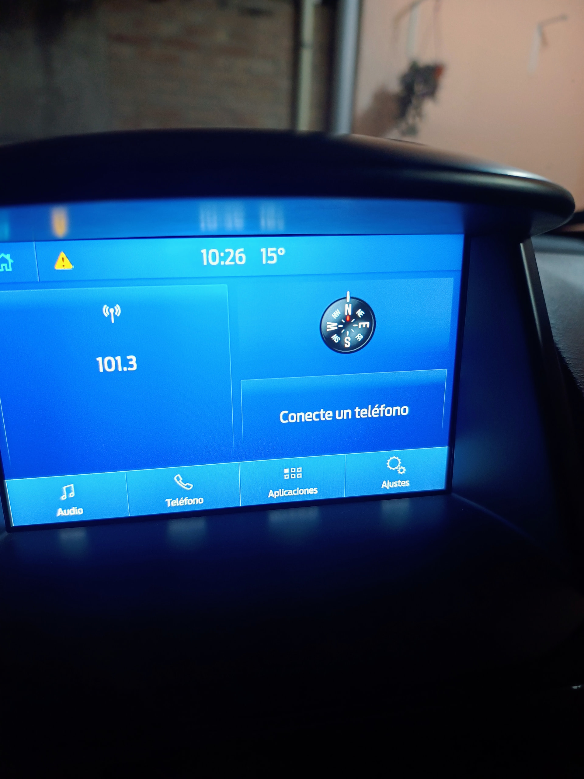

Out of curiosity, how does the compass work? sync 3.4
I’ve updated Sync 2 to Sync 3.4; it’s an APIM without navigation. The screen has a compass that doesn’t work. I don’t really need it, but I wanted to know what makes it function. Is there a setting or does it require a cable?
SYNC Region: ANZ
Old SYNC Version: 3.0
No, ninguno
No lo tengo
It requires an additional GPS antenna.
