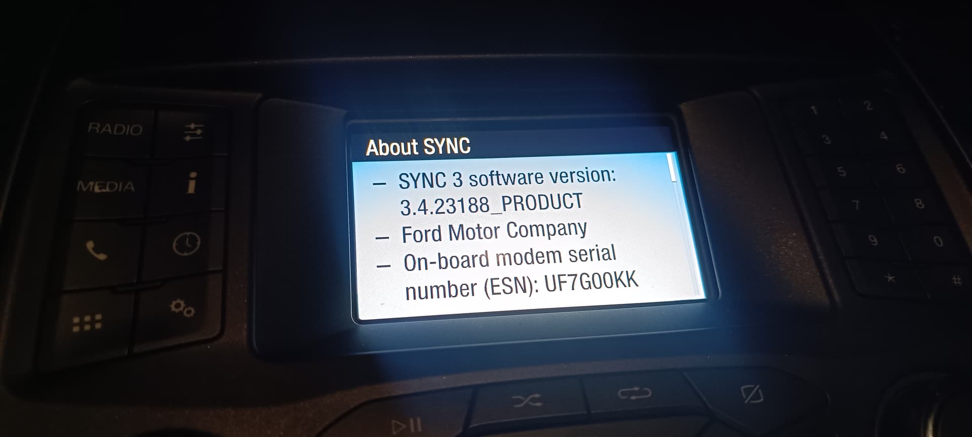

Problem with 4 inch screen after update
It worked fine before the update – see attached photo. I re-uploaded the file with the BB extension, disconnected the battery, restarted with the buttons, and restarted with ForScan – no improvement. I found a post with the opposite situation (link) , showing SW: NU5T-14G381-BD. It’s not in the Cyanlabs database; I downloaded it from another source, but upload ends with a “PKG_” error.
