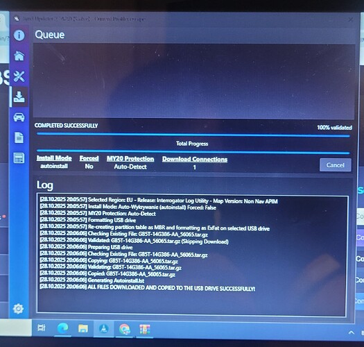

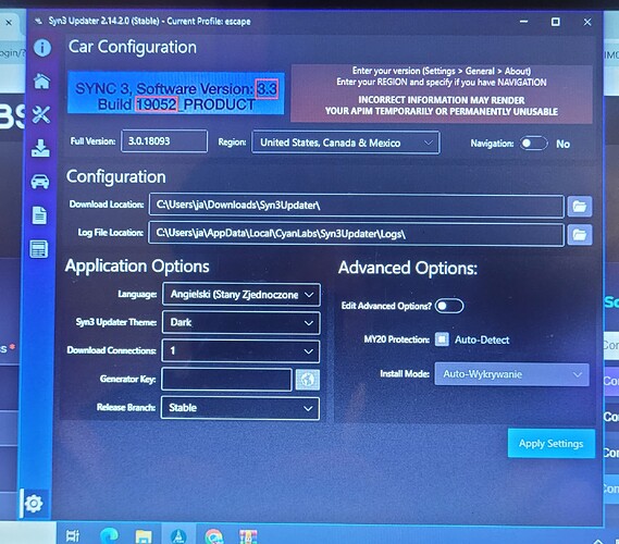

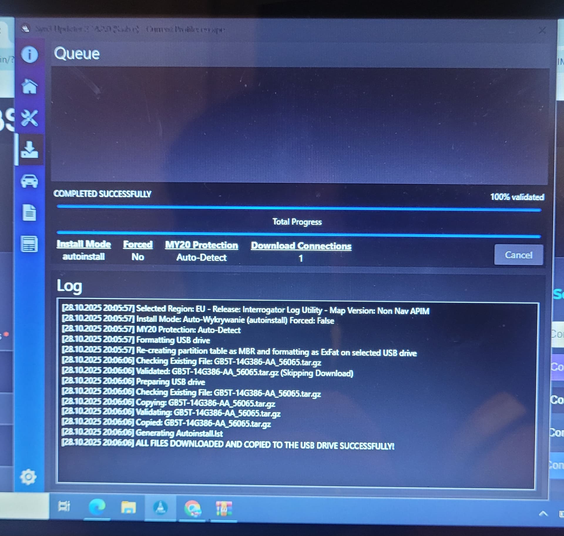

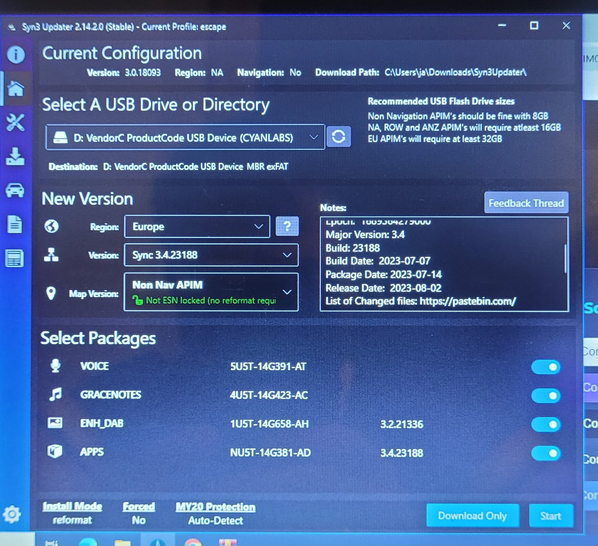

Hello. I want to update Sync 3.0 to 3.4 without navigation in a 2018 Ford Escape. I’ve already done this in my other Ford, and everything went according to the instructions. There seems to be a problem here. I’m doing everything as shown in the pictures. I need to change the region from USA to EU. I start creating a flash drive, and it takes a very short time, about 3 seconds, and I get a message that the process was successful. I think it should take about 15 minutes. The flash drive is almost empty, and it should take up about 8GB. I haven’t tried inserting the flash drive into the car.
Old SYNC Version: 3.0.18093

Hello.

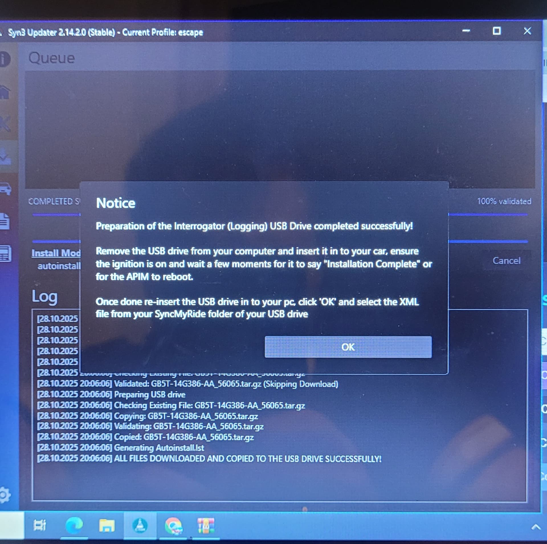

Take a look at the Basic Usage - CyanLabs documentation, you are only running the interrogator log.
Thank you very much for the tip. I was too influenced by how it looked in the previous car. The process of creating a USB drive has probably changed recently, because the previous car didn’t include this step of checking the current Sync version in the car. Now everything works according to the instructions. The USB drive is ready. I’ll install it in the car tomorrow. Thanks again for your help.

The other issue you may have if this is a US vehicle imported to the EU is that the US non-NAV APIMs only have 8Gb of storage, the EU units have 16Gb due to the additional languages.
the created USB is 3GB
