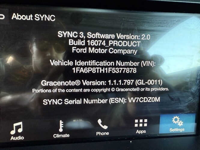

I am in the process of upgrading my sync3 to 3.4 from the current 2.0 software on it. I used to live in the states and the car is a US Mustang with a US purchased sync3 hardware upgrade kit (I used to have a sync2 from the factory being a MY2015). As of now i live in Europe (Italy). So my question at this point is, what region do i select when generating the files and configurtation? do i choose “NA” being it a US mustang or do I select “EU” phisically where I am now? sorry if the question might seem dumb, but I honestly don’t know if there are any gotchas.
Install Type: OEM Replacement
Old SYNC Version: 2.0
no error message

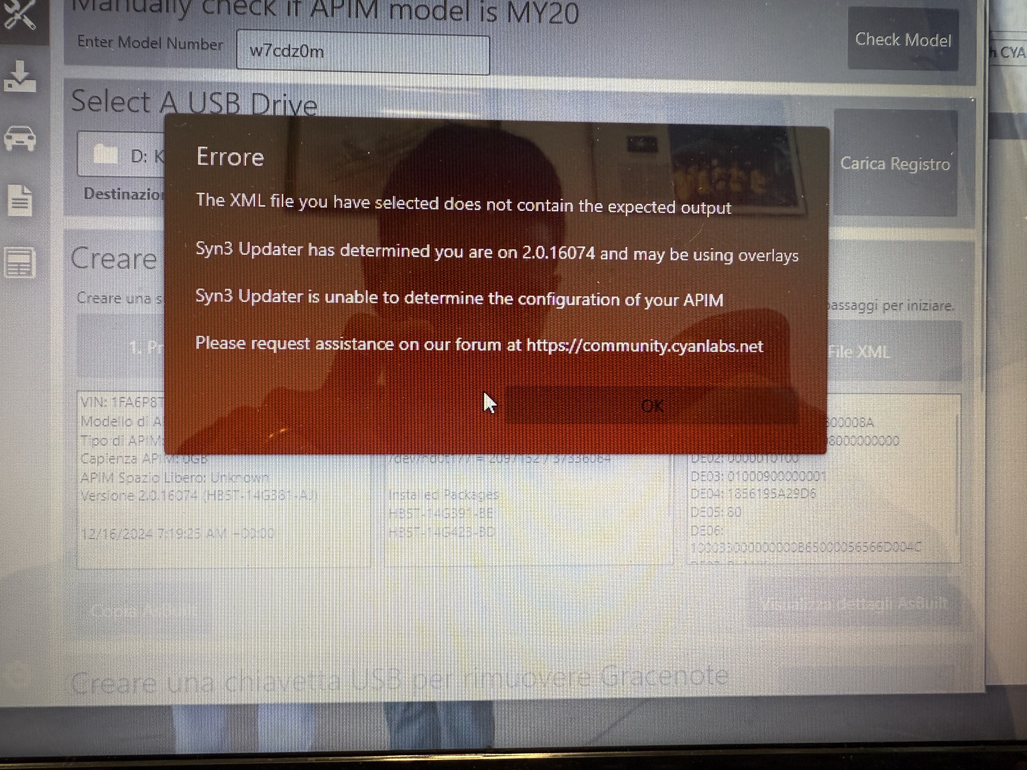

I also noticed this pop up after I selected “open interrogator log”
Just paste the file here…
