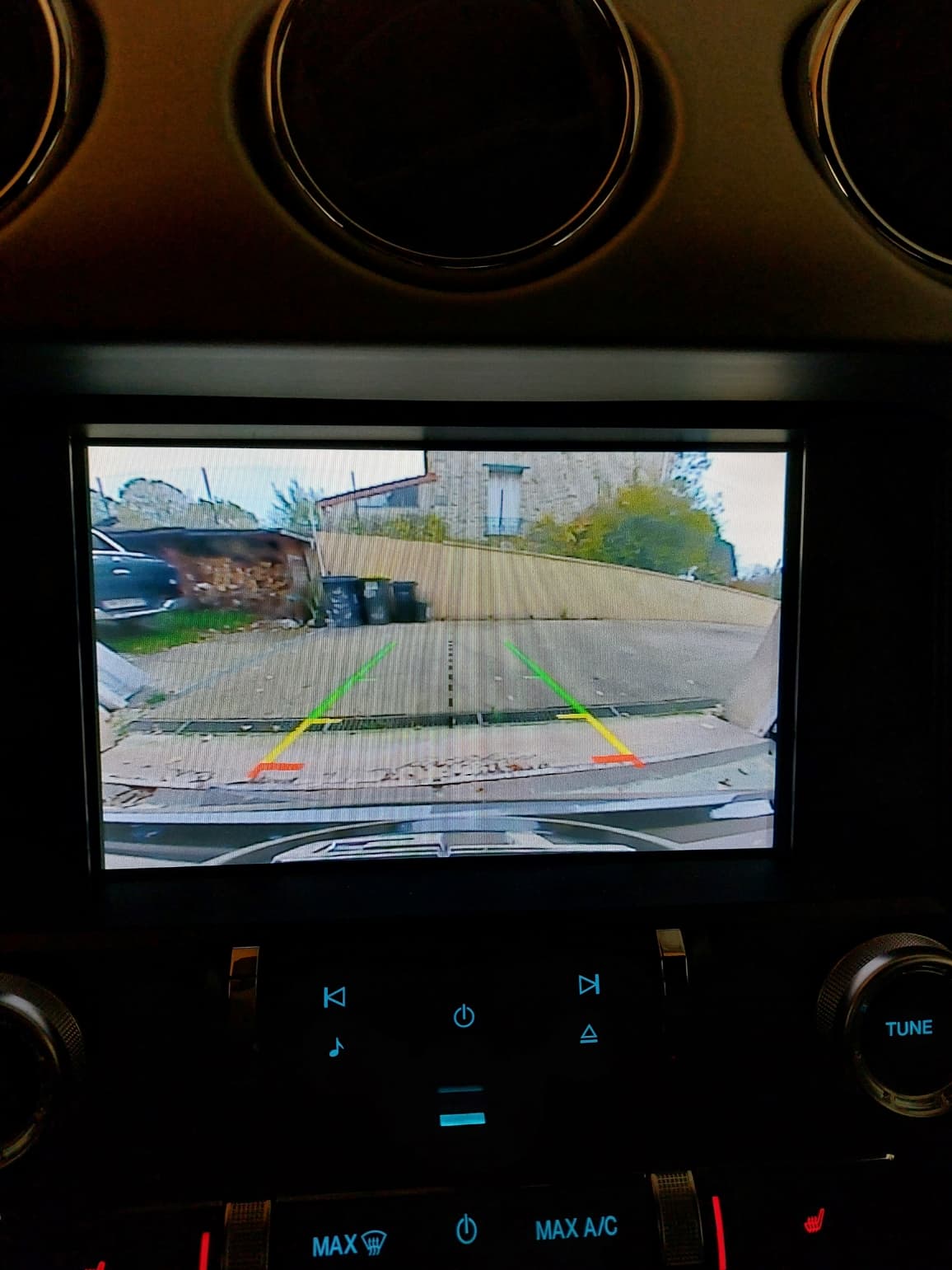

Hello everyone,
the car icon on the reversing camera that indicates the position of obstacles when reversing has disappeared from the screen. Does anyone have any idea how to get it back?
Thanks, have a good day.
Frédéric

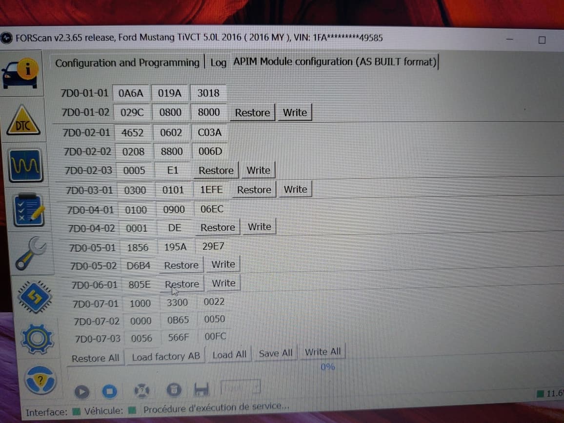

I’ve attached a photo of the screen.

Time to re do the programming. Do you have a backup asbuilt from before upgrading Sync3 versions?. If so, install that and force a module reset.

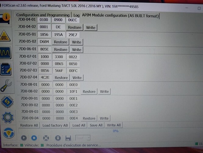

If that does not work (or you do not have the backup), send a screenshot of the APIM asbuilt seen through Forscan.
It’s expected for some values to be reverted after a reformat, for example.
Here are the photos, thank you for your help.

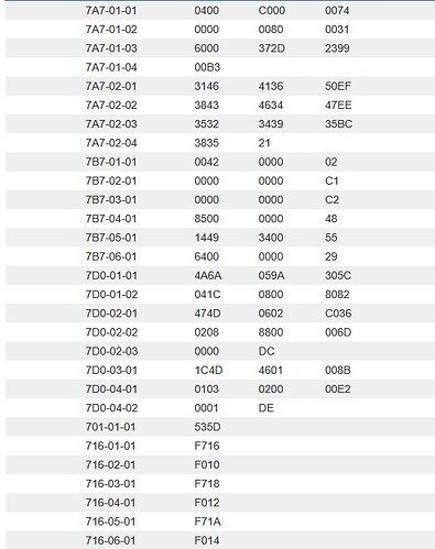

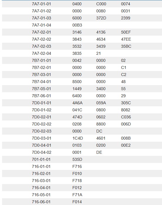

Do you have the original Sync 2 asbuilt?
I hadn’t saved it, but I retrieved the file using my VIN from Ford Service Info.
If you can’t open the file, I can take screenshots.
1FA 585.ab (22.6 KB)
Your first line of the APIM asbuilt should be : 7D0-01-01 4A6A 059A 305C
Reset the APIM once you write the values.
You had previously done other work on the Mustang. APIM and ACM swap…
Yes, I made those changes with your help. And I did modify 7D0-01-01 4A6A 059A 305C, but it didn’t change anything.

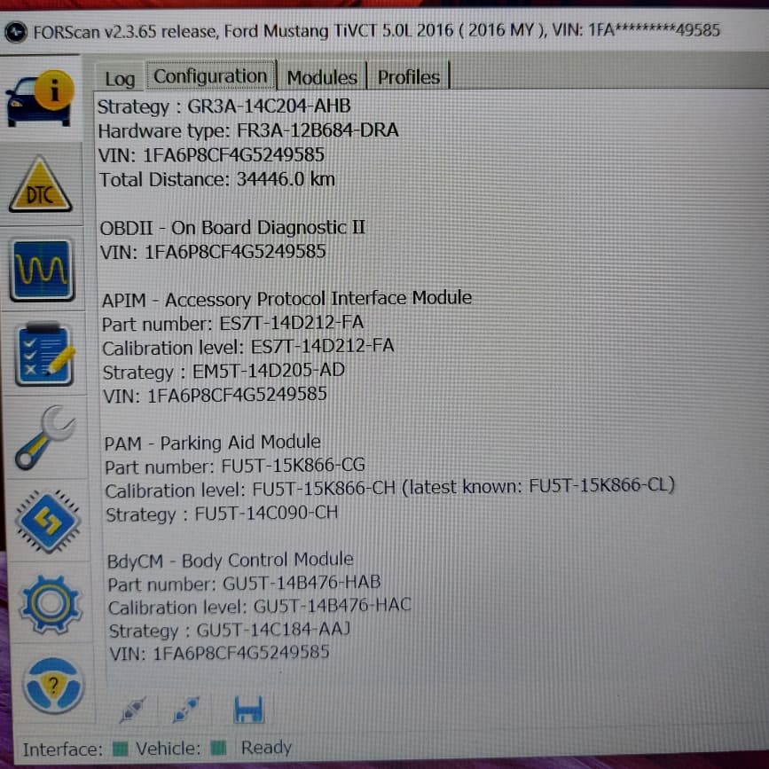

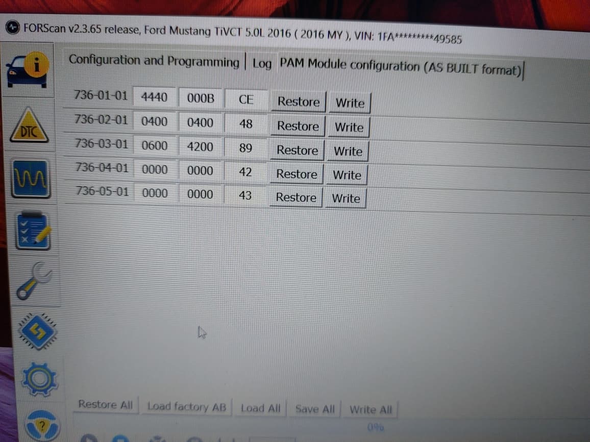

I just saw in the PAM database that modifications are required when replacing Sync 2 with Sync 3. My car’s PAM is still the same as the original; do I need to make any modifications?
Only if you have the latest PAM firmware. There is a value that will indicate Gen 3.
736-03-01 xxxx xx** xx
Increase the value to 18=OAT FCIMA, CAN None, APA Sync Gen 3 APIM.
Thank you for your help.

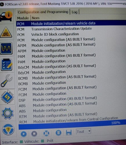

Oddly enough, I don’t have access to the update tab on Forscan (see photo). Therefore, I don’t know what the firmware version is. I’ve also attached a photo of the PAM profile.
Odds are your PAM is part of the BCM since you have a CGEA 1.3 network.
Okay, thanks, but what should I do? Sorry, I have very little knowledge in this area :wink:
