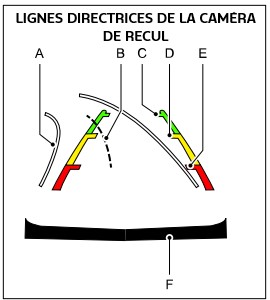

Otherwise, I just programmed an ABT file that F150Chef provided me a few months ago, and the radar icon is back. The only problem is that the guidance system that shows the direction and the rear limit is no longer active on the screen…
You should update the PAM to version -CL.
You need to drive the vehicle for a bit for the system to relearn for the guidelines…
