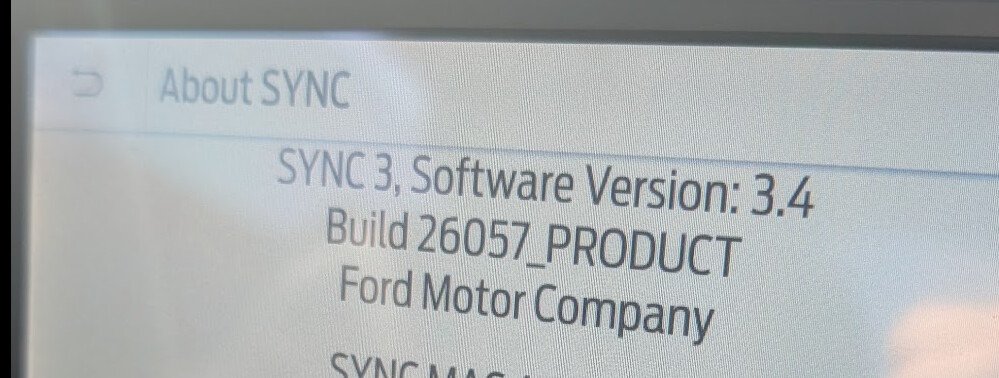

Ok so update: Checked back in on the car, (having ignored the keep usb inserted popup after the greenscreen) and it seems ok? Oddly its gone to 26057 when I’m sure I picked 23188 this time… but maps are now F13 and sync system appears to be fully functioning. So I guess the conclusion from all this is remove when prompted at greenscreen, and don’t put it back in when the car pop up implies you should…!(?). Leaving this here for now in case anyone else encounters this or has a contrasting view!
Ok I definitely picked 23188 from the sync app disk builder - I’ve checked the log (attached) which refs Sync 3.4.23188 EU. So how does the car now reckon its on 3.4.26057? And which is it really on? @CyanLabs please help - not sure if a side effect of the previous install attempts despite master reset? And any insight you can give about the “keep usb inserted” popup after the first reboot from greenscreen and the impact of me not doing that this time would be much appreciated!

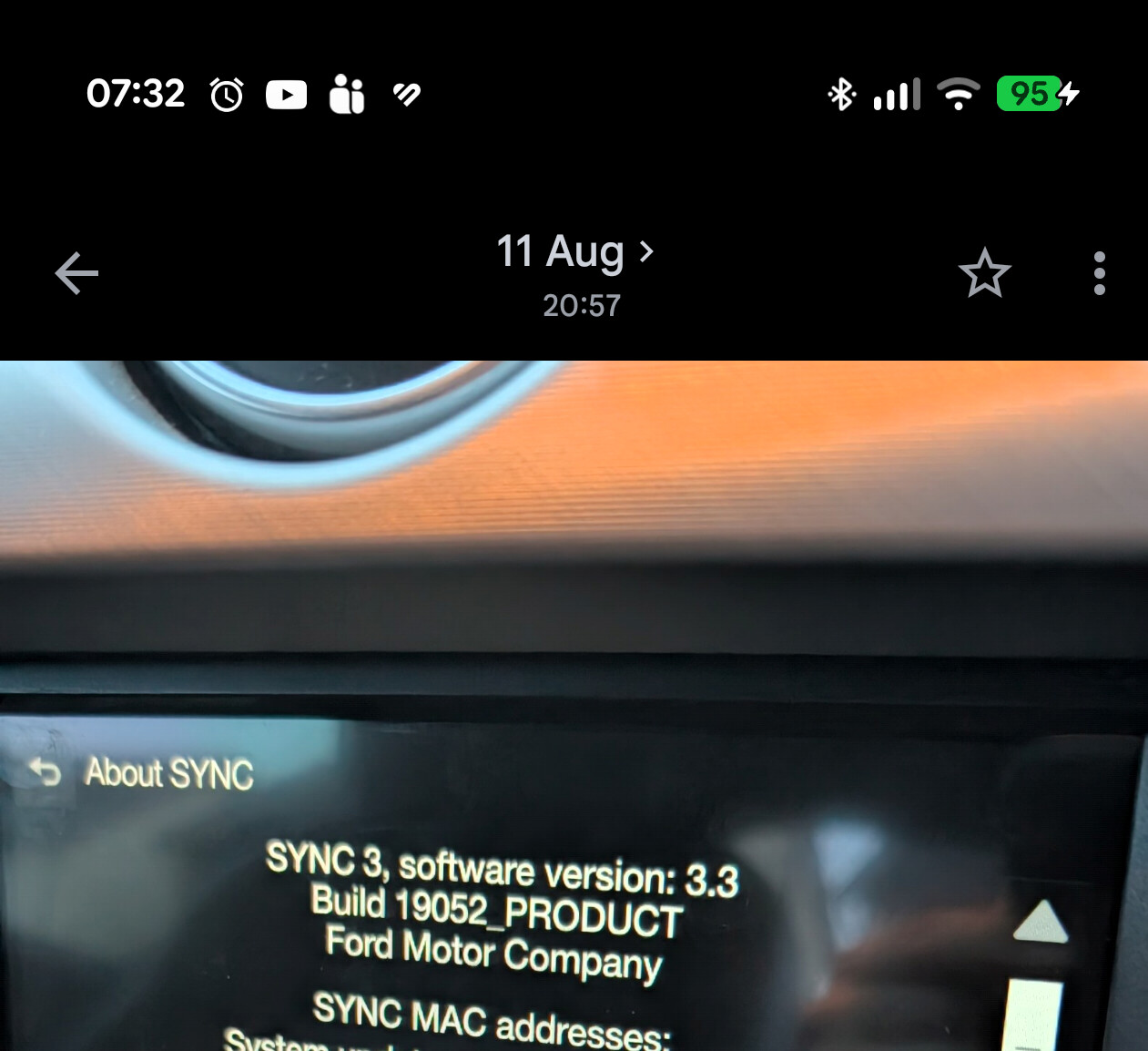

Reading your log I would suggest it is because you showed your current version (previous configuration) as 3.3.19052 instead of what your screen actually shows (3.4.26057) and confused the system so it did not go back to your desired 3.4.23188.
Apparently your system eventually accepted your original attempt at updating to 3.4.26057 perhaps due to factory resets, several engine restarts or whatever so why not run with it as you now have the latest update along with maps F13 and all seems to be working ok?
I have had 3.4.26057 in my 2017 model installed through Cyanlabs since it was released and it works fine.
Who knows why you had these issues updating as technology can do wonderful and weird things and often it is trial and error regarding removal of the thumb drive to achieve success but the norm is to remove it after the second and final message at the end of installation. :winking_face_with_tongue:
It was actually on 3.3.19052 as per the config though when I did that last attempt (as shown in the attached, if replying as email and adding attachments works) aa this was after I did the base level emergency recovery.) .
Like basically looking at the downgrade installation steps that the app presents after building the USB drive, I seem to encounter them in a different order. So I got steps six and seven leading to the green screen reboot before then getting steps 1 through 5 which are the installing update screens whilst still in the sync interface and keycycle messages.. all very odd!
So what version do you have now and is it all working ok?
3.4.26057, but that’s the next part that doesn’t make sense. It has been through the emergency recovery from eccm flash screen to 3.3, followed by the then specific new usb made to go from 3.3. to 3.423188 - so how the car reckons it is now 26057 is beyond me and why I tagged @CyanLabs in the hope they may understand how this behaviour is possible when the usb didn’t contain that release etc. Cheers
Regardless of whether it makes sense or not your original post indicates you were trying to update from 3.4.23188 to the latest 3.4.26057 as I read it and that is what it has eventually done regardless of all your attempts to downgrade or alter the version etc.
If it shows 3.4.26057 on the screen now then that is what you have even though there is ‘reasoning’ that it should not be there now after your attempts at changing it as apparently this was your original intention as I mentioned earlier.
Who knows why software behaves this way? If it functions ok don’t worry about it. If you wish to go back to 3.4.23188 or any other late version for some reason just show 3.4.26057 as your previous configuration and then show your desired prior version as your target version on the updater but you are no doubt aware of this.
