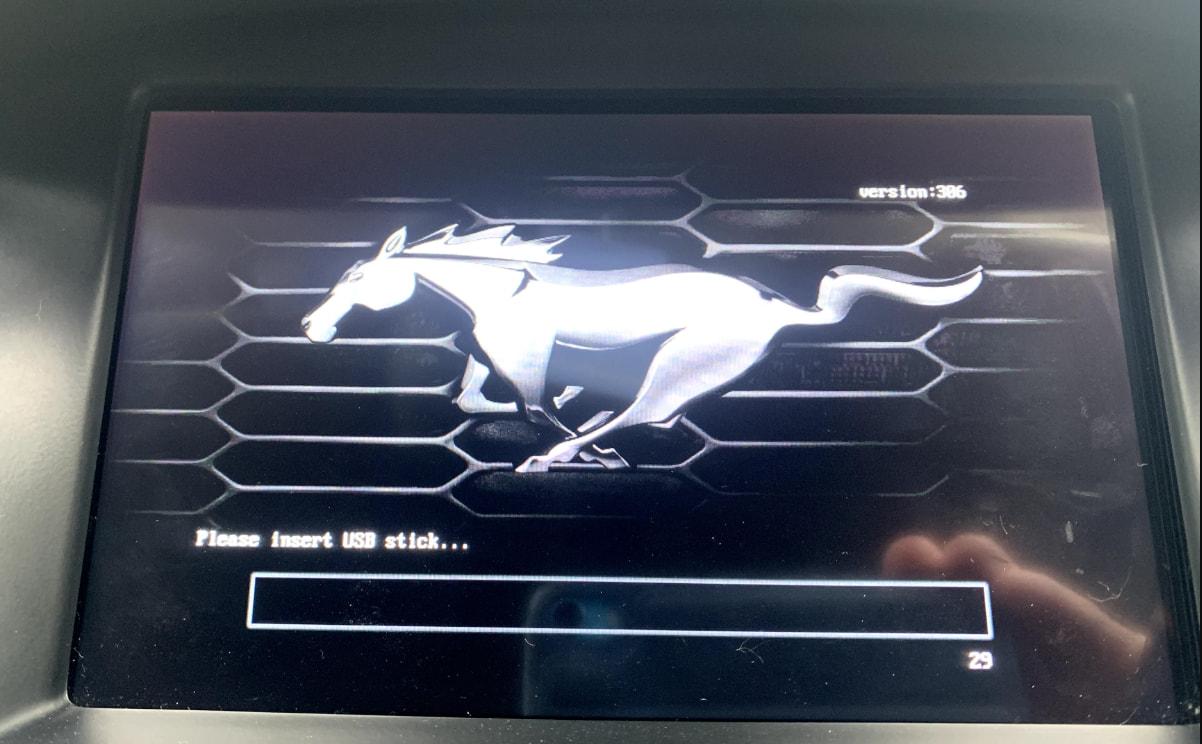

Stuck on "insert USB stick"
Hello, I formatted my USB stick via the most current version Syn3 Updater. I followed the instructions and left the usb inserted in the truck without removing it. I got the pop up stating that the updated would be performed, but when I got to the actual update screen it said “insert USB Stick” almost immediately. I am now stuck on that screen no matter how many times I wiggle the USB around, turn the truck on or off, remove and reinsert the usb in both ports, and reconfigure the same usb stick again to retry. Any help is appreciated!
Old SYNC Version: 3.0.17194
Please Insert USB Stick
  Version: 3.0.17194
  Model: SanDisk Cruzer Glide USB Device
  MAP=4U5T-14G421-CJD_1615428865000.TAR.GZ
  MAP=4U5T-14G421-CHD_1615428793000.TAR.GZ
  MAP=4U5T-14G421-CGD_1615428721000.TAR.GZ
  MAP=4U5T-14G421-CFD_1615428639000.TAR.GZ

  [1/25/2026 8:04:59 PM] Selected Region: NA - Release: Sync 3.4.23188 - Map Version: 2.20 (2020) - NA
  [1/25/2026 8:04:59 PM] Install Mode: Auto-Detect (reformat) Forced: False
  [1/25/2026 8:04:59 PM] MY20 Protection: Auto-Detect
  [1/25/2026 8:04:59 PM] Formatting USB drive
  [1/25/2026 8:04:59 PM] Re-creating partition table as MBR and formatting as ExFat on selected USB drive

  [1/25/2026 8:36:46 PM] ALL FILES DOWNLOADED AND COPIED TO THE USB DRIVE SUCCESSFULLY!
What made you decide the vehicle wasn’t a MY20 vehicle?
Try a different USB stick.
Hi.
What does screen look like?, something like this?
If so, make sure the upgrade USB is the only device connected to the unit, double check other ports and if your car has an SD for maps, remove it as well.
