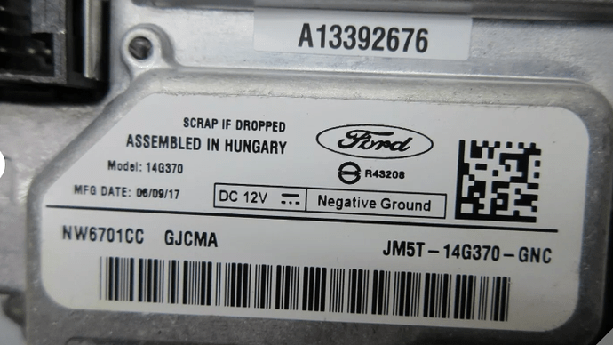

HI, I just got this Nav APIM on EBay from a Focus RS. Model: JM5T-14G730-GNC.
I am trying to understand if it is a My20 version. The database on this website and the My20 utility on Sync3 updated software only covers “14G731” models, while mine is “14G730”.
Is there a way I can check is my APIM is My20?

  1. the sticker of the APIMreports: MFG date: 06/09/17 (maybe this is the manufacturing date?)

Look at the sticker on the back of the APIM…it’s probably a JB7T-14G371-FDC.

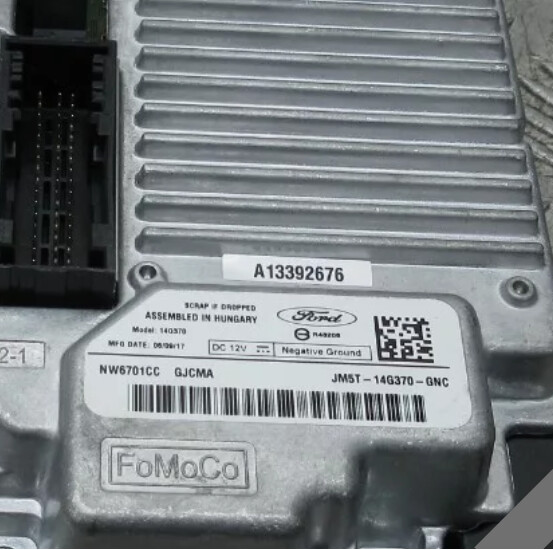

isn’t the picture I attached the sticker on the back of the APIM?
The code seems to be JM5T-14G730-GNC
Take the screen off the APIM and look at the back side of that module.
That looks a fake one to me, but I could be wrong.
14G370 is the assembly, 14G371 is the APIM itself.
Have you connected it to your car?. If so, try running the interrogator log against it, or go into bezel diagnostics to see what model it is.
Thank you man, I used bezel diagnostic to check the APIM version.
The sticker I shared was actually the serial number of the casing :relieved_face:
Once I had the APIM serial from bezel diagnostic, it turned out to be NOT MY20!
Thank you all for your support
Manufacturing date shows 2017 so there is no way it could be a 2020+.
