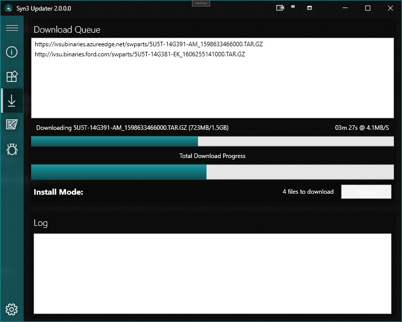

A redesign of Syn3 Updater using more modern technologies to handle DPI scaling etc is coming soon.

Not taking any feature requests right now but once v2.0 is done i will be happy to… right now it’s getting there :slight_smile: , sneak preview
