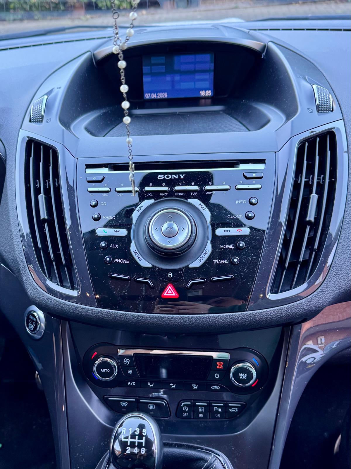

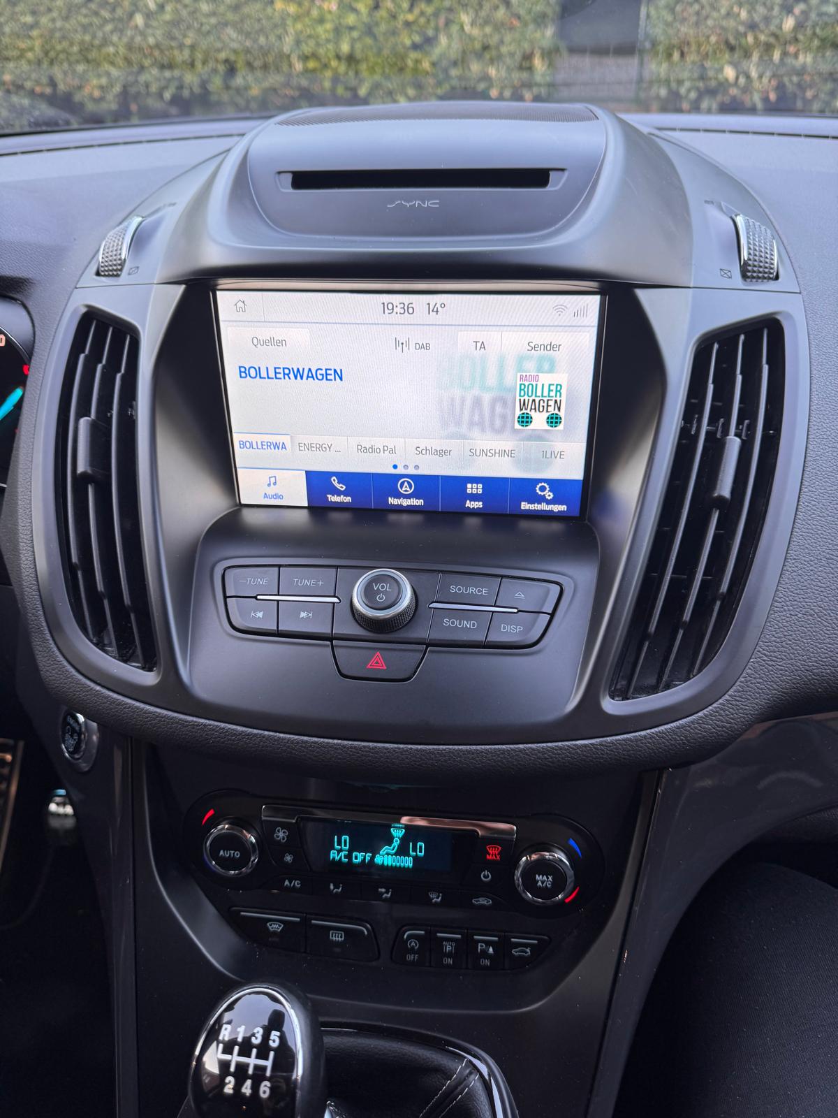

I’m from Germany , my English is Not the best i Hope you unterstand my Problem.
I Build my Kuga 2014 from Sync 1.1 to Sync 3.0 . I update with Cyan Labs on 3.4 all Works Perfect. Only one thing is gonna make me Problems.
You can push on the Steering Wheel the Button For Voice command. Sync give you Only Feedback on Display without any Voice. You can wait the Green Bar comes. I speak call my darling → Sync Works . but i have no Voice Feedback from Sync Like (Sync one command please )
Sorry For my Speeling fails.

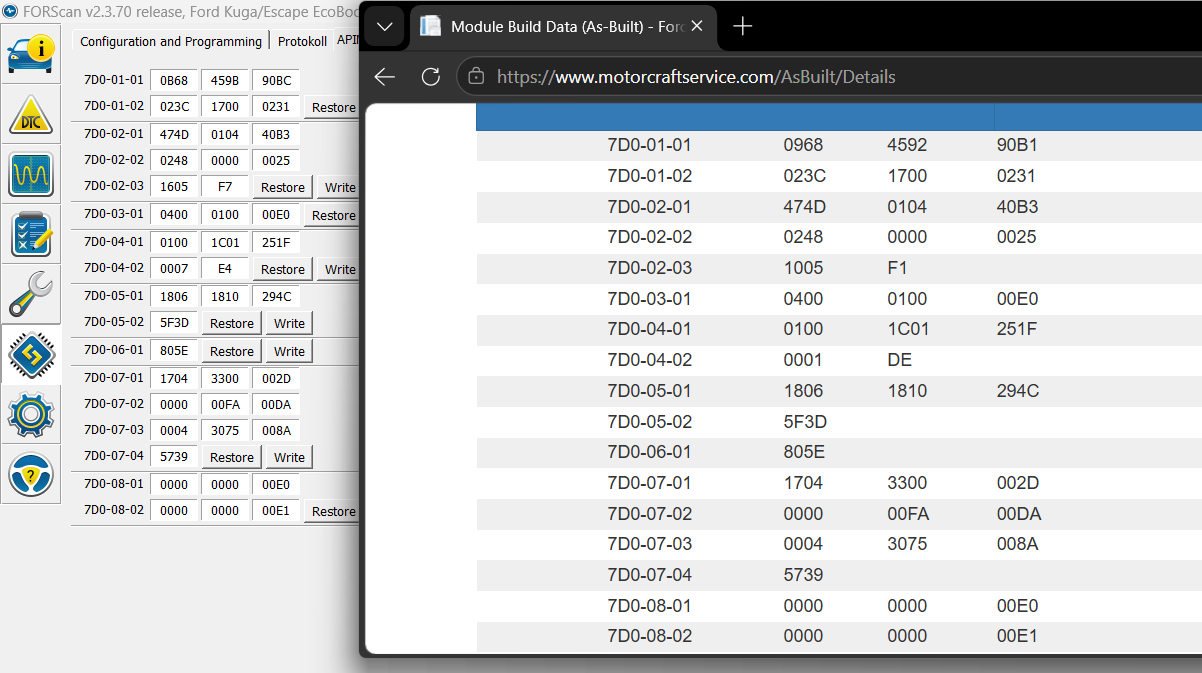

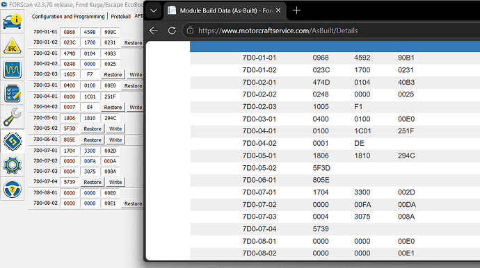

The actual APIM AsBuilt config has an error in it.
Where did you source the APIM from, what was the donor and who did the custom config of the unit?
Thanks For your Message . I made the custom config by my Self with FORScan . The donor was a Kuga from 2018. i got the vin. I can Write the as Build again.I’m not sure if I can do that so easily, because I also upgraded to update 3.4. I don’t want to damage the APIM.
Changing the AB won’t damage the APIM.
You DON’T want to use the full AB from the 2018 as a base due to differences in the cars’ modules. Look for one from the 1st year the Kuga had Sync3 (here in the US the Escape got it in 2016) and download the AB from the Kuga VIN that you locate from https://www.motorcraftservice.com/Asbuilt/ that will get you closer.
Also you can publish the current AB you’re running here and we can look at it
Thanks for your offer. On the left you see the data from my APIM , which is installed and adapted to my vehicle, and on the right are the original, as-built data from the APIM . I have activated the reversing camera, DAB radio, and parking sensors in my control unit. DAB station logos are displayed, but FM stations are not yet, I’ve noticed that too. The sleep mode also works. Unfortunately, I only have the chassis number of the donor vehicle. In Germany, Sync 3 was installed in the Kuga starting in 2017; Sync 2 should have been introduced here by 2015-2016.
by the way Thats is my upgrade. “Bollerwagen” is a German DAB radio station.
Not sure if you tried tapping the volume up button during the time when you should be hearing the SYNC3 voice. The volume for the different SYNC3 functions are different and can be adjusted individually.
Thanks For your Message. Ja i try this before i Post something. Navigation Volumen is working Perfect also.
Today i write the complete as build from the APIM and Load it + factory reset. Nothing. Voice control zero voice. Maybe package on Voice control on the updater 3.4 wrong ?

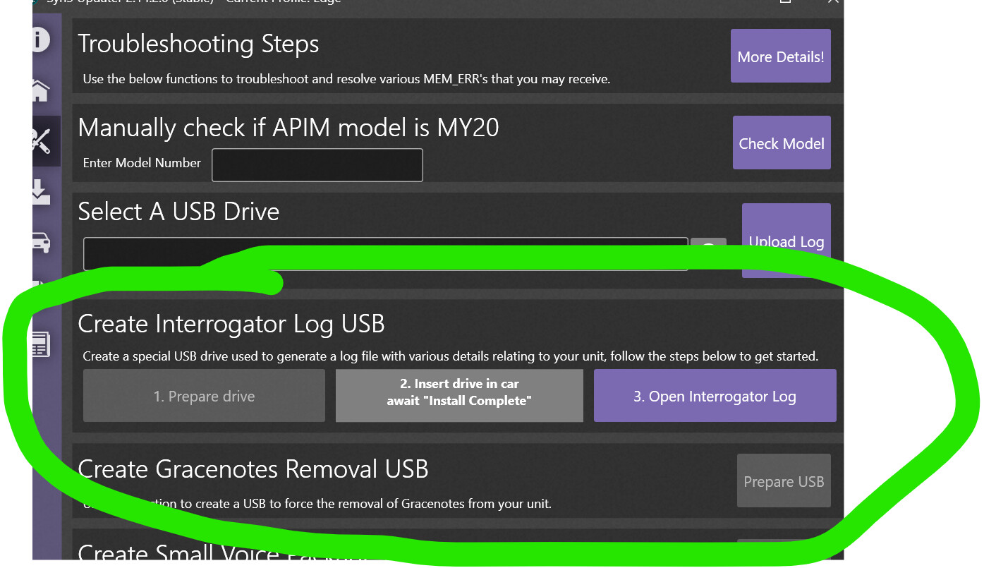

Have you run the Interrogator Utility to ensure the voice files are actually installed and the versions? The 474D code is correct for Germany. You could reload the voice file seperately again.
The -AT voice file includes the following languages…
ARW, CZC, DAD, DUN, ENG, FIF, FRF, GED, ITI, NON, PLP, PTP, RUR, SPE, SWS, TRT

Thanks For your Message . I dont know the Interrogator Utility . What is it ? .:grinning_face_with_smiling_eyes:
You will find it in the Syn3Updater.
Hello
Thank you all so much for your help.
I ran the program, but I'm unsure how to proceed.
this is the link that i build with Interrogator https://cyanlabs.net/fhub/sync3/apim-asbuilt-decoder/?filename=1776503544.xml
but i dont know how i find 474D :(.
I think i need help.
This is the manuell Log datei that i build with the Tool from Ford.
