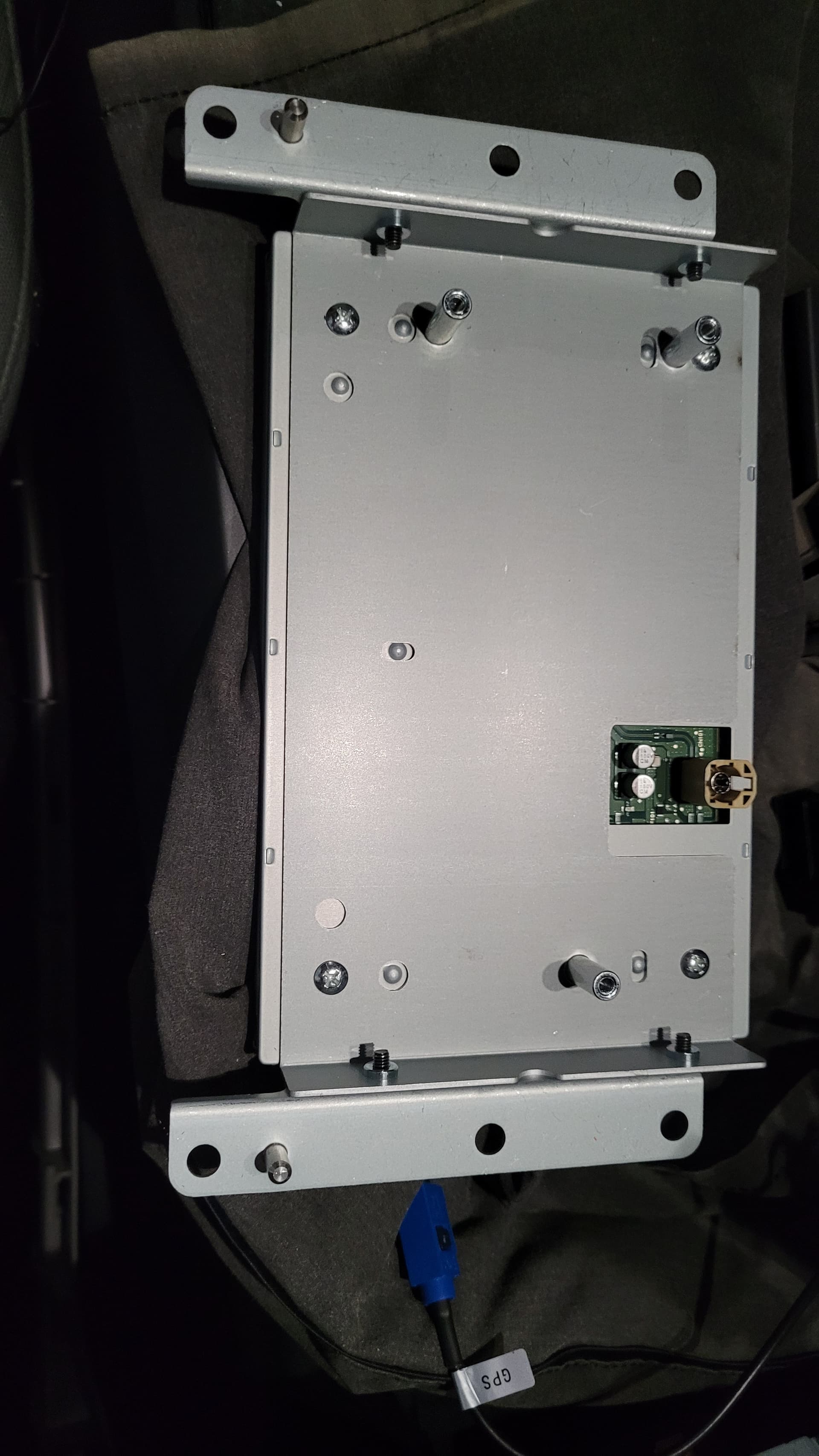

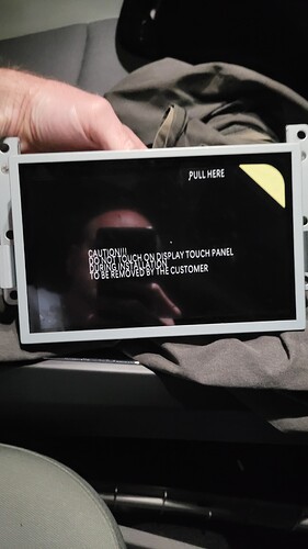

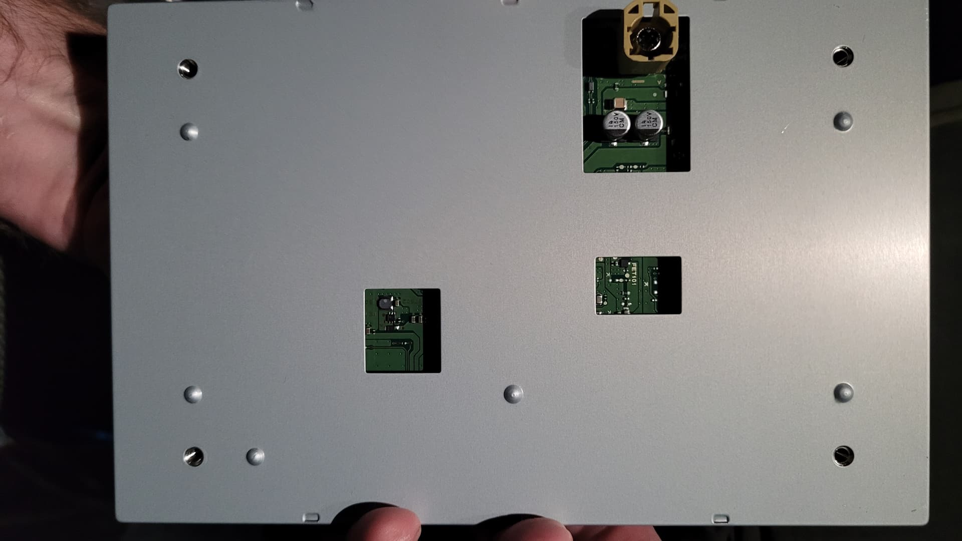

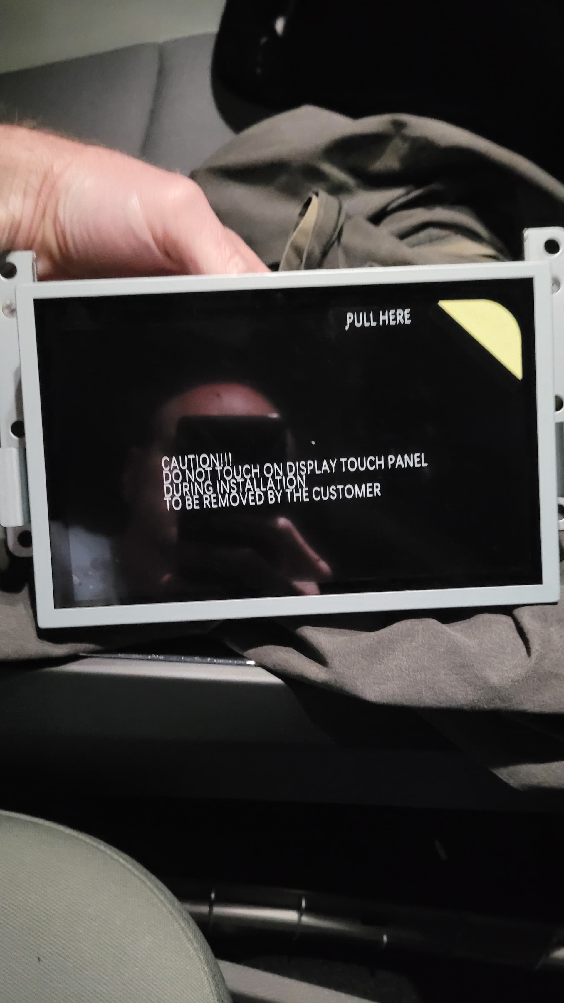

Take a pic of the rear of the screen. It has the right screen protector that I see on Ford units.
Here it is with and without the mounting bracket.
Also does that APIM I found have navigation? I tried to look it up on some lists I found from other sites but the last 3 letters GKG weren’t on any list I found.
Dunno. I’ve seen a few of these but this one has the connector offset from center. Doesn’t mean it’s not one Ford would use. However, it does have the proper connector.
**EDIT: **
That’s a LJ6T-18B995-FC screen, offset connector. This is a Sync 3 MY20 screen.
The LB3T-18B995-AA screen has the connector in the center. This is a Sync 4 screen.
So the screen is legit, but is a Sync 3 screen.
Yes. It cross references to JS7T-14G371-CDC which is 32GB NAV.
