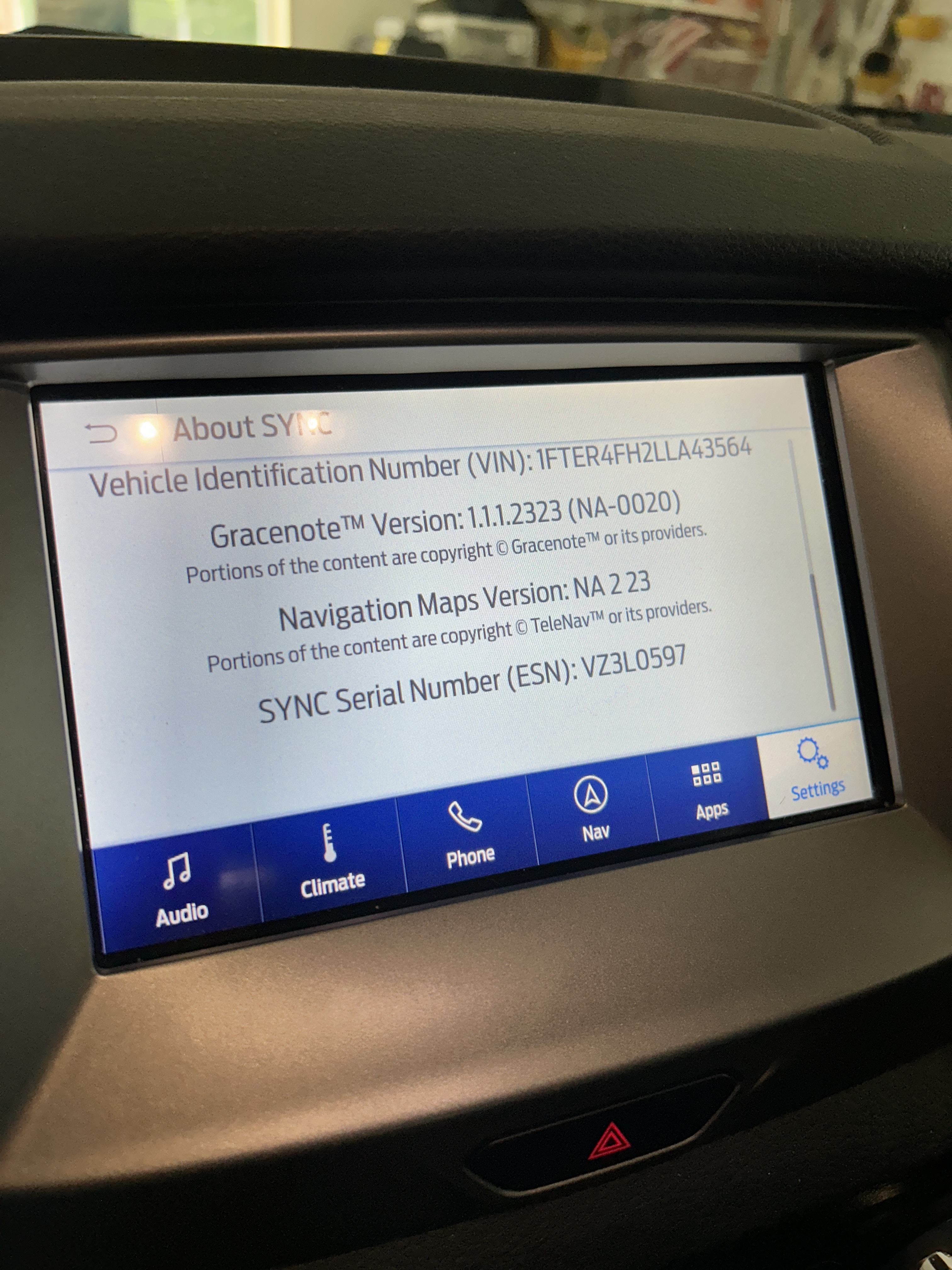

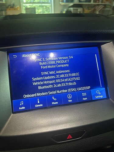

Have a look on the SYNC screen to see what versions of what modules are installed.
This is all I see
