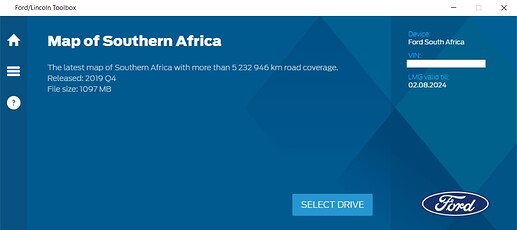

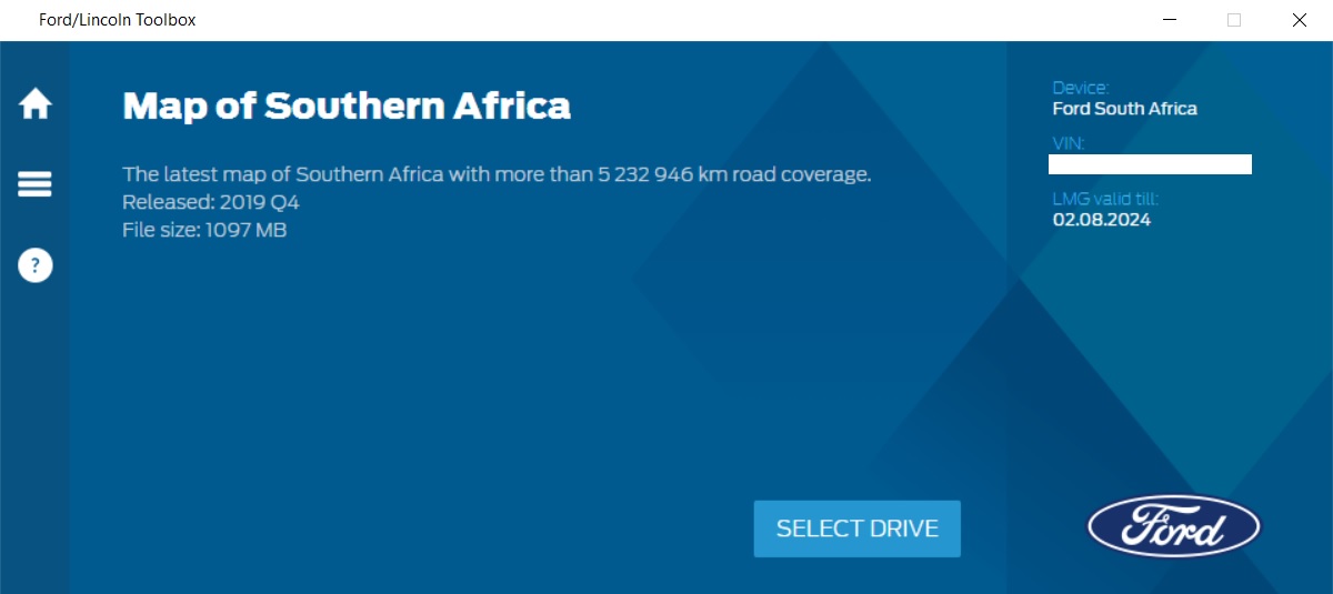

Andre you can download the latest Q4.2019 maps with this app.
https://ford-lincoln.naviextras.com/downloadagent?op=win
or visit the webpage
Register a new account when done installing. Log in. Do your VIN and it should download.
It will request a USB before software download. Once done just insert the USB into the USB port and it should start updating. Remember to run the engine for this process.

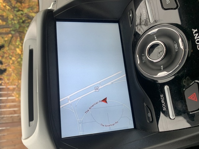

Hi,
I have a Ford Escape 2017 and try updating to 3.4. After the process finishes, the screen is stuck at this picture. I dont know what to do next.
We need more information about what you did.
Is it still there after you shut off the vehicle and turn it back on?
Please post the log.txt files from the usb drive.

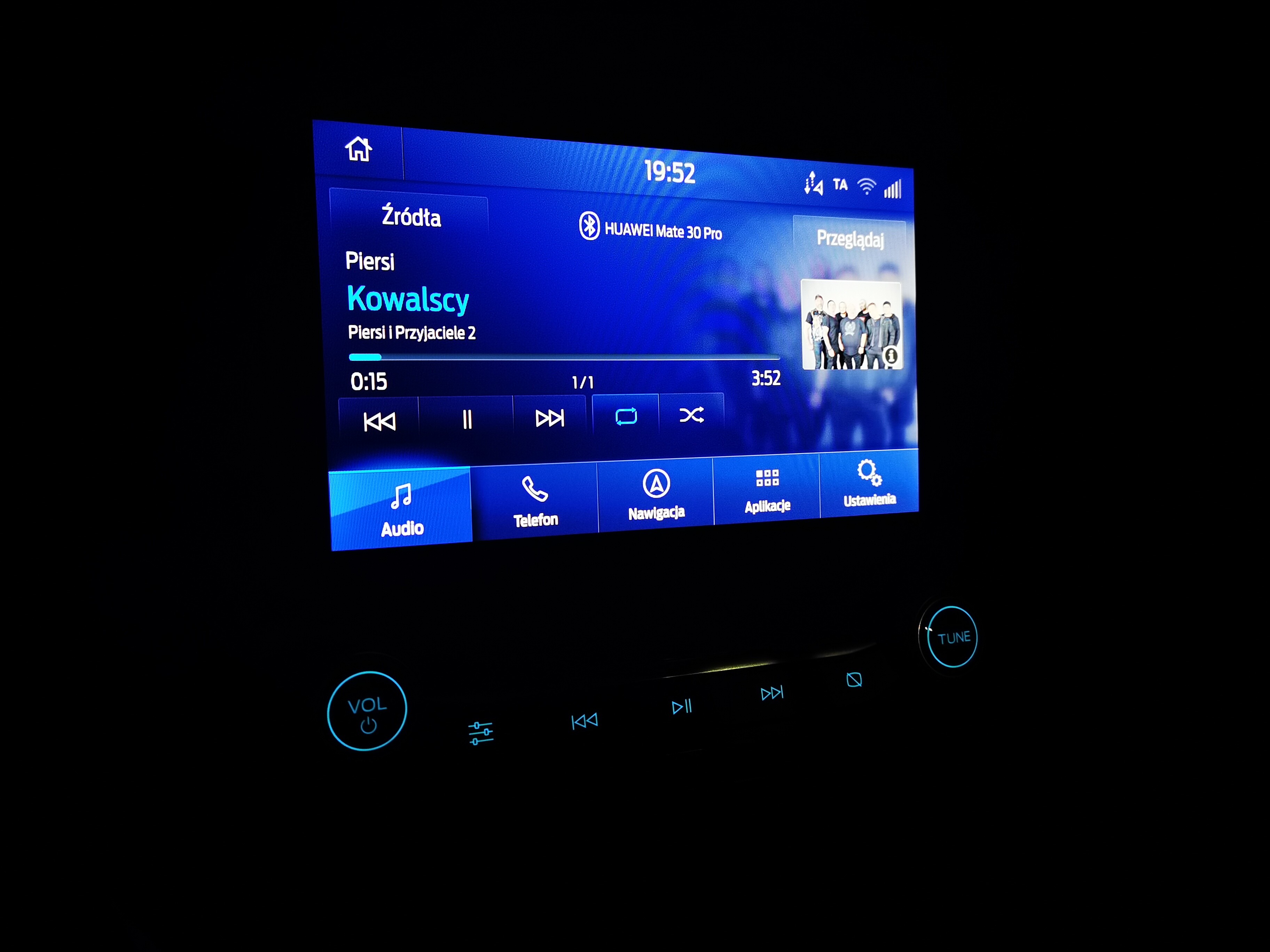

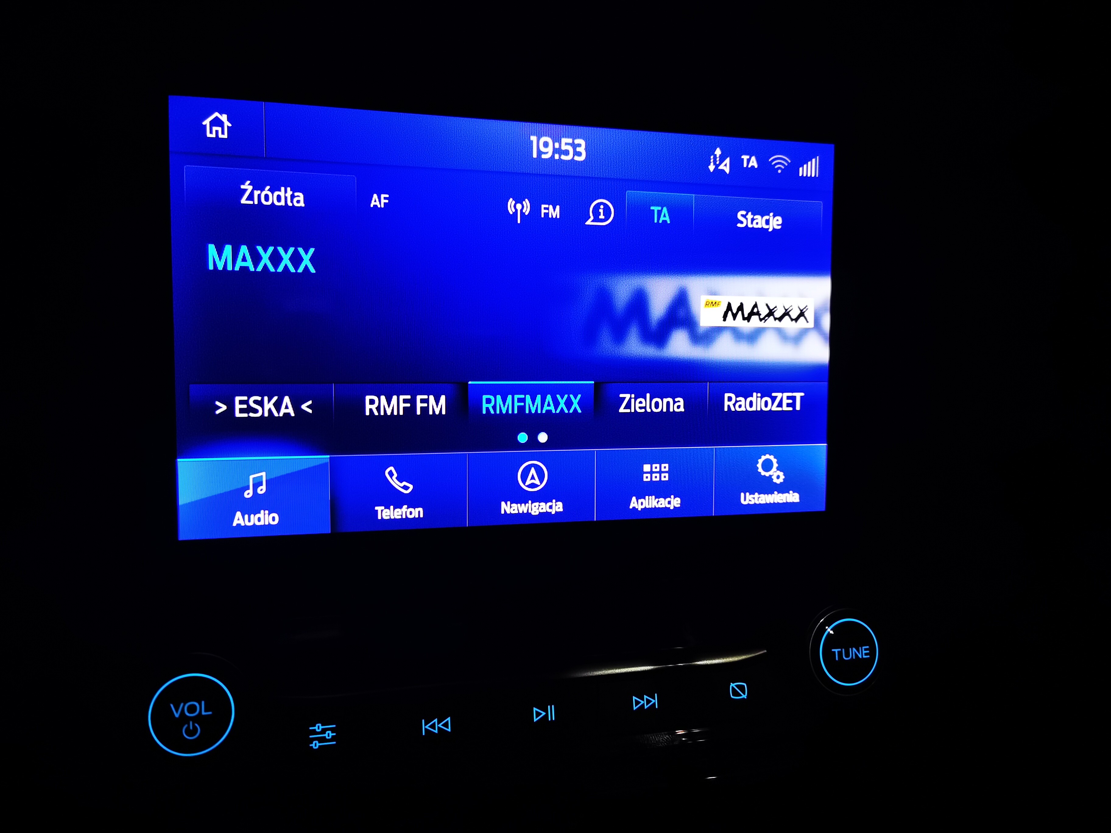

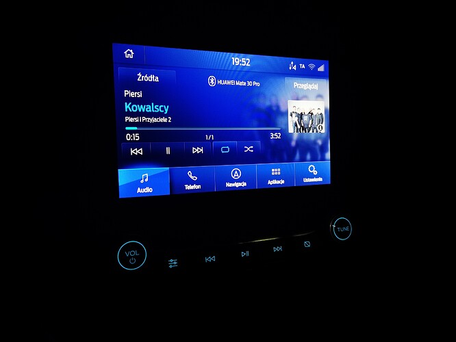

Puma MY20.75 update from 3.4 20134 to 20237 change only template logos and covers music files.
Besides, I don’t know the difference.
Everything works ok. Speed animations is the same.
Maybe someone knows how to speed up the smoothness of the animation on the digital cluster? Thanks for reply.
And template with cover
