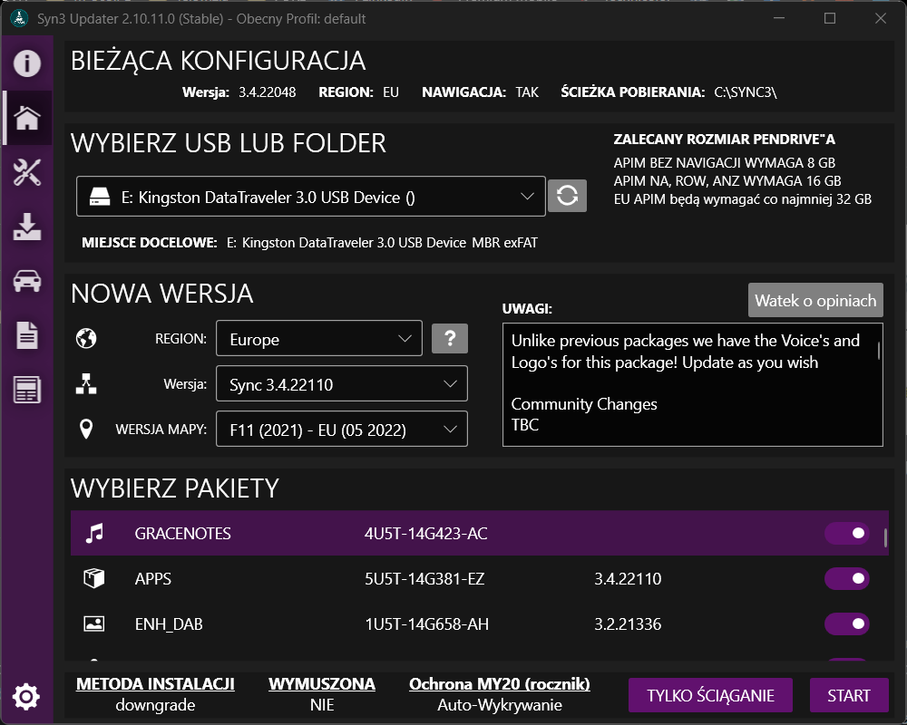

My current version is 3.4.22048. It’s not MY20. Syn3 suggests downgrade installation mode. There should be ā€œreformatā€. Does it need two pendrive for downgrade mode?
Is this a good mode?
No that is correct! reformat tool is blocked on above 3.4.19200 so you have to downgrade first… just let Syn3 Updater do what it needs, people need to stop repeating the same questions over and over.
