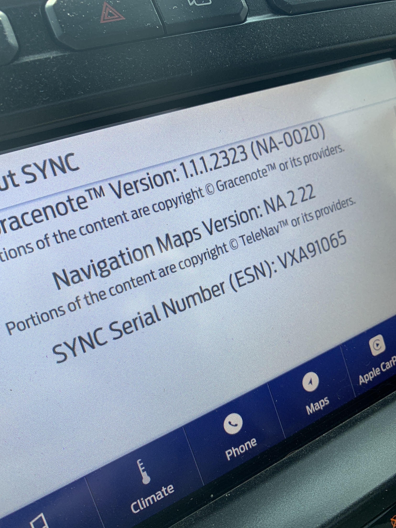

Updating today finally. Will post back with feedback or any issues. Going to master reset before and after the update from 22251 → 23088. ![]()

Ran the update yesterday on the way home from work. Master reset before and after. Took about 35-40 total minutes. 25min for the second phase after downgrade.
No issues. Seems to run a bit snappier too.
