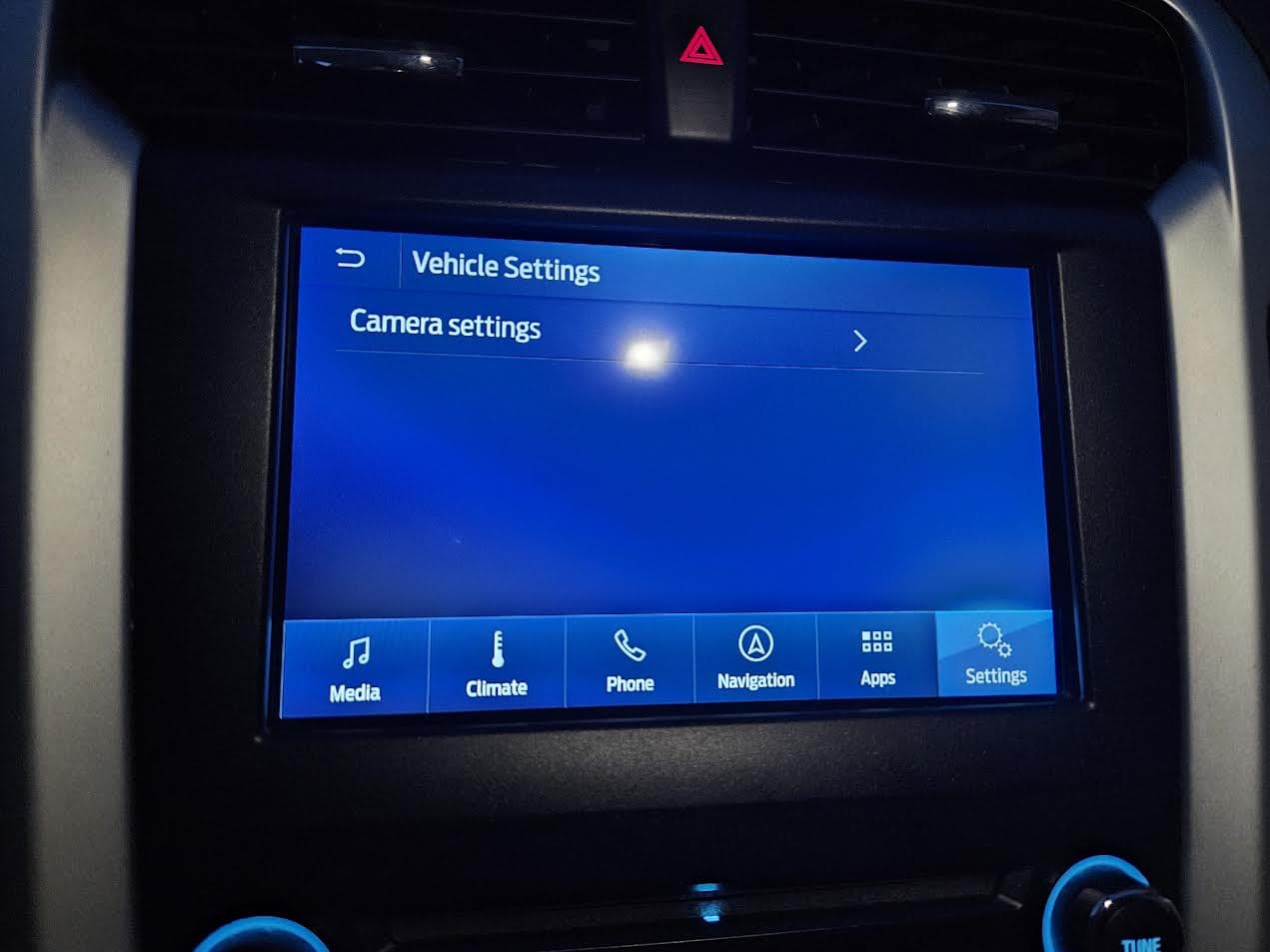

And now this:
I can’t get into this settings anymore…
When put in reverse I do not see parking sensors, only camera… When going slowly forward it shows front parking sensors, but nothing in reverse…
Any ideas?
Is your unit 100% stock?
Or have you performed actions on it? (hw upgrade, modifications, and so).
That’s not an usual issue, that’s why I asking.
Yes 100% stock EU.
I had fmods.net maybe that’s the issue for camera and parking sensors …
But why message to keep USB after installation? ![]()
So not 100% stock…
