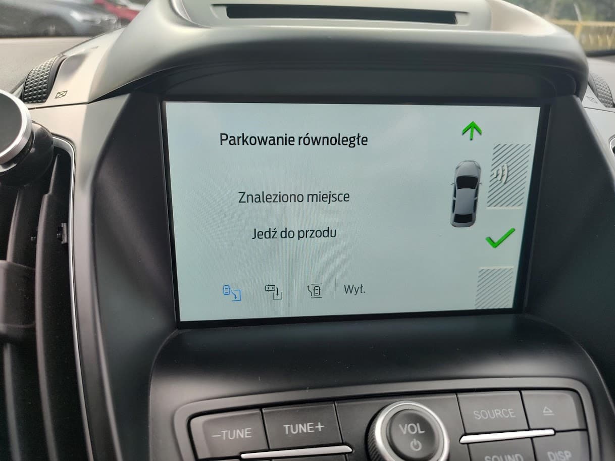

Sync 3.4 no visual indications from the active parking assistant. C-Max
Well, I got serious and found the solution myself.
The fault was a messed-up as-built APIM. I studied all the dependencies in the cells, and they didn’t match my equipment version. So I flashed the stock as-built dealer version.
Everything works!
And one more thing. All DTC errors are gone.
