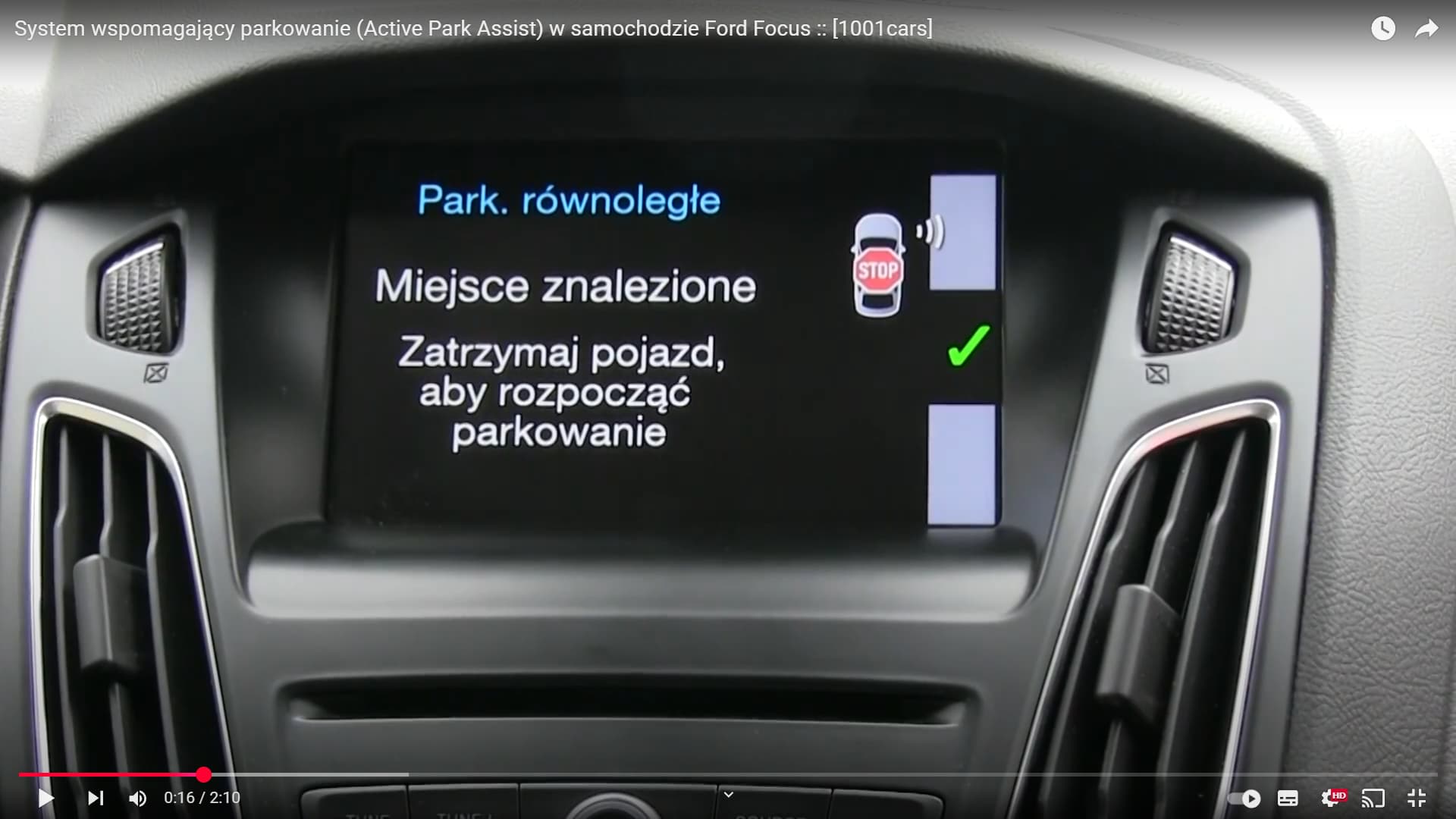

The Parking Assistant itself works, the car can enter and exit the parking space by itself. However, I do not have any indications on the display. Only the current screen is displayed, e.g. Home, radio, etc. Plus displaying obstacles when approaching them (360 12-sensors).

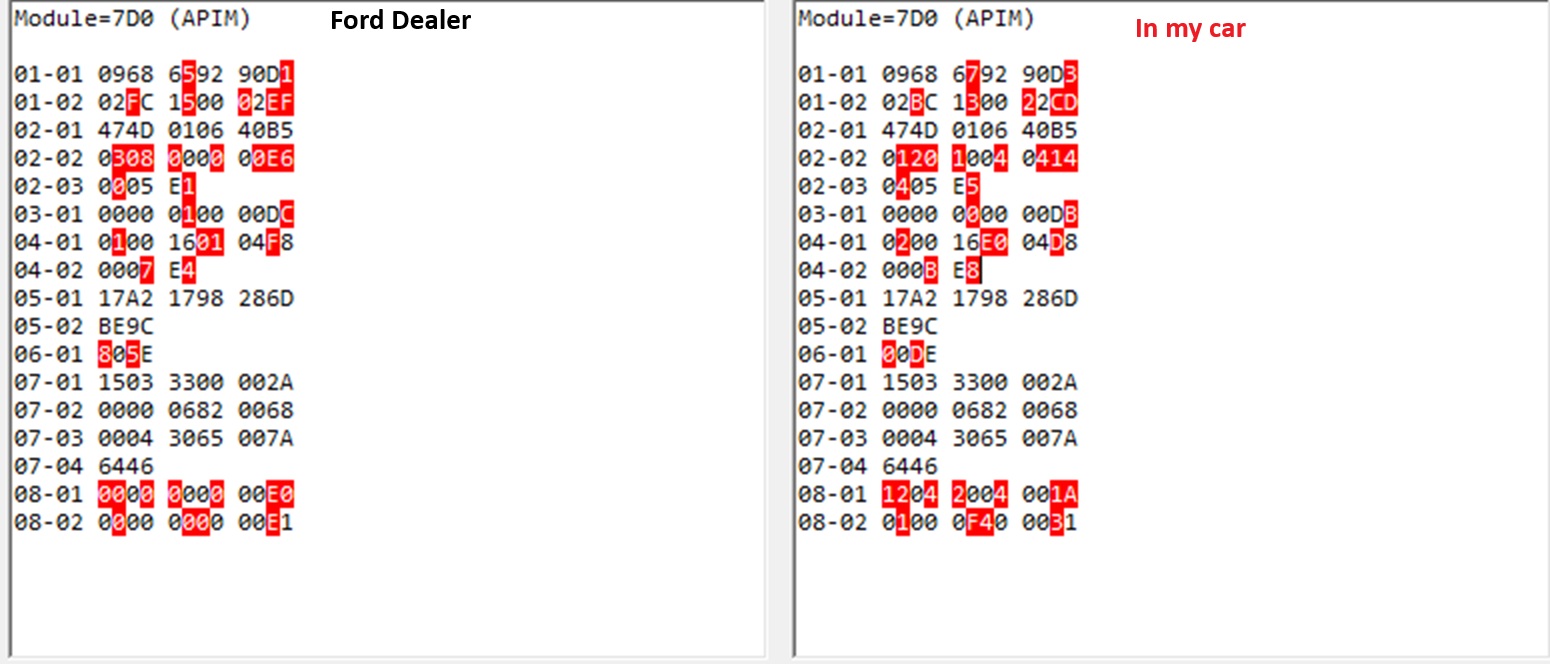

I searched for a long time and figured out what was wrong. Unfortunately, I do not have contact with the previous owner. I managed to determine myself that Sync 3.4.23188 was installed on the original version 3.0.19205.
I do not know what method was used to update.
Apart from this problem, everything works perfectly, even the radio station logos. Master reset did not help, I do not know where to look for the problem. This is my first Ford :smiley: Searching led me to your forum.
My stock AsBuilt (Ford dealer)

 	7D0-01-01 	0968 	6592 	90D1
 	7D0-01-02 	02FC 	1500 	02EF
 	7D0-02-01 	474D 	0106 	40B5
 	7D0-02-02 	0308 	0000 	00E6
 	7D0-02-03 	0005 	E1
 	7D0-03-01 	0000 	0100 	00DC
 	7D0-04-01 	0100 	1601 	04F8
 	7D0-04-02 	0007 	E4
 	7D0-05-01 	17A2 	1798 	286D
 	7D0-05-02 	BE9C
 	7D0-06-01 	805E
 	7D0-07-01 	1503 	3300 	002A
 	7D0-07-02 	0000 	0682 	0068
 	7D0-07-03 	0004 	3065 	007A
 	7D0-07-04 	6446
 	7D0-08-01 	0000 	0000 	00E0
 	7D0-08-02 	0000 	0000 	00E1

So look at this screenshot of a video on park assist. The Sync screen has switched to the rear camera view during the manuveur. You say you are missing this video and the screen does not switch?

Displaying information during active parking does not work. That is, the vehicle enters or exits the parking space by itself, Rear/Front PDC with APA (12 Sensors) function (APA + SAAP + PPA + POA). This function works even now but I do not have any information about finding a parking space and instructions for changing gears (forward / backward)
I miss screens like the ones in this picture
In newer versions this screen looks like this.

The architectures seem to be set correctly in my car.
I read my AsBuilt.It’s a bit messed up there and what I have in my vehicle is not consistent with what I have from the Ford dealer. A lot of incompatibilities concern, among others, air conditioning, Cross Traffic, etc. But it works well.
This is what it looks like.
I also have errors in APIM. Some talk about sensors on the side – although they work and warnings are shown on the screen. There is also a bug about the wrong configuration.
Here is the log.

The first thing that came to my mind was to upload AsBuilt from a Ford dealership, but since some things work, I abandoned it so as not to break something. Ps. I only have differences in AsBuilt in the APIM module.
One option that caught my attention the most was the line:
7D0-04-02: xx**-xx
For me it is set to 000B E8 -ā€žFAPA (12 Sensors) (APA + SAAP + PPA + POA)ā€
The original should be 0007 E4 -ā€žRear/Front PDC with APA (12 Sensors) (APA + SAAP + PPA + POA)ā€
I don’t know what to do. Should you first change this parameter in 7D0-04-02: xx**-xx ? Is there anything else I should pay attention to?
And one more thing. Parking sensors do not make a sound when approaching obstacles. The screen correctly displays the green, orange and red zones. When approaching obstacles, it is quiet, when I approach the red zone, only with a delay does the squeaking sound begin. But when I shift the car from gear to neutral, the sounds work well in zones other than red. My wife walked around the car and I checked😊
Well, I got serious and found the solution myself.
The fault was a messed-up as-built APIM. I studied all the dependencies in the cells, and they didn’t match my equipment version. So I flashed the stock as-built dealer version.
Everything works!
And one more thing. All DTC errors are gone.
The only remaining problem is the parking sensor sounds. I’ll check that tomorrow. The cells in 7D0-08-01: xxxx-xx**-xxxx are probably responsible. In the Cyanelabs database, the description mentions other functions, but a small program called ā€œFord APIM Sync 3/4 As-Built decoder toolā€ explains that the settings include ā€œFront/Rear Park Aid Adjustable Chimes.ā€
