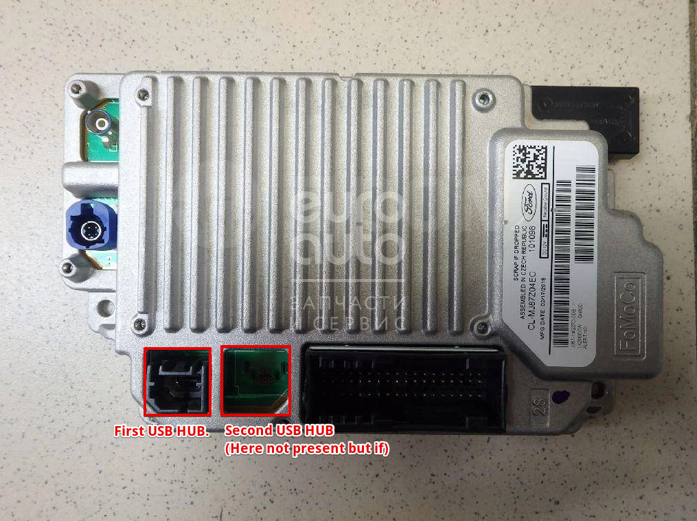

MY MOST IMPORTANT QUESTION: can I connect multiple hubs to the versions with two USB connectors on the APIM, or are they just two outputs to one hub?

You only have one port on the APIM to use, hence the reason the 2nd was deleted on later models of the APIM.
I have been able to get 3 working ports with the combination of HS7Z19A387R & HC3Z19A387F by going from the APIM to the single port module and then using the port on the module which is intended for a USB extension cable as an uplink to the 2 port module (you have to provide power in addition to the USB).
So i can use then two usb drives and one Android Auto?
I use that specific combination with 1 AA and 2 USB flash drives.

You can enable the second port on the older APIM’s but you still only have 1 amp of power available. It’s not in the asbuilt, but a hardware feature of the older APIM’s.
